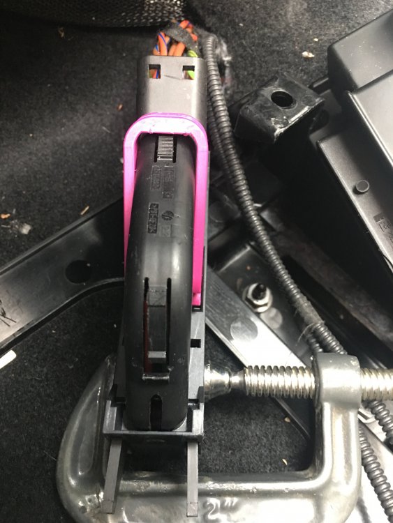

I have an issue with the Canton system on my 2016 L&K Superb. The drivers side bass speaker is distorted. Thinking it was the speaker, I removed the door card and substituted for a new one, but the problem persisted. A search on the forum showed this to be a common problem, normally sorted by doing a reset, but this hasn’t cured mine! So, suspecting  the amp, I took the cover of, but no matter what I tried, I could not release the main plug. It appears to have a handle to ratchet the connector in, but I can’t figure out how to release it. Here is a photo of it.
I would appreciate any help given.
Thanks in advance.
Mick.
You should try to rotate the pink plug. Rotating it acts like a lever - and moves the whole plug out of the amp.
Hi Simichoil
I’ve tried rotating it, but it’s either very tight or it has a locking device I can’t see. I don’t want to force it and risk breaking it.☹️
Mick.
Sorted👍
On the back of the plug there is a lock that has to be held in while the handle is rotated. Small screwdriver worked for me. Haven't been able to fix the distortion problem though☹️
Mick
