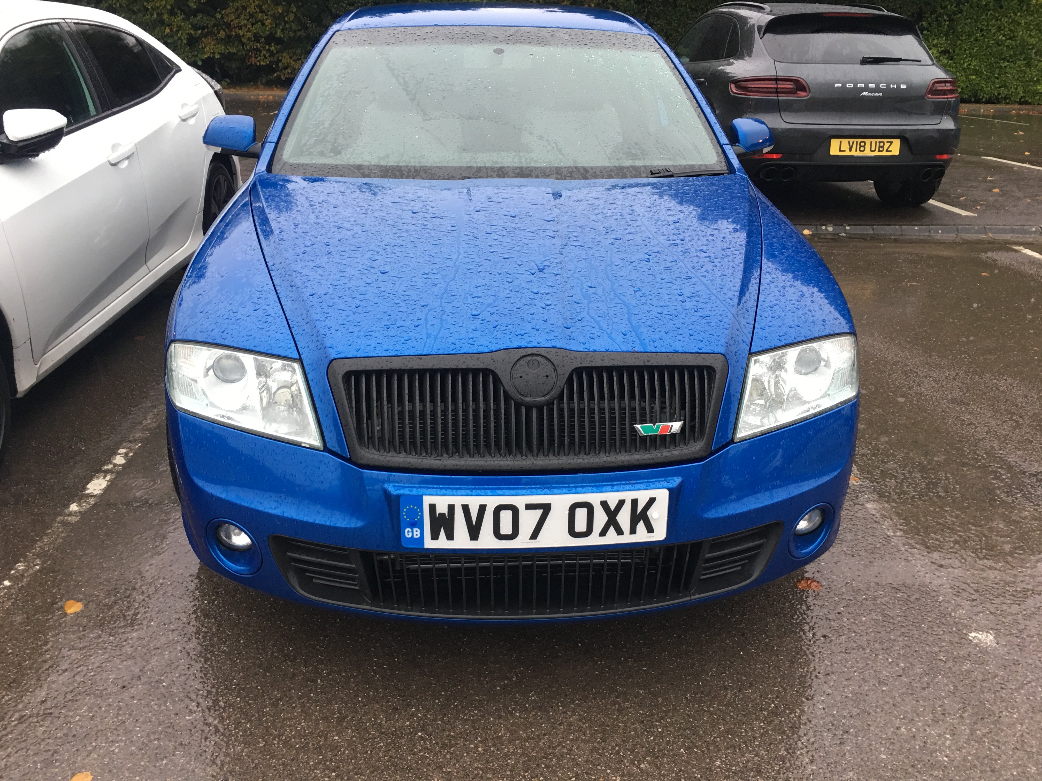

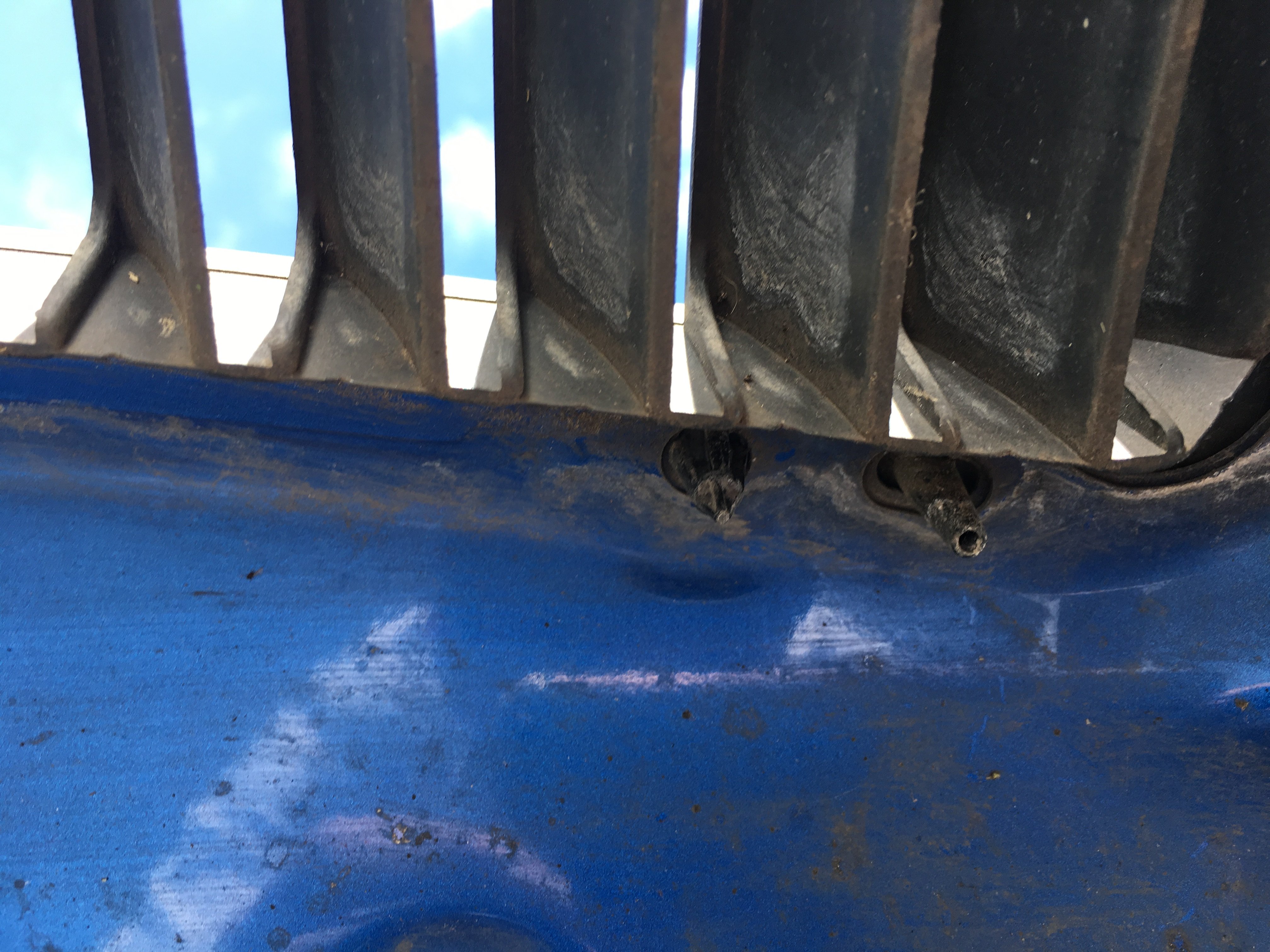

If I don’t sell my Octavia VRS I’m looking to change the colour of my grill from the standard chrome to black.
I’ve bought a can of Plastidip, watched the YouTube video and thought it would be easier to remove the grill.
is there a knack to it’s removal?

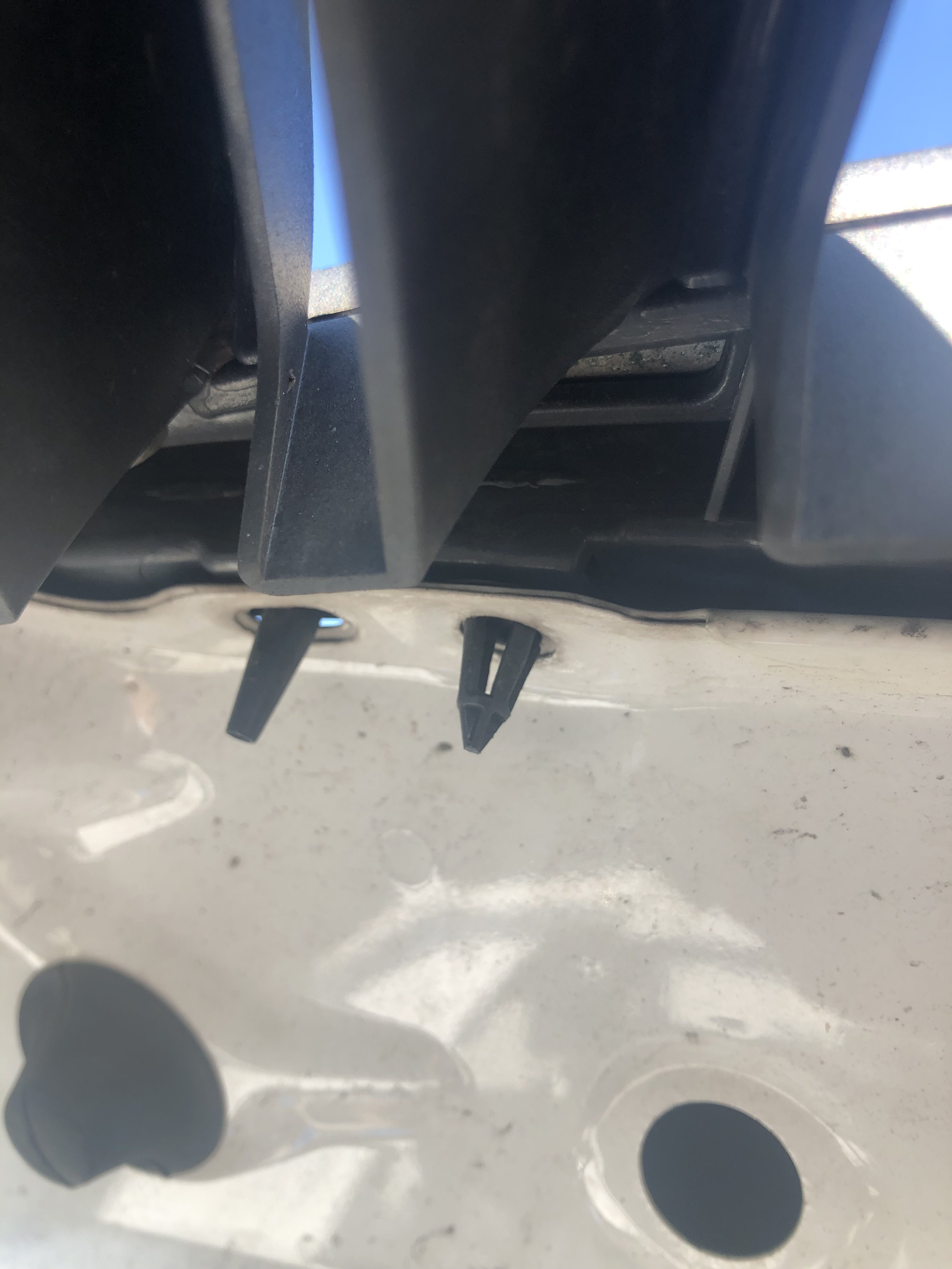

Photo attached of current fixings...
Any help greatly appreciated as personally I think a black grill changes the whole appearance of the car.
its my first try with a Plastidip and happy to post before and after photos... if it doesn’t look great just peel it off...😂

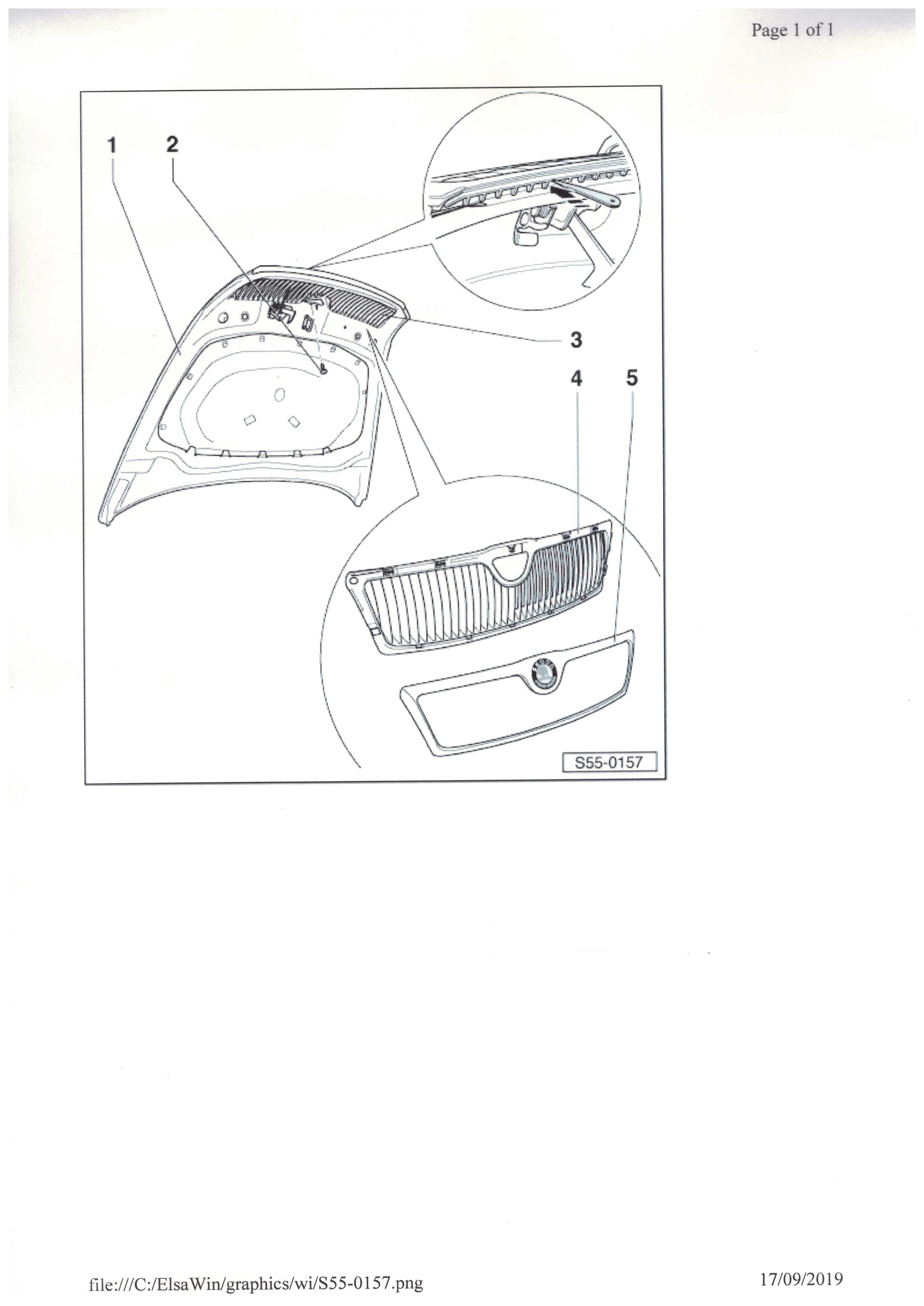

Summary of components of radiator grill
1 -Engine bonnet
2 -1.5 Nm
3 -Radiator grill
Removing:
–Remove screw (Pos. 2).
–Unclip the top part of the radiator grill.
–Fold away the top part of the radiator grill and through this slacken the supports on the left and right below.
–Shut the top part of the radiator grill and slacken the middle support of the radiator grill using e.g. disassembly wedge -3409- in -direction of arrow-.
–Remove the radiator grill from the engine bonnet (Pos. 1).
–Disassemble the radiator grill in individual parts (Pos. 4 and Pos. 5).
Installing:
–Installation is carried out in the reverse order.
–After installation the radiator grill must be flush with the engine bonnet.
4 -Grill
5 -Trim strip

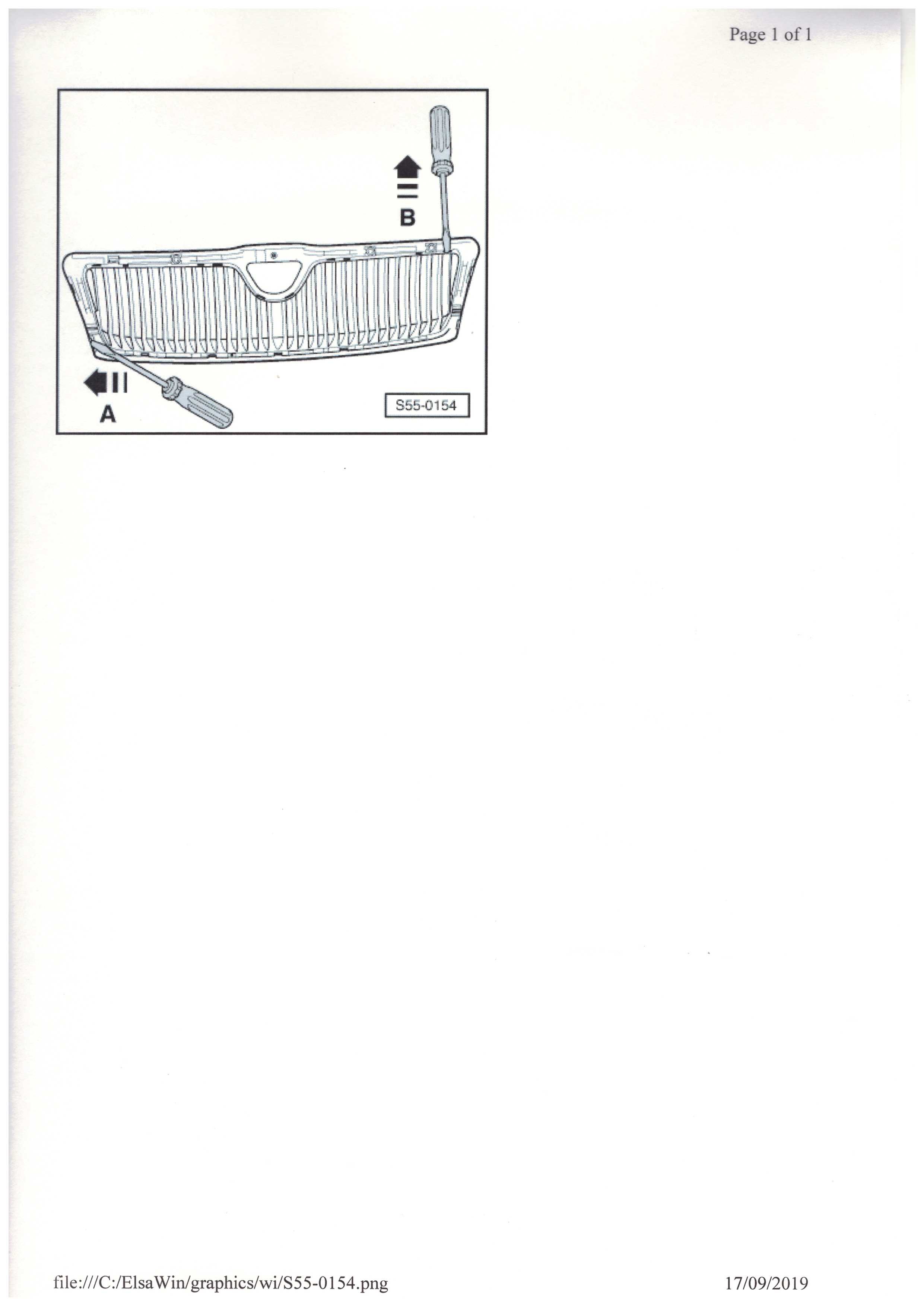

Disassembling and assembling radiator grill
Removing:
lRadiator grill removed from vehicle
–Release the side clips of the decorative strip using a screwdriver in -direction of arrow A-.
–Release upper and lower clips of the decorative strip with a screw driver in -direction of arrow B- and remove decorative strip.
Installing:
–The installation is carried out in the reverse order, while paying attention to the following.
Note
Clip individual parts of the radiator grille into one another.

After removing the screws I had problems removing the plastic clips.
 I used a 6mm socket and placed it over the plastic and pushed causing them to pop out.
Hope thats helps. Took me about 5 mins

i tried briefly last night to remove it but it wasn’t keen to budge... contemplating buying one on eBay and Plastidip that one...🙄

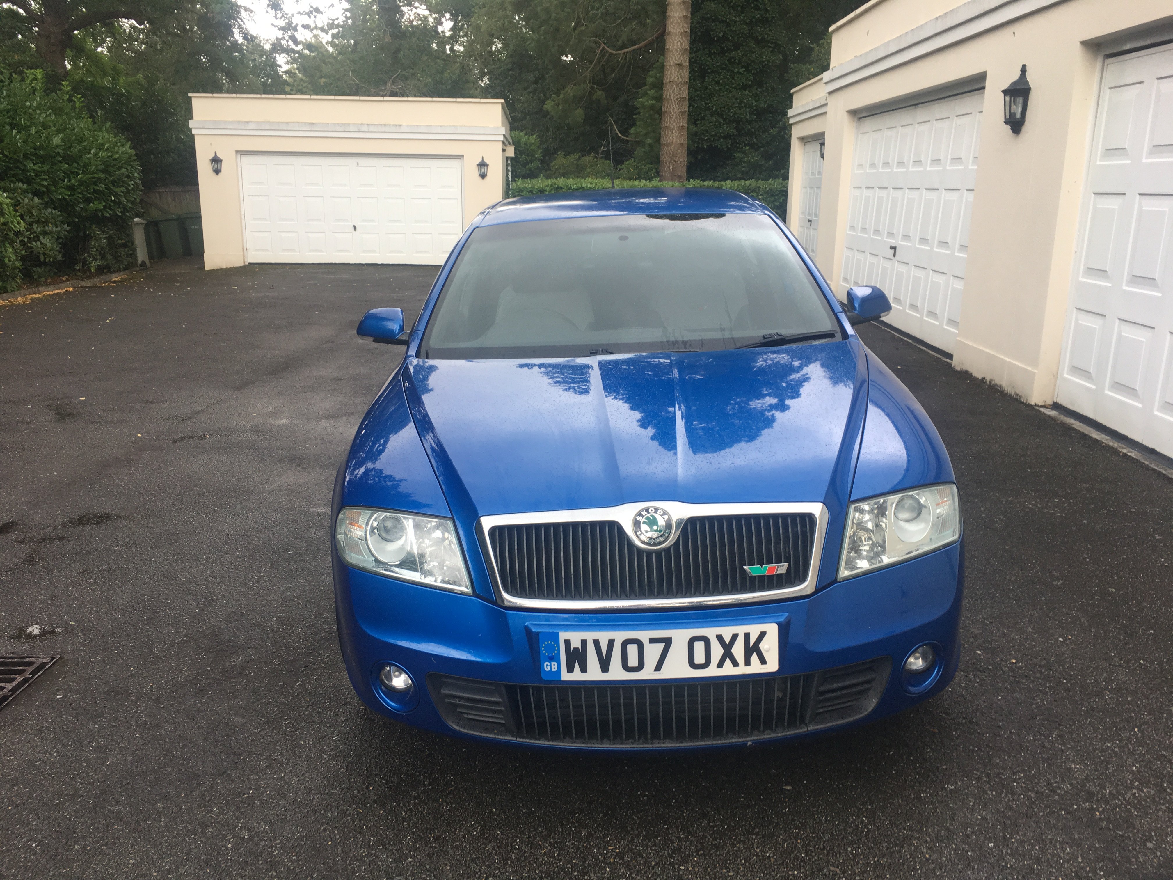

I bet it would look great black chromed. Wonder how much that would be. Still a decent spray job then a few coats of lacquer would be pretty close.
Just another observation from your pic, do you need an extra garage or two?
An extra couple of garages or individuals would be great...
Thanks
The clips I used a 6mm socket set and placed it over the clip as you see it. This helps pushing them through

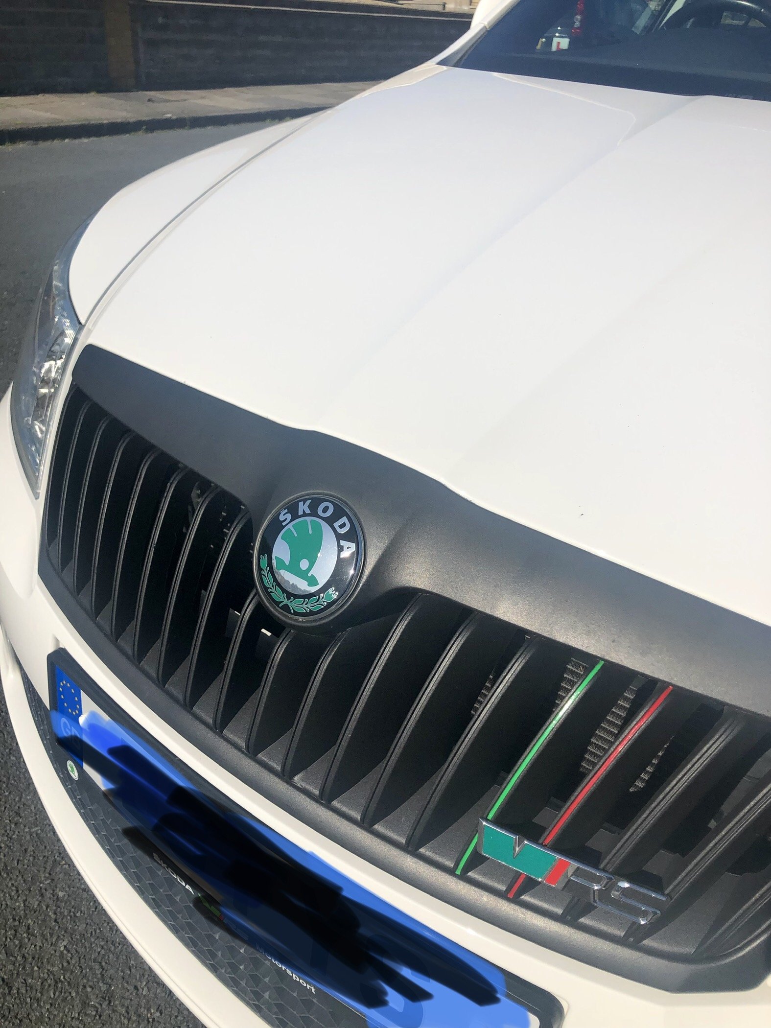

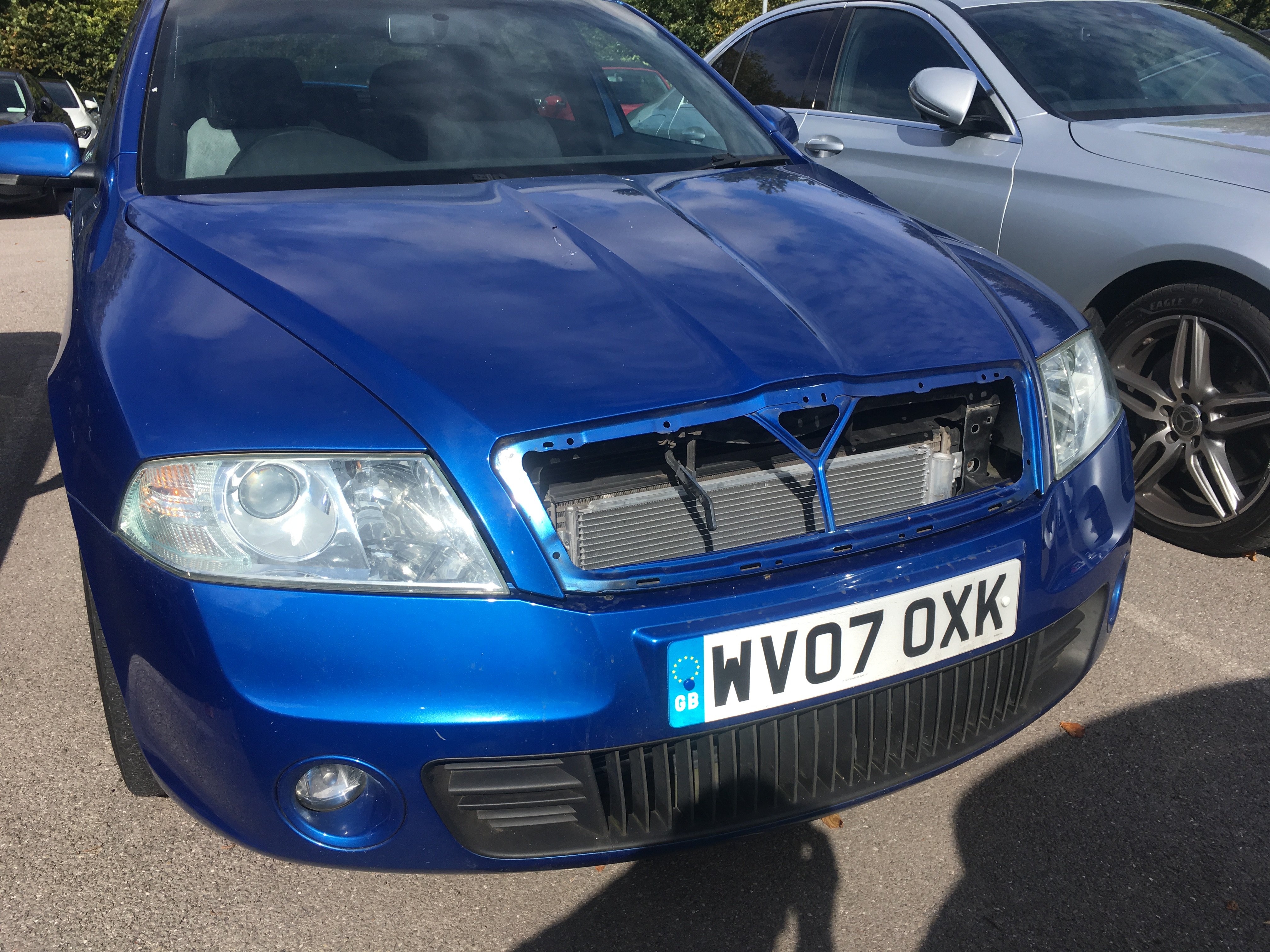

Grill removed and Plastidipped over the weekend, photos to follow once refitted, hopefully tonight...
Can’t say I like the current look😳 although it does show off my new compressor...😂

Grill refitted last night...
Happy with the results...🤓
£10.40 for the can of Plastidip...

That looks superb - I think a coloured badge would look good or the new style one. Net job is fogs as DRL's
Thanks, your photo convinced me to try it...
Best thing is that you can just rip it off if you don’t like it...🤓

Glad it’s done and you’re happy with it. Just looks so much better.
Sorry mate, it was your photo that inspired me...😉
