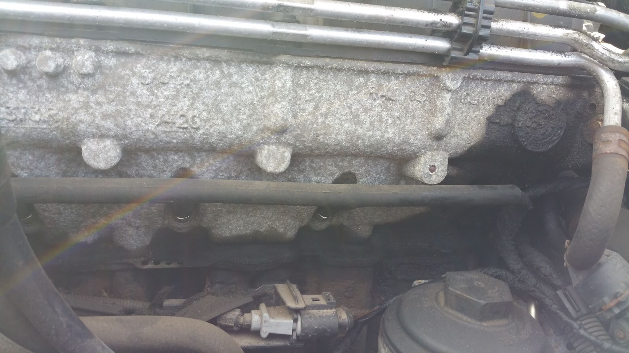

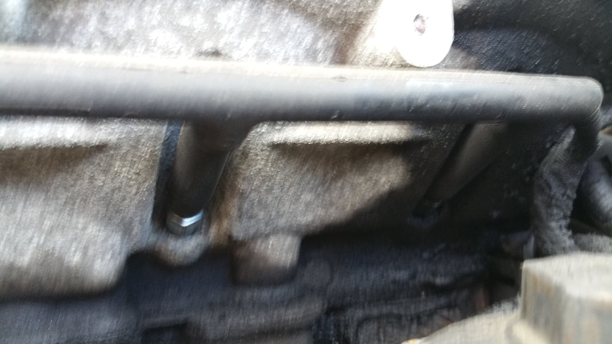

can anyone help please as I'm trying to work out why there is black carbon build up which really seems to be coming out from where number 4 glow plug is but I cant feel anything coming out when i put my fingers in there.
if you know anyone who knows about injectors seals or why it may be black there could you Tag them for me please as really am stuck here 😞

It's hard to tell from the pic but that looks perhaps like a slow oil leak coming from somewhere. Is it definitely not coming out from round the glow plug? If the glow plug was loose you could possibly get combustion gasses escaping past it.
You won't see anything of the injectors on a PD engine without taking the cam cover off, so whatever that black gunge is it's very likely nothing to do with the injectors or injector seals.

think i might clean that oil area and see if i can see where it starts coming from
That leak that has made its way round the corner of the engine is probably the seal on the tandem pump or the cam cover gasket, its nothing to worry about and would ignore it and let it be.
dont think its the cam cover gasket due to where the oil is but as i having the injector seals done I will but a new one just to be safe.
it looks like its squirting slowly from somewhere opposite the glow plugs, I cant feel no blowing when i put my hand down there,
now some of you have seen it and given some advice i,m starting to think the same, whats a tandem pump? does that have a gasket?
think i,m going to go out there today with some warm soapy hot water and clean off the oil off to see if i can see where its coming from, it looks like a build up over time to me what do you think?
