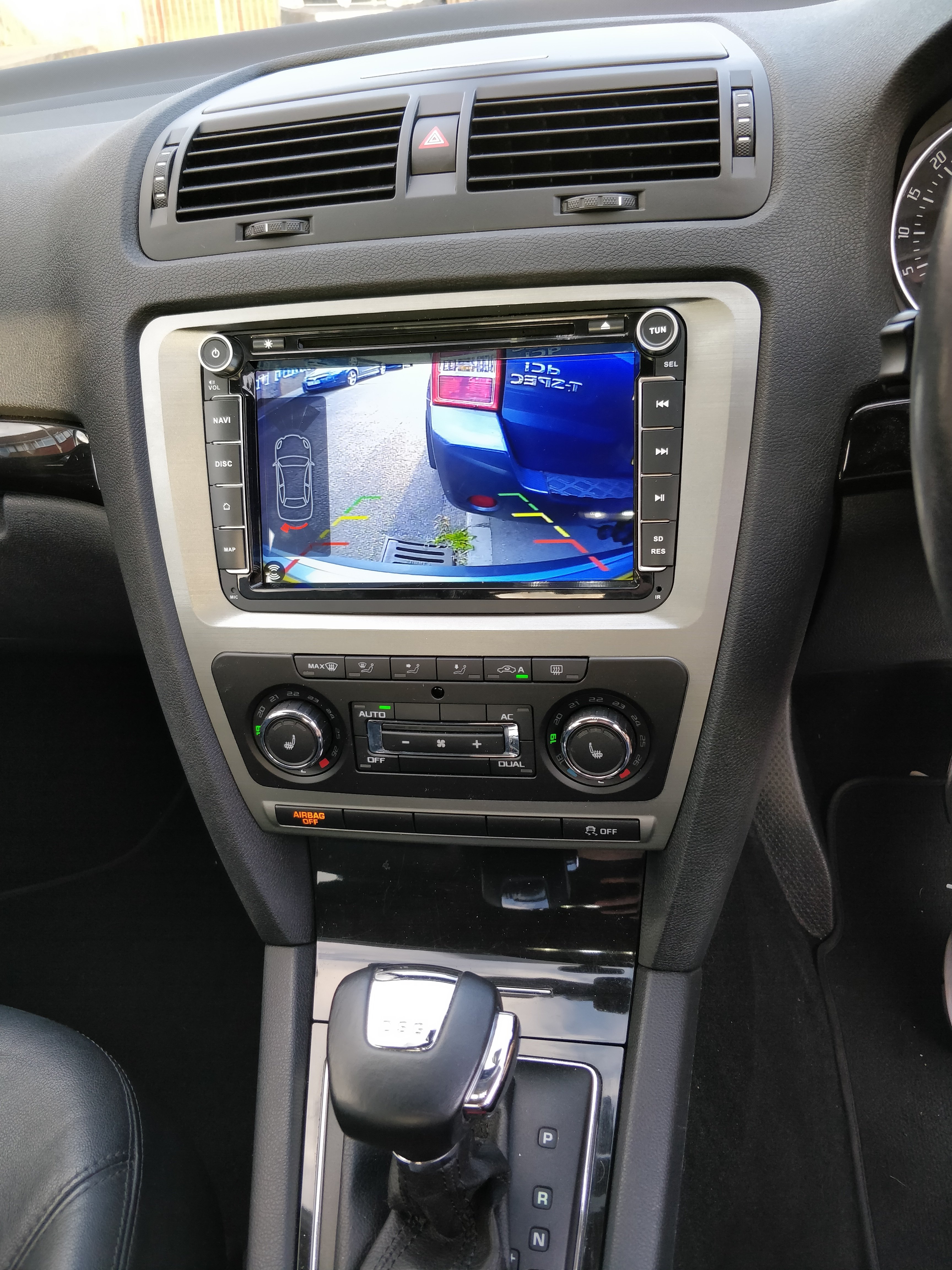

I used a boot switch with integrated camera: https://www.amazon.co.uk/Reversing-Integrated-2010-2014-Rectangular-interface-LS8012-Connector/dp/B07MYR8KBJ/ref=mp_s_a_1_11?keywords=octavia%2Breverse%2Bcamera&qid=1565520428&quartzVehicle=106-1344&replacementKeywords=reverse%2Bcamera&s=gateway&sprefix=octavia%2Bre&sr=8-11&th=1&psc=1
I chose that one as it said it was 720p and had a switch to turn the guide lines on and off.
I removed the lower and upper hatch trim (a few screws and sharp tugs get them off) to fit the camera, the actual running of the wire is a bit involved.
I had to remove the passenger boot trim, the seat side cushion, the lower c pillar trim, the b pillar trim, and the lower a pillar trim. Then with the aid of a straightened out wire coathanger you can run the cable up the inside of the hatch, through the rubber boot, done into the boot, then forwards into the cabin, along the passenger side all the way to the radio.
I used the "reverse" power feed for the camera, and it worked beautifully with no interference lines or anything. I didn't even need to connect the dedicated earth, it just worked which I was surprised about but I wasn't about to fiddle with it while it was working so I just put it all back together and went on my merry way!
Here's a photo of the end result.
