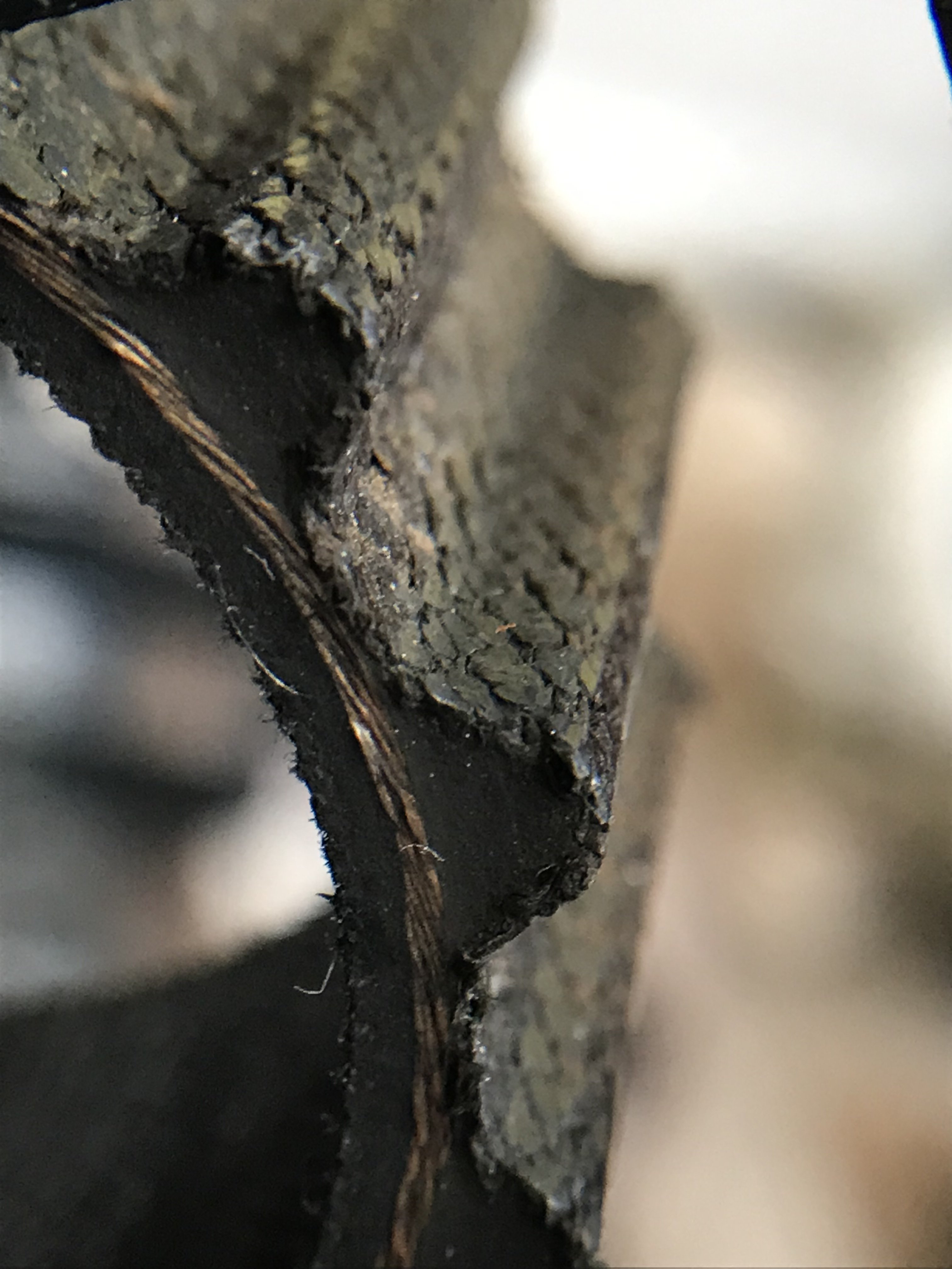

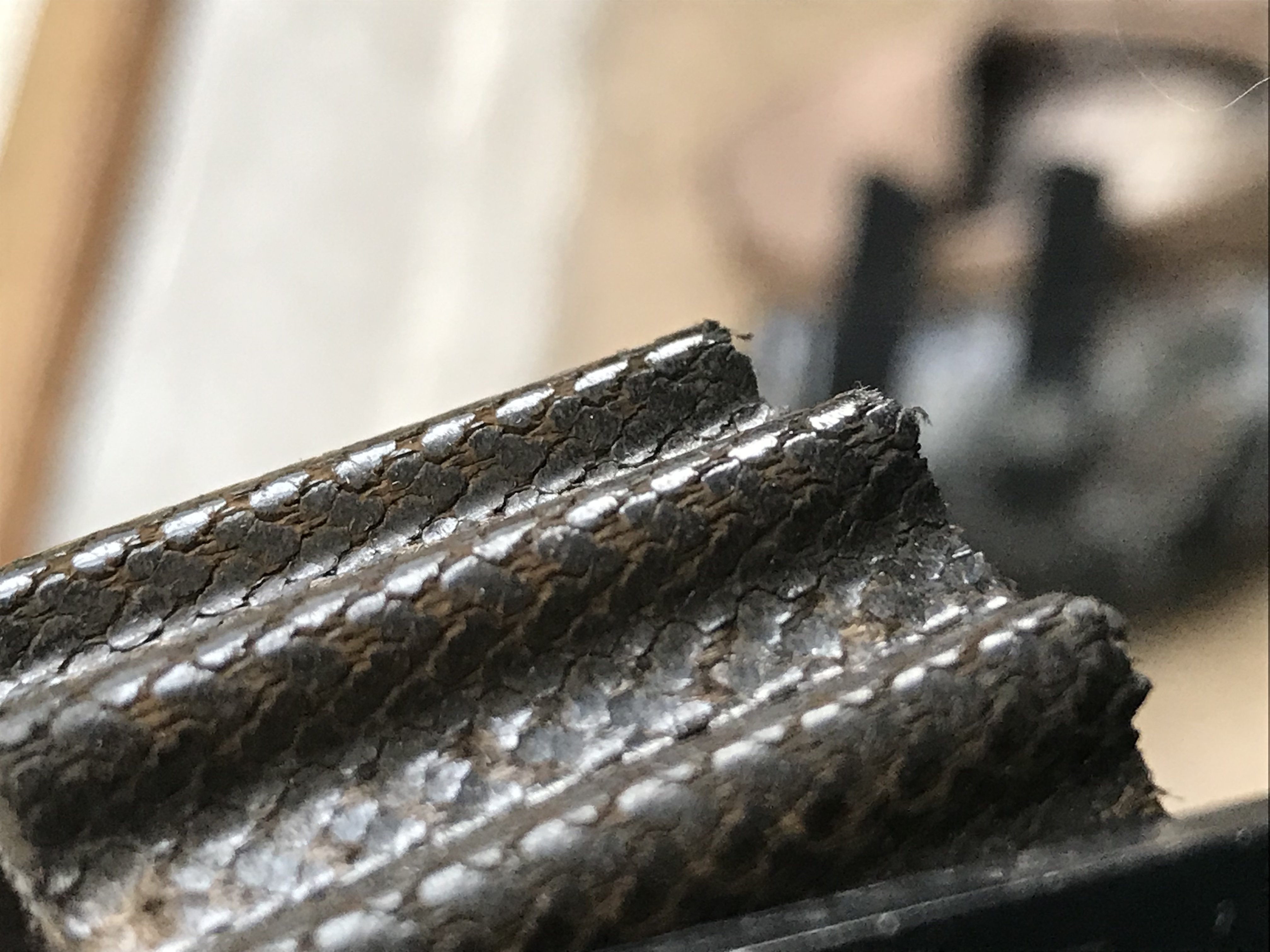

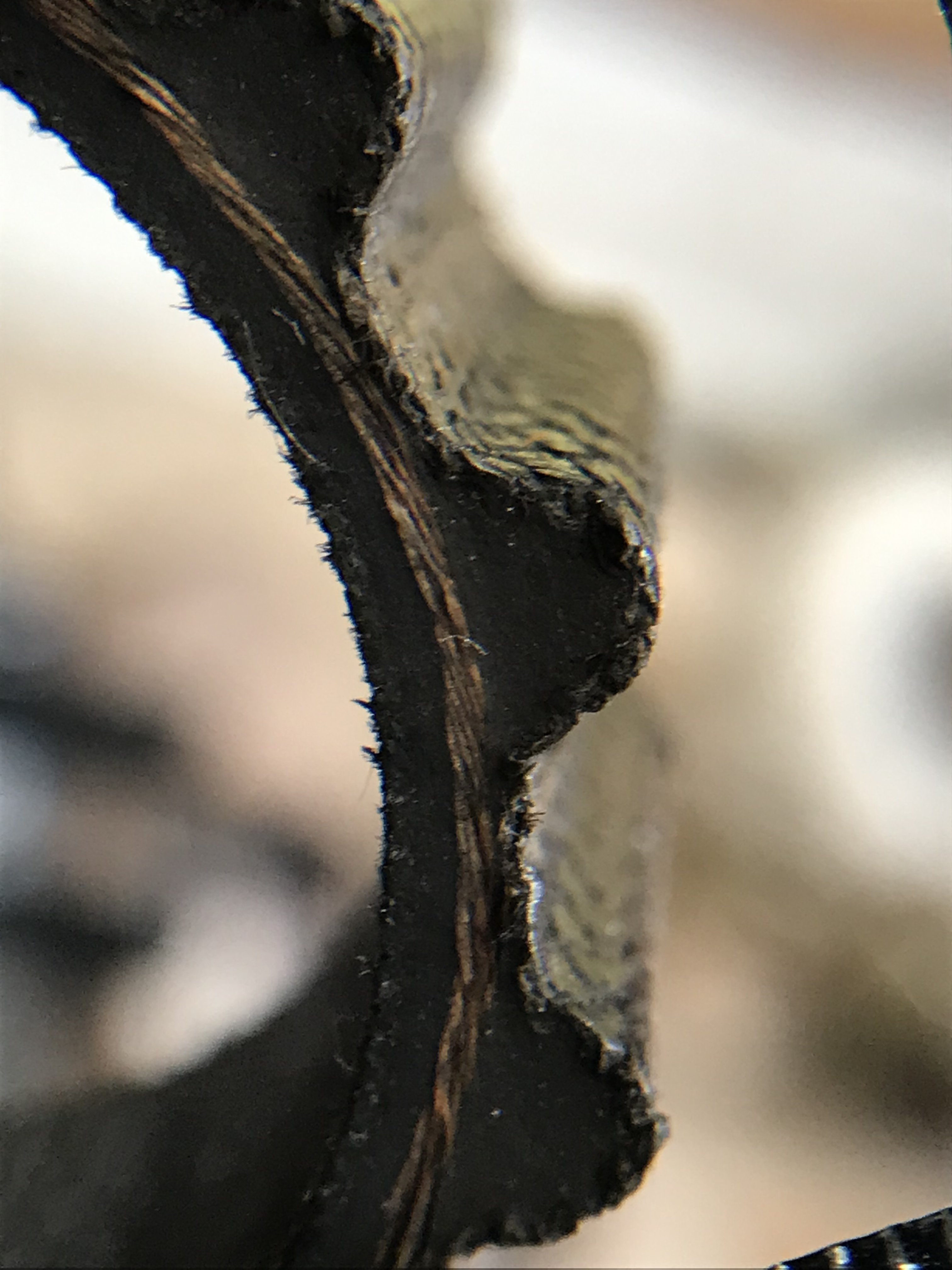

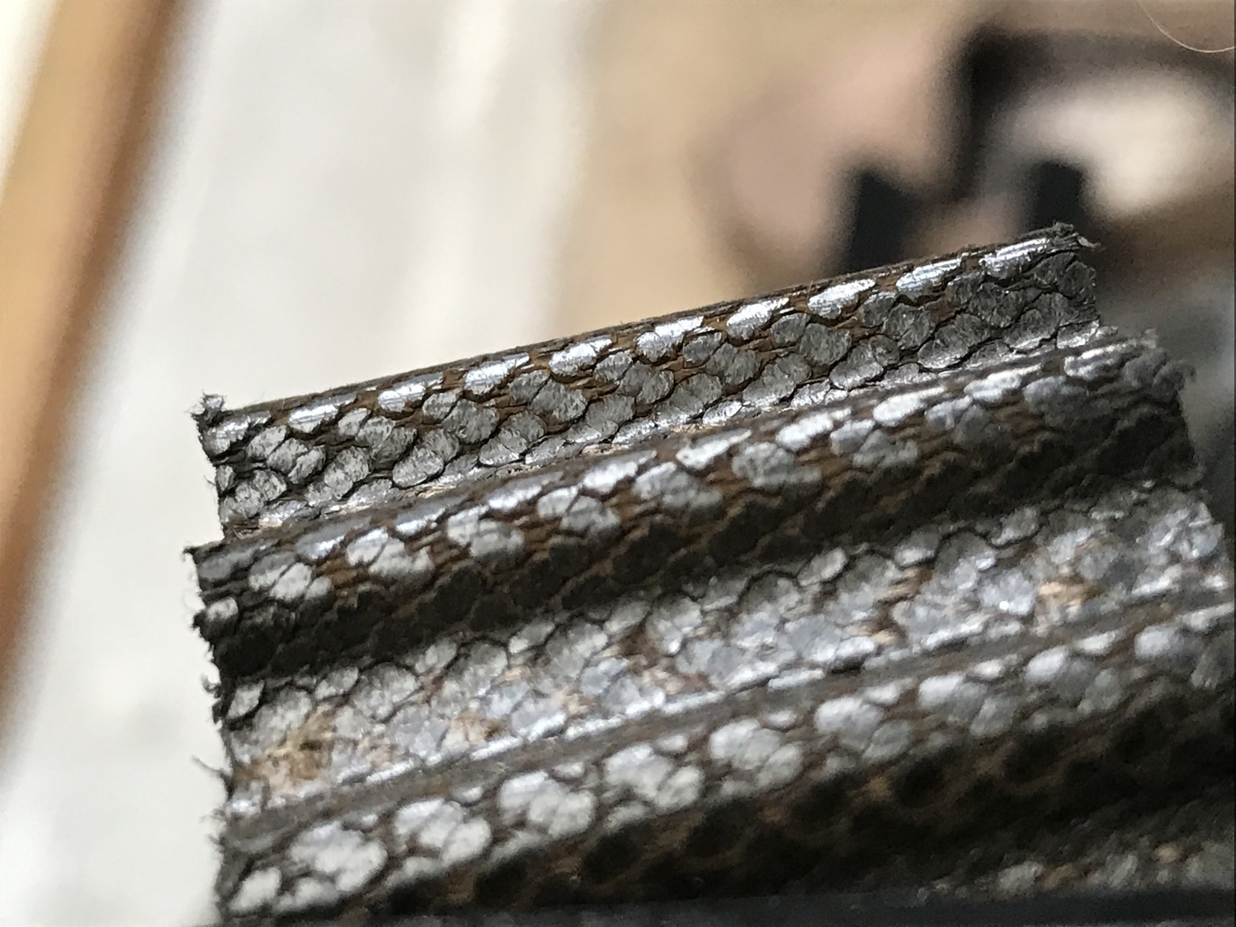

So finally got my cambelt done along with water pump for £320 incl vat. Not too bad I suppose for genuine VAG belt kit etc from an independent specialist.
Pics of old belt after 50k miles and 8 years!!  Looks like the scales of a Pangolin.
that’s just the cotton braiding on the belt, I’m guessing it’s there to quieten the belt when running, the outside of the belt is a better indication of the condition of it, most the belts I’ve pulled out are not too bad but I did have a 1.8t belt that looked bad but it was still running on the car when I took it off.
as you can see on a new belt the near white cotton braiding on the inside, this goes as your pictures over time well before the end of the service life of the belt.
