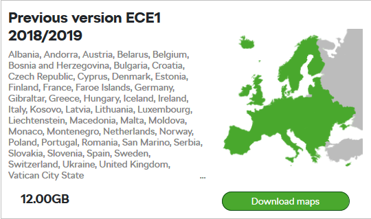

2019 Maps were downloaded from the Skoda portal after entering the cars VIN. It will be noted that only UK and near EU are now only 500GB and other regions are available so it would seem they have reduced the Map coverage to reduce download time. Presumably any region will work but I have not tried this out
They were un-zipped to a folder in Documents.
