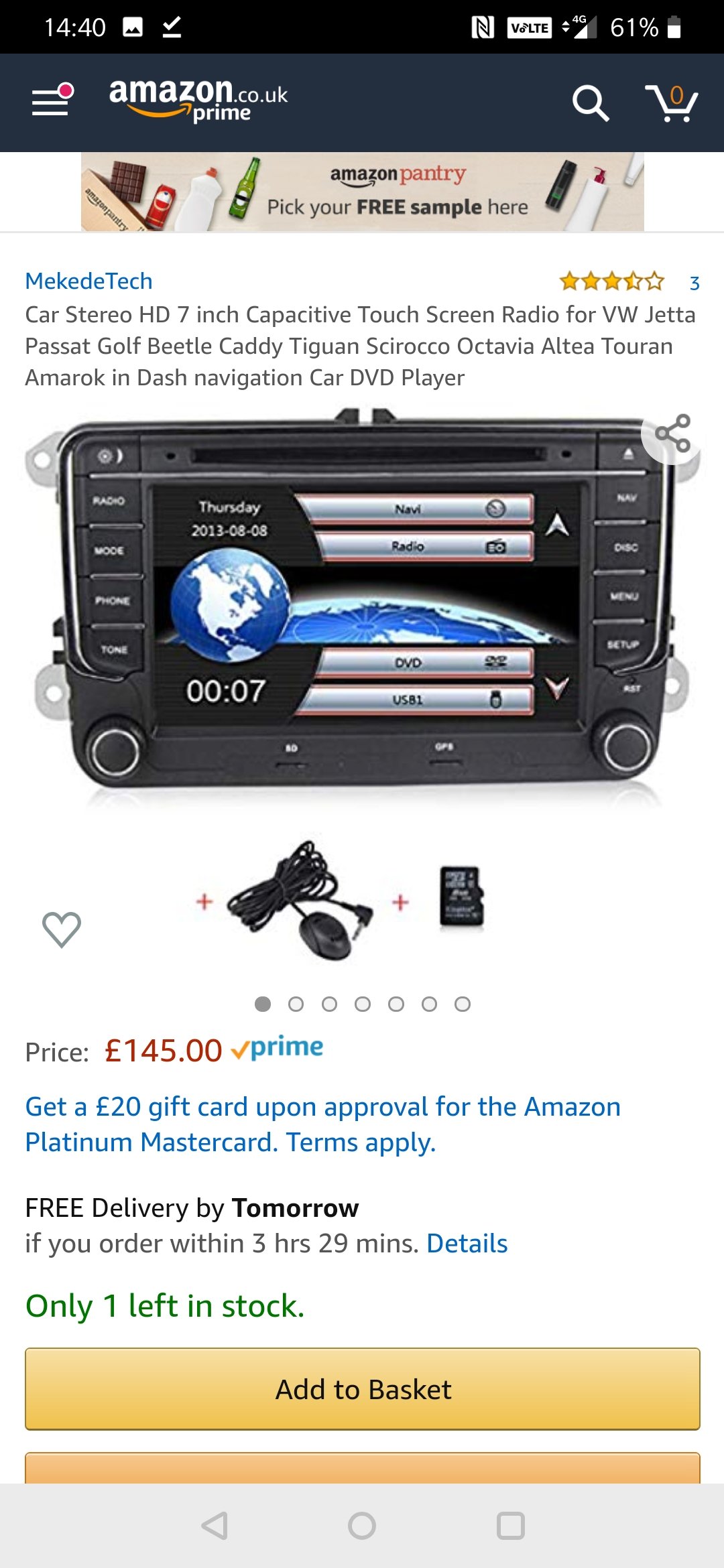

Hi again. I've just worked out that the car is not fitted with a Skoda car stereo, it's one of these cheap lookalikey things. I'm wondering whether this is why my sensors don't work and it doesn't seem like it has a reverse parking screen either. I've emailed who I think sell them on Amazon but wondering whether I should just replace it with a proper Skoda one or can someone advise which one is compatible with the sensor's. Thank you.
Yeah, that would cause the problem. Aftermarket stuff won't always integrate with OEM systems.
