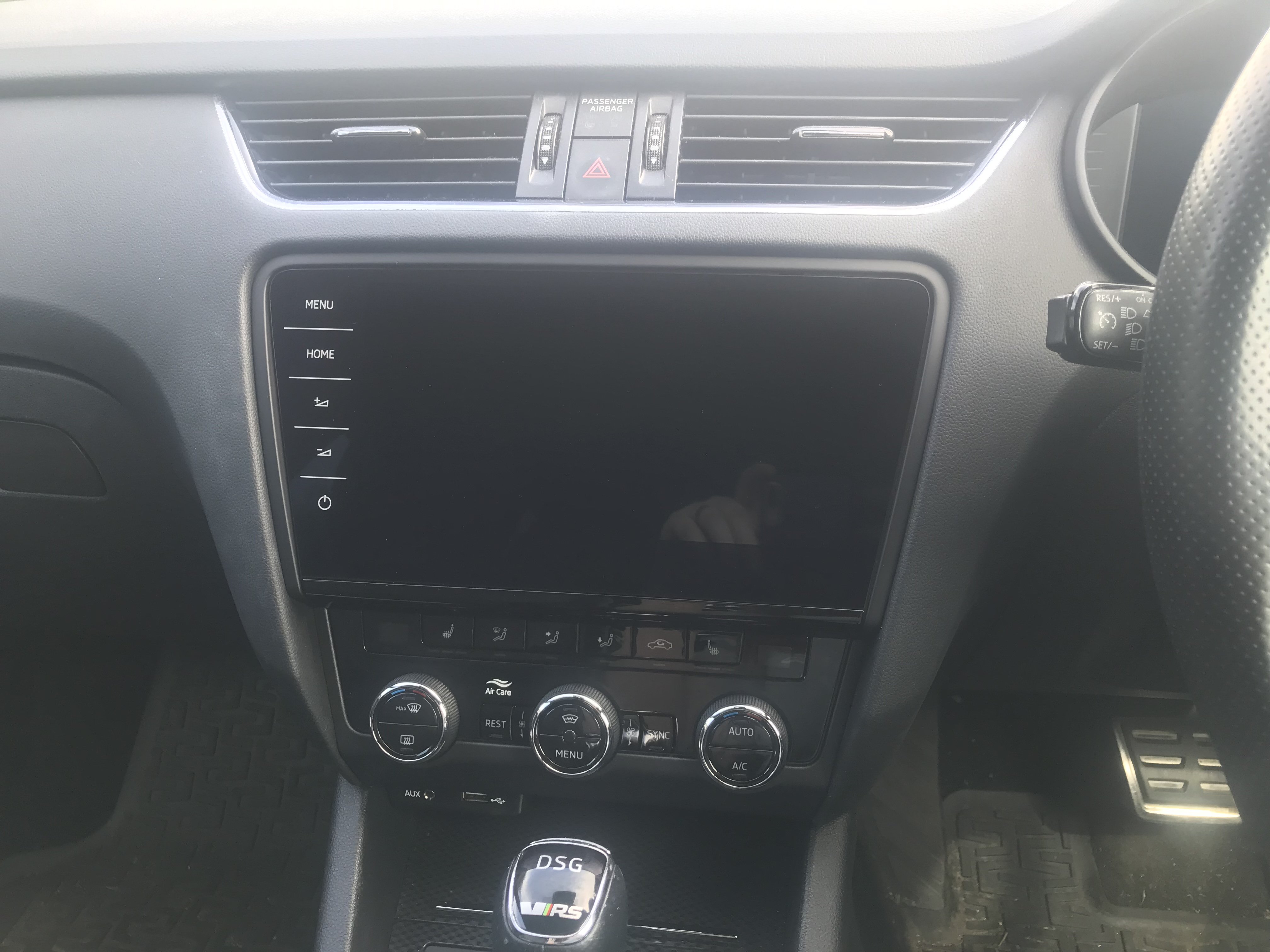

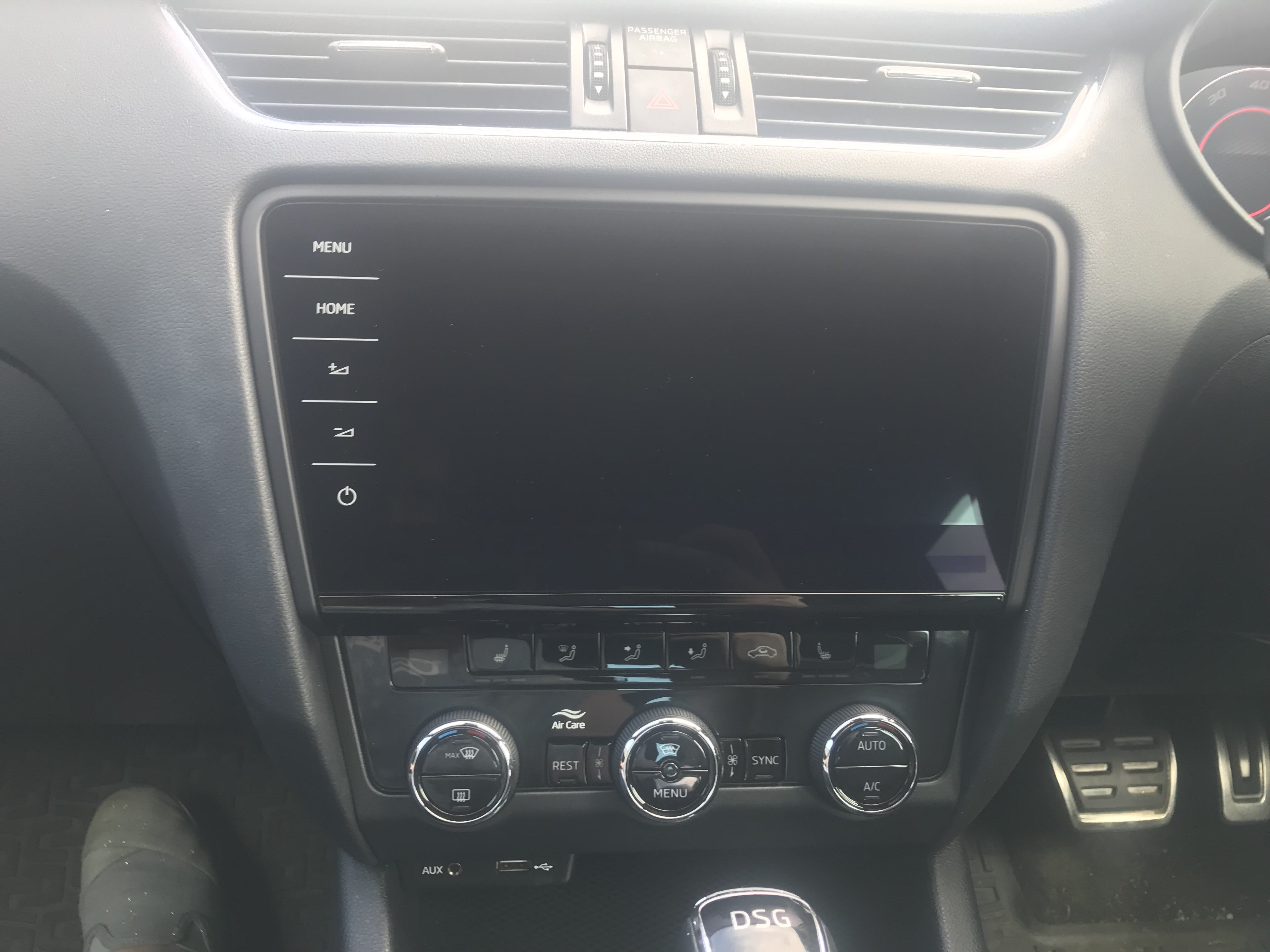

I am just swapping out my old Amundsen MIB1 for a Columbus MIB 2.5 and screen.
But I am having a problem. The display is showing nothing. I can power on the unit using the power button, but volume buttons don't do anything.
Any ideas of what the problem could be?

That problem now sorted. Me being very (very) stupid.

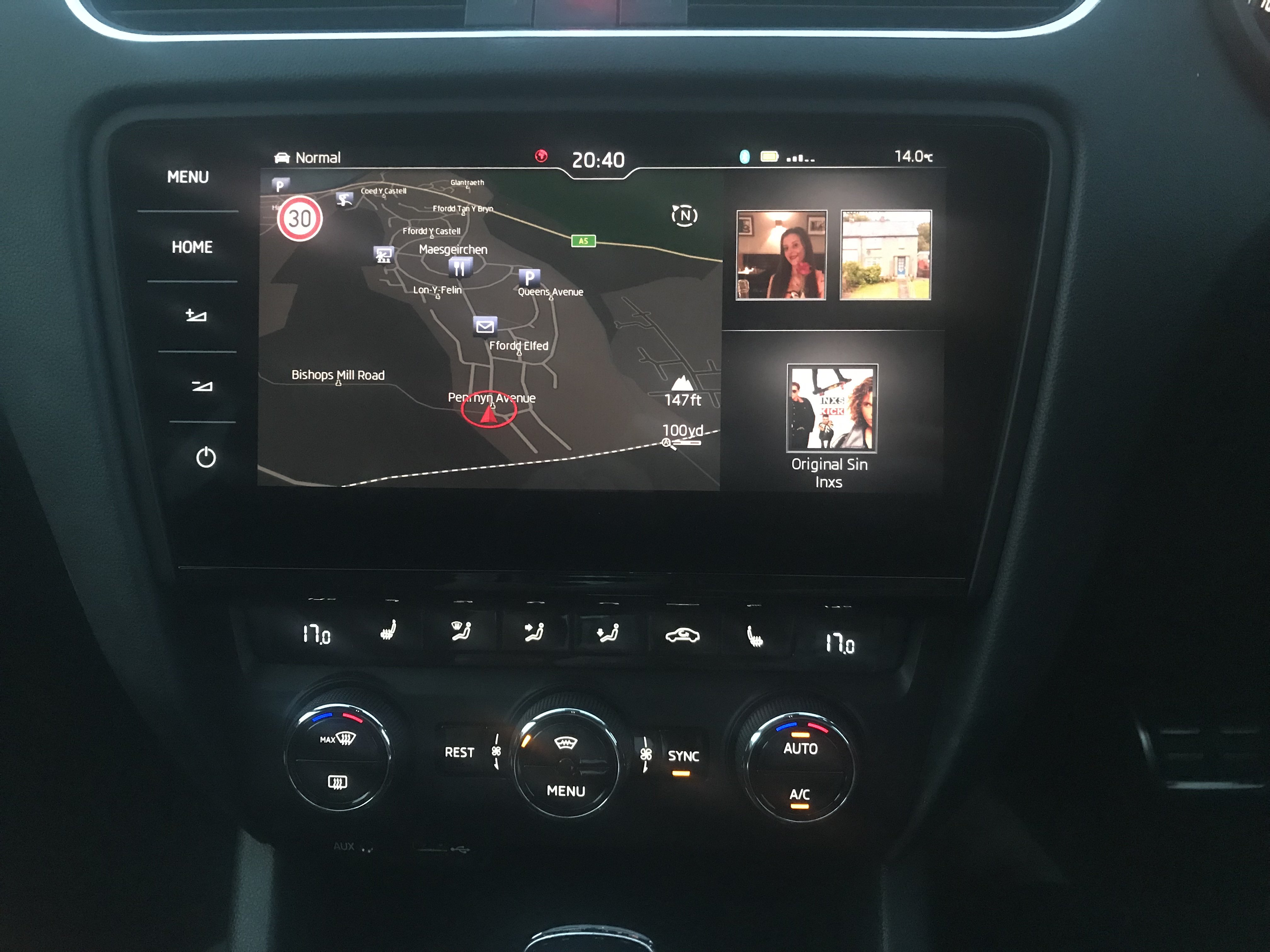

I got mine used, look for one with a green tip 5Q0025726E. I have not found a permanent home for the LTE antennae, they live bundled in the glovebox 🤣 honestly the climate panel makes it. Mine is a Superb one and has 20 min rest function for a/c with engine off for 20 mins and white backlighting.

That’s not a Superb FL panel so isn’t glossy. The Octy has green backlight on the FL panel still. Superb and Kodiaq panels are what you need, 3V0907044CR or 565907044AQ. The Superb one needs a bit of shaving down but it works fine. The trim is 5E0863152D for plain or F for AirCare. If you don’t mind green backlight and the off button there is a complete Octavia 5E0907044AP climate panel and 5E0863152F trim on eBay together for £66.

Basically I hadn't connected the video signal wire to the headunit. Was because I hadn't realized that the existing wire in the car needed to be slightly trimmed to fit the new headunit, and had just left it because it didn't fit.
Once I trimmed the wire and connected it. All was good.
