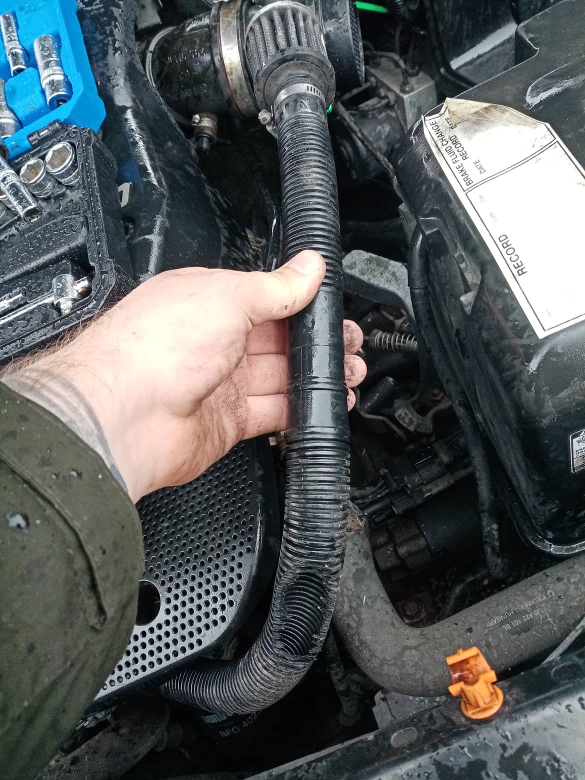

I'm loosing boost inbetween 3.5k and 4k rpm but it comes back in straight after 4k. also idles rough... was wondering if anyone has had this problem before and know how to fix it... i do have a split pipe which im assuming is some sort of breather... i was thinking on ordering some silicone hoses to see if that fixes it but with only having the car for less than 24 hours im wondering if there is anything i can do to help the situation...

Thats not split, its missing! :D
get that patched up, fully sealed or replaced. If the idle is still rough, unplug the MAF sensor and see if it improves. If it does then get a new (genuine) MAF. If not then theres air getting in or boost/vacuum getting out elsewhere.
any fault codes scanned?
thanks for the advice :) i'm going to try the maf sensor tomorrow while i'm off of work (poor car has only been driven once this week) hopefully that'll be sorted. the EML has come on to which isn't ideal, getting that plugged in Monday to see whats going on, hopefully wont come back with to much :)
A hole like that in the SAI pipe will bring an inadequate flow warning eml without even considering other issues with the maf etc. Is the SAI pump still present at the other end of the pipe or has it been deleted as a simplification mod?. If it has been deleted then that pipe serves no purpose and is just a red herring.
If it was me i'd get the hole temp taped over to plug the hole provided the pump is still there, then get the car scanned for fault codes, as you could be tracing faults for quite a while until you clear the old codes and run a fresh scan.
