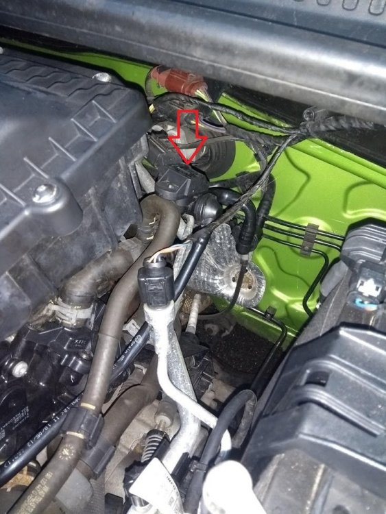

The pink arrow is pointing to the vac hose you're looking for:
Ah, that's great, thanks - so the pressure sensor is along that pipe.  Now to see if I can see it behind the air filter box and the heat shield!

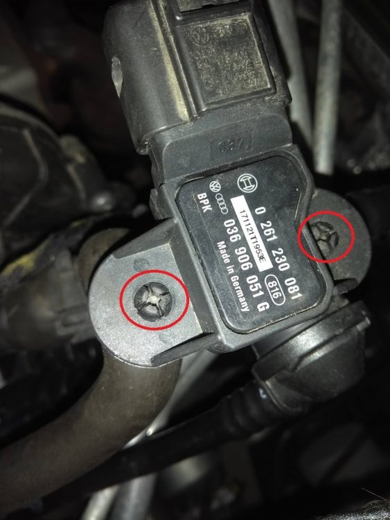

Hmm.  I'm managed to find the brake booster sensor.  It's to the top right of the engine, next to the air filter box:
I have a part number on the sensor:  036906051G
Funny thing is, that part number throws up 'intake manifold pressure sensor'.  I think the correct part number for the brake booster pressure sensor is 036906051C.  But I don't know if there's any technical difference between them...
So, please citigo community could you help me out, if you've got a citigo with stop-start - take a quick look at this pressure sensor at the top right of your engine behind the air box.  Has it got 036906051G or 036906051C on it?
Bet there's no way to test if it's faulty without replacing it either...

The brake servo booster hose is connected to the intake manifold at the engine end. So whether it's called brake booster sensor or intake manifold sensor is unimportant, it's just an air pressure sensor. It may well be used as a MAP (intake manifold pressure) sensor on other VAG cars.
The 7zap link I posted earlier says the G part is correct for your car.
What does it say on yours?
Edited by Wino
I can't say for sure about this specific part, but it is common practise for the last character of part numbers to be a 'minor' revision code. In many cases this means it is interchangeable. Often it may indicate something like a change of manufacturer or country/factory of origin. My guess is that it is essentially the same part.

2) Also, it ought to be easy to change the sensor, because it's easy to reach it.  But rather than bolts, it's held on by plastic clips (argh.  Anyone unclipped clips like this before?  It looks like you need to squeeze all four lugs together at once.  How on earth do I do that?
  • Sponsor
Might be an idea to check the wiring end to end, I can help you probably by telling you where they go. Telling me your engine code will help me find the relevant diagrams.
It is improbable that 2 sensors will fail in a short time, I think.
Those clips look like the type where you press the central pin downward, allowing the four quandrants to move inwards to free the sensor. Once the pin is out the way, they'll probably move inwards quite easily. It's hard to make out whether there really are such pins from your picture. The rear one looks like it has one, but the front one not? May have been lost during previous change?
