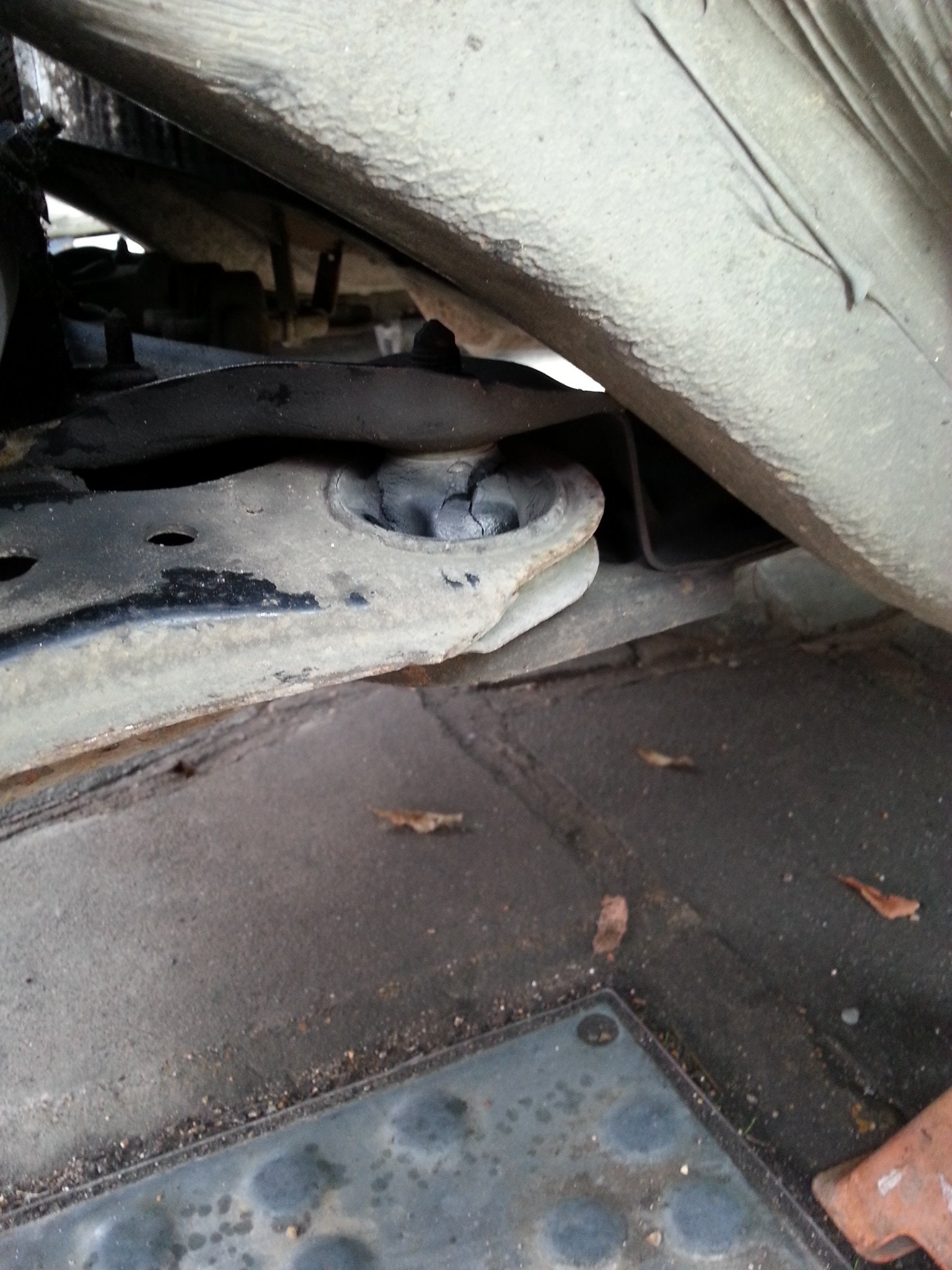

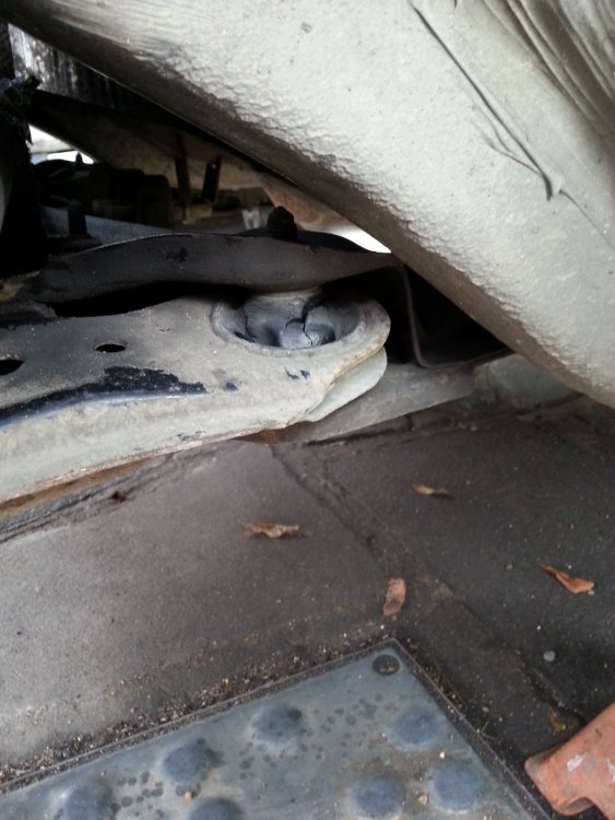

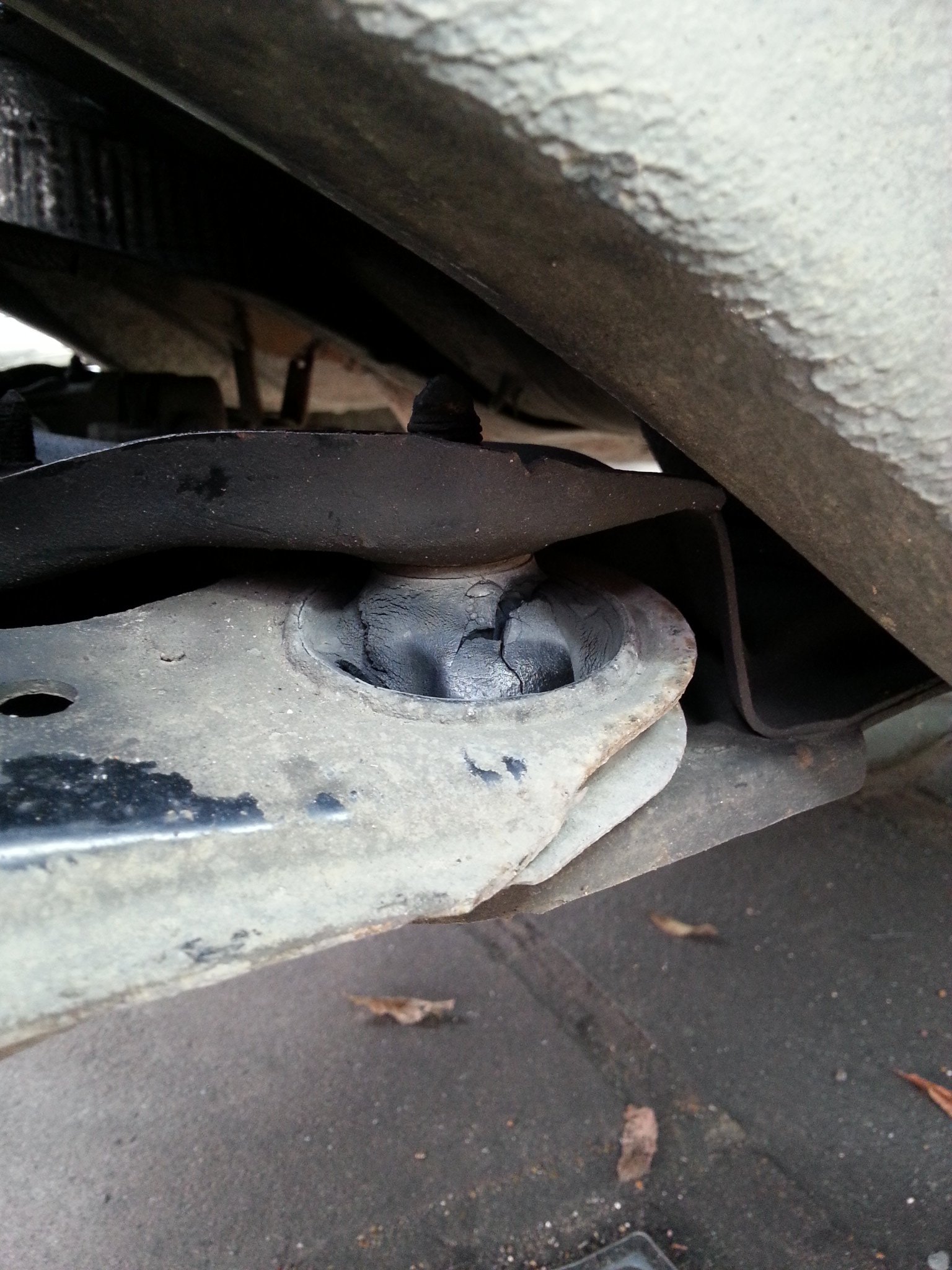

Good and bad news I guess. A mate who knows more about VAG cars than I do popped round to help. He reckons the dog bone is uprated as it's red. He noticed the rear bush on the nearside wishbone has perished. There's movement in it just by hand. I'd guess that would cause the vibration when breaking, but is it the likely cause of the vibration while driving?
My next question is uprated bushes or just buy new arms?
