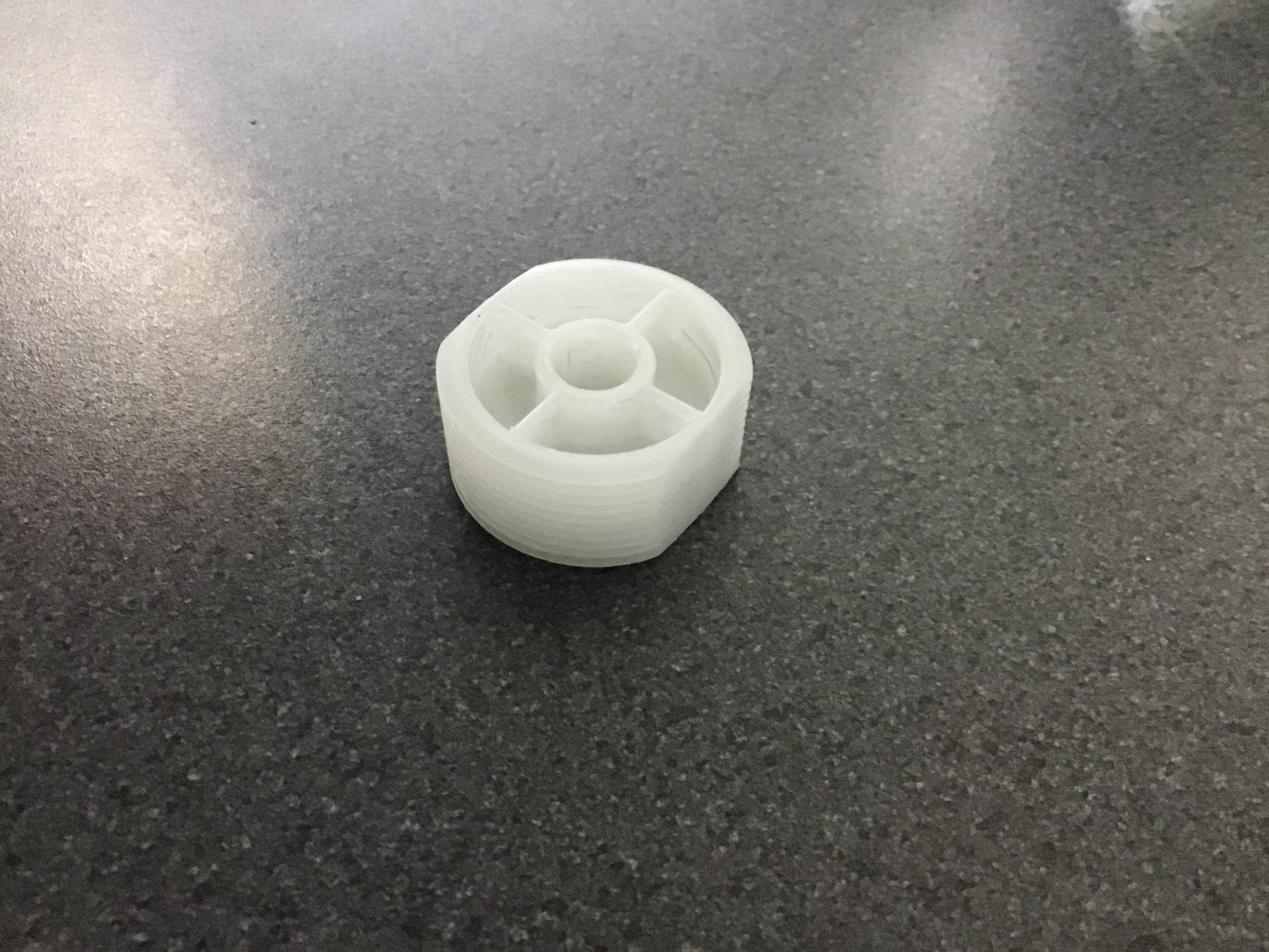

Any Idea what this is?
Driving home tonight and something fell from under the steering column cover on to my foot.  Stopped the car to find out what it was and found this! Any idea what it is and what it does or in my case doesn’t do now 🤣

Just a guess from looking at the pictures.
Looks like it holds a nut in place so that on assembly the bolt from the other side engages correctly on the threads of the nut.
So after the bolt has been fitted in place this bit of plastic becomes redundant,and often fitting the bolt actually dislodges it so it can drop into the footwell.
So,if I'm right it's nothing to worry about...but I might be totally wrong!
Gaz is spot on it is indeed a securing ring part 22 on that diagram which the accelerator and brake pedal assemblies are attached to a plate but the plastic part doesn't seem to be safety related just helped in the manufacturing process IMO.:thumbup:

Crops up regularly. From another thread (8th July):
'It's part 22 on this link:
https://nemigaparts.com/cat_spares/etka/volkswagen/goe/774/721700/
Some sort of securing ring.
Part #5Q2 721 431'
Gaz
You gents are legends....massive thanks for the info.  Saves me a job ripping into the Dealers on Tuesday 😜
