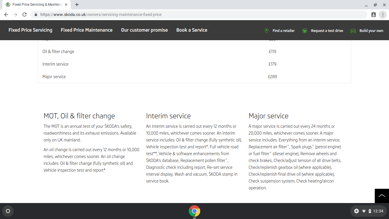

Serviced just had Major  the problems is worse now , no fault codes, manually again tug under load, plugs weren’t changed at service, otherwise all new filters etc
Were the Spark Plugs taken out and checked, the Manufacturers recomendation is at the 2nd Major service, so at 4 years.
Or 40,000 miles, so when are they getting changed.
Did you pay for a Major Service at a Main Dealer, and yet the plugs were not changed?
If you have a car serviced and it runs worse after than when driven in for the service get the place serviced to find out what they did wrong,
and ask 'Was a software update done and you never told me?'
Also ask, 'did you charge me for a Major Service and not supply and fits due at the service like new Spark Plugs?'
