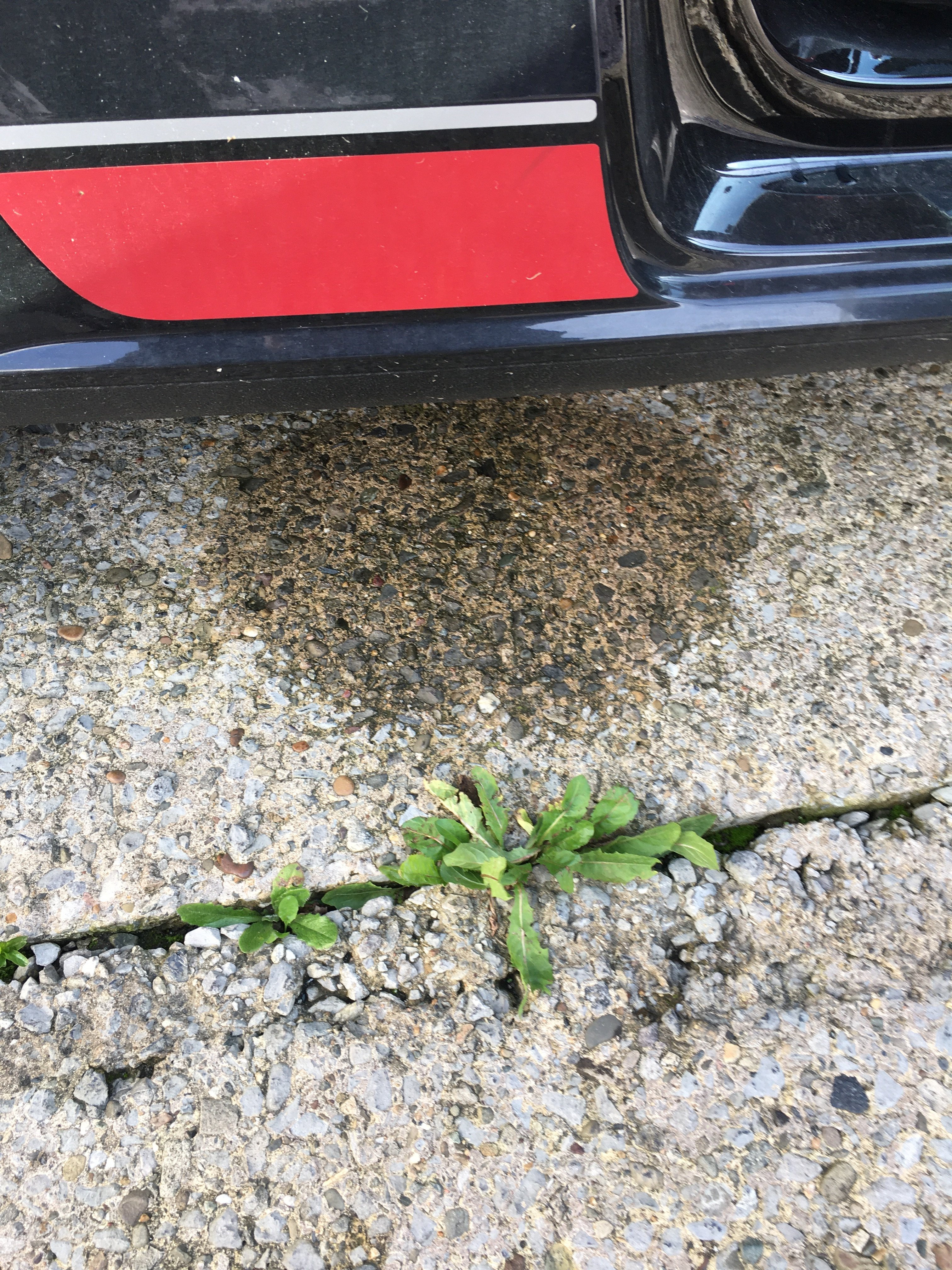

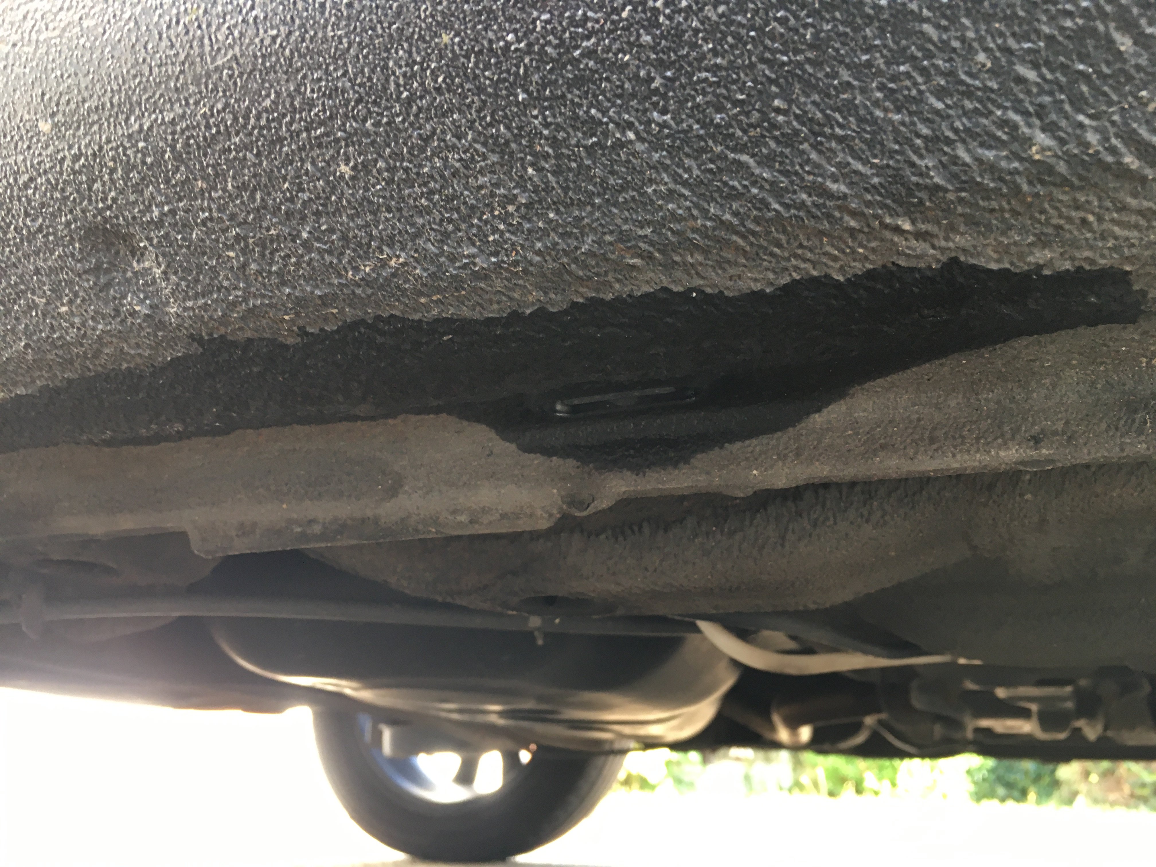

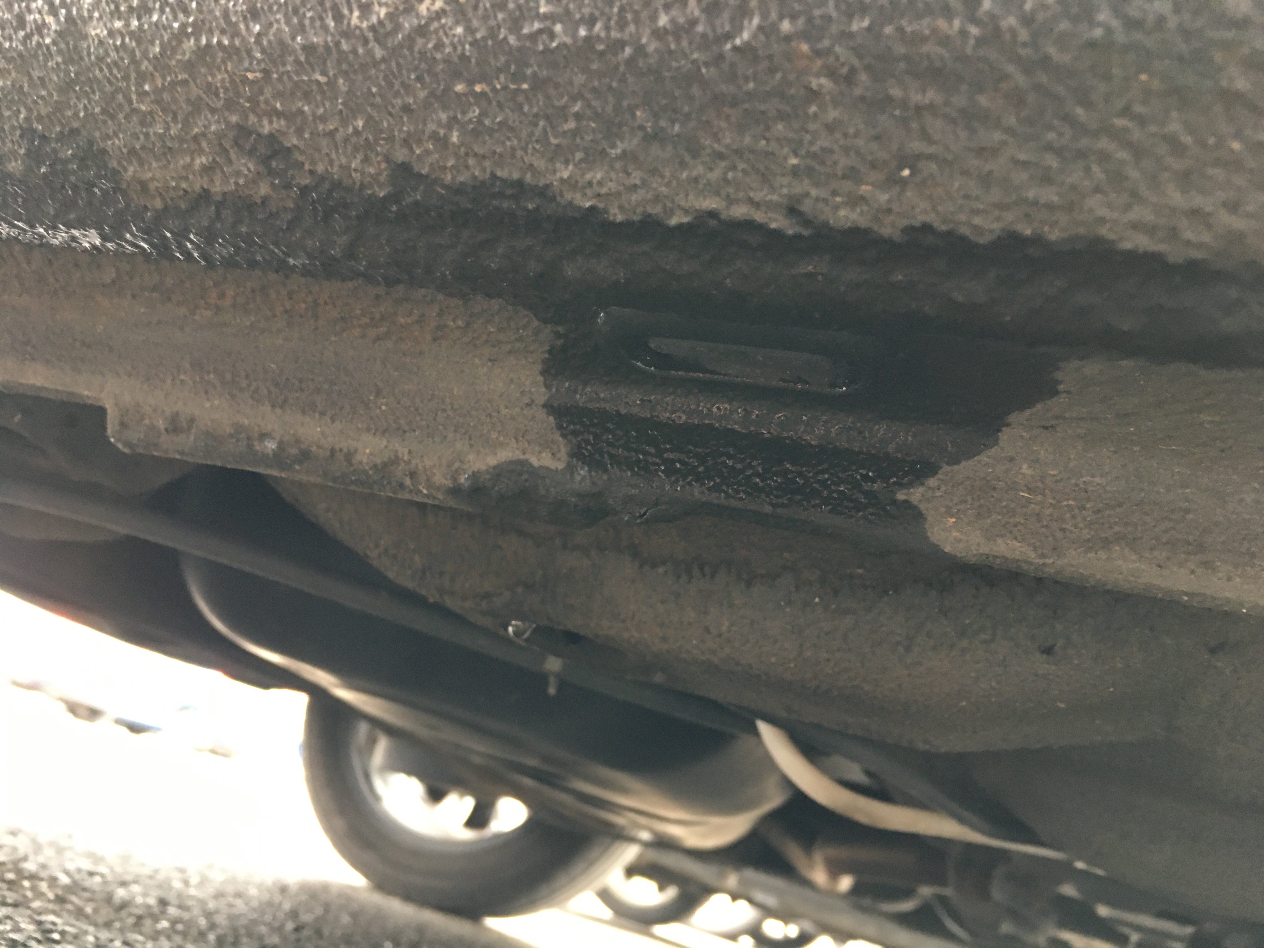

Hi all every time I accelerate or brake I can hear a sloshing sound coming from the drivers side rear and have no idea how the water is getting in, I took a picture today of bung on rear drivers side and it was leaking water! Any ideas how it’s getting in there or has anyone else had this issue ? 13 plate sport I have.

My sons car has the same issue, took the plug out and gallons of clean water flooded out. He is leaving both the front and rear plugs out for now on the drivers side. We have no idea how or where the water is getting in. His is also a Citigo Sports 2013 model.

Caz91, remove the rubber bungs in the sills on the drivers side, all that water will flood straight out, when we did my sons car it stopped the sloshing sound straight away. We are leaving the rubber bungs out now so any water entering can at-least escape easily and not build up in the chassis to the point where you hear the sloshing sound. For months we thought it was just the sound of fuel in the petrol tank, but it was an immediate end to the sloshing sound when we removed the rubber bungs and a couple of gallons of  clear water gushed out!!
