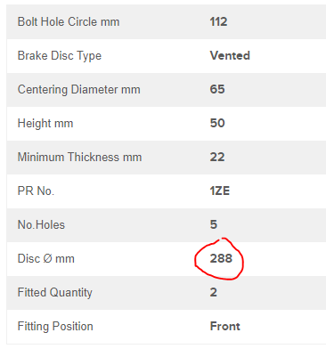

In need of new front discs and pads but my problem is what size do i have. Autodoc gives me two options 288mm and 312 mm?
Yeti 2011 1.8 TSI 4x4

288mm...
To be sure though, I just nipped outside with a U-shaped piece of cardboard cut to 312mm (for my 2011 Skoda Superb). Worked a treat :D

Fairly certain only the TDI 170 had the 312mm discs...so I'd go with 288mm as well for the TSI.
