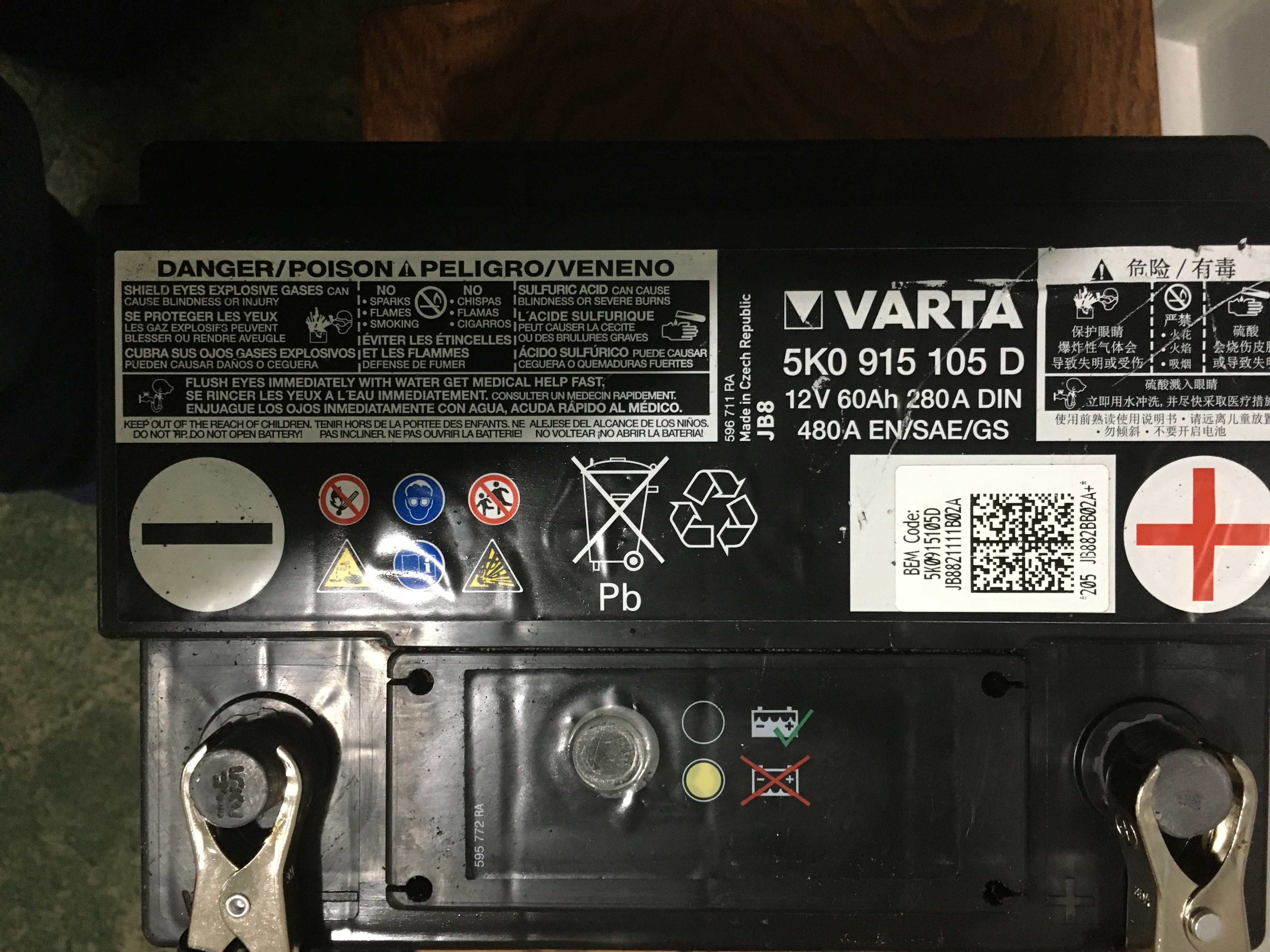

I pulled out the battery and put it on a battery charger overnight, so once I put it back in and dug out my Carista dongle there were 18 strange codes from all over the car. I reset the codes and checked again and no errors came up. I also went for a drive and checked later and still have no errors.
I'm not sure how old the battery is, it is a VW stamped Varta battery so maybe its close to the end of its life. However, I didn't realise how expensive car batteries are now. What is the recommended battery for this car?
The battery code as in "spec" for sizing is 012
heres one.......
https://www.tayna.co.uk/car-batteries/varta/c30/
The strange thing is know one seems to do an 012 spec battery with 60AH rating, not sure how they get that on this battery size, but the one linked is a VARTA anyway which more importantly has a higher CCA rating (cranking)
The other size is 027, but I think it may be to long....although it has similar specs, but again higher CCA
https://www.tayna.co.uk/car-batteries/jis/d15/
