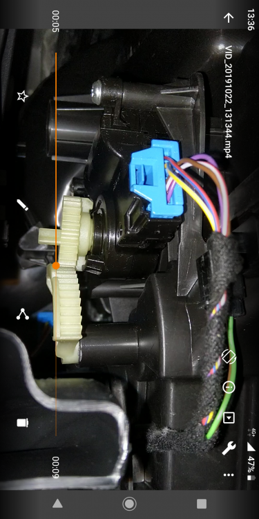

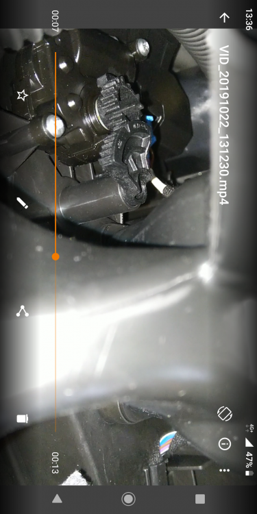

I got down in the footwells and a quick visual inspection of the left & right temperature flap control motors, and they seem to be operating normally... as far as i can tell anyway.
I've attached a pic of the two flap controls, in case anyone spots an obvious issue with them

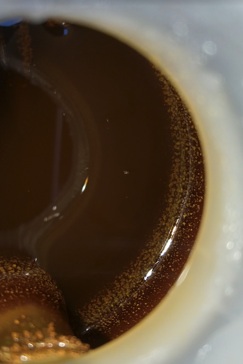

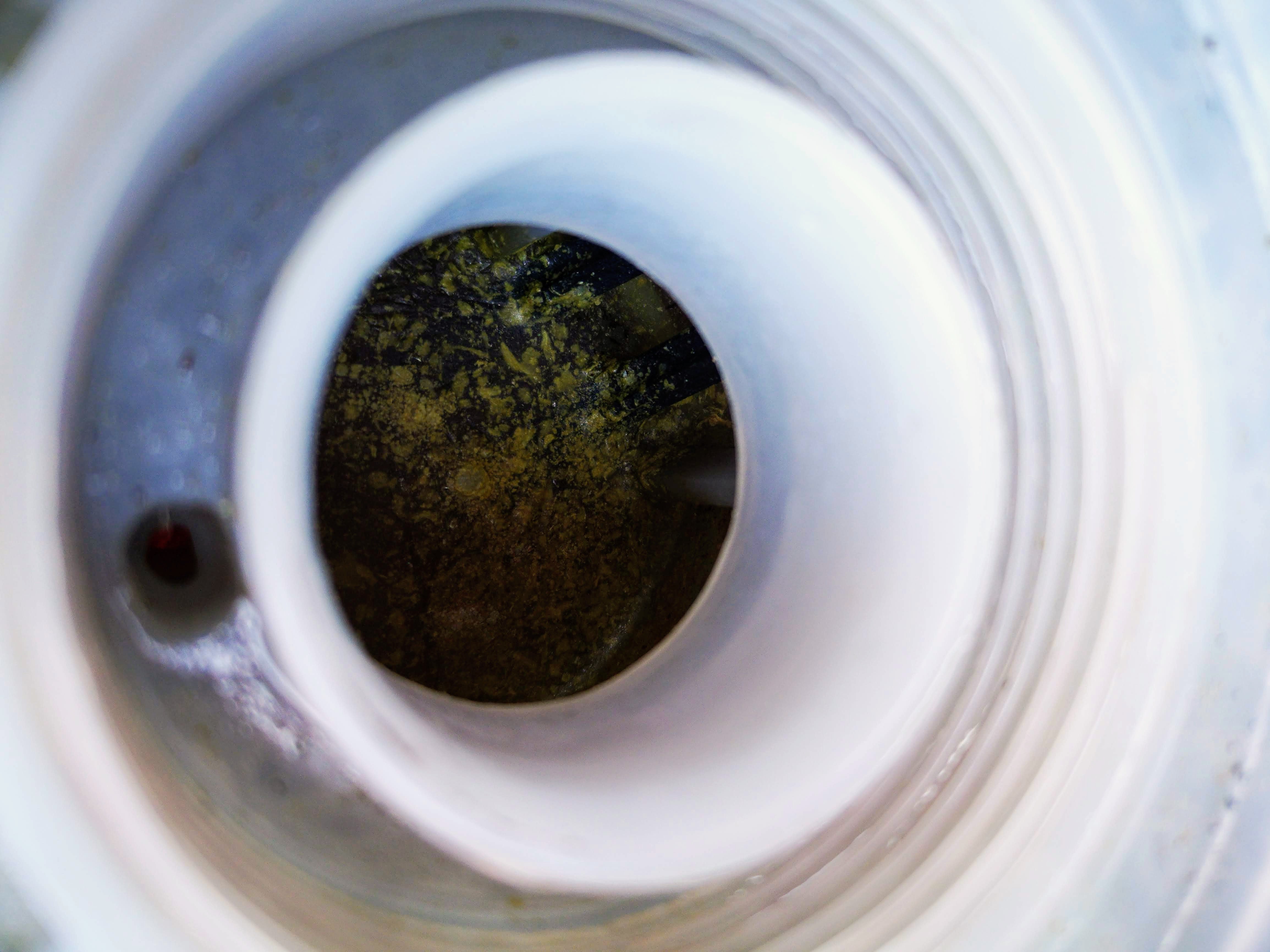

Can you post a picture of the coolant inside your expansion tank? Mine looked horrible before being diagnosed by the garage. It had gone in for a flush as part of the waterpump and timing belt.
My coolant tank is certainly picking up some kind of rust or dirt from somewhere, it has an orange/brown look.
Yeah, I wouldn't be surprised if that is the "Silikat" stuff.
My car initially went in for Timing Belt & Water Pump. I had asked them to look at the air from the vents as it wasn't warm, just "not cold" as I usually have the aircon set.
The garage advised that the heater matrix was blocked and that it was something they are seeing more frequently now. A heater matrix, new coolant pipes, expansion tank and a flush were required to solve the issue. I went ahead with this as approaching winter I'd need some heat in the car due to my early starts and overnight finishes. Works completed and car picked up with some heat now from the vents.
Unfortunately, it turns out my car was one of the worst examples they have seen of the "Mit Silikat" bag splitting. So about 2 weeks I was back in due to bits floating in the expansion tank and the heater matrix seemingly blocking again (heat was there, just not very strong).
Before I go any further, I'd like to say the garage I used was amazing. Updates on the vehicle status each day or as they got further into their remedial works. Covered on warranty for the works carried out initially and very helpful.

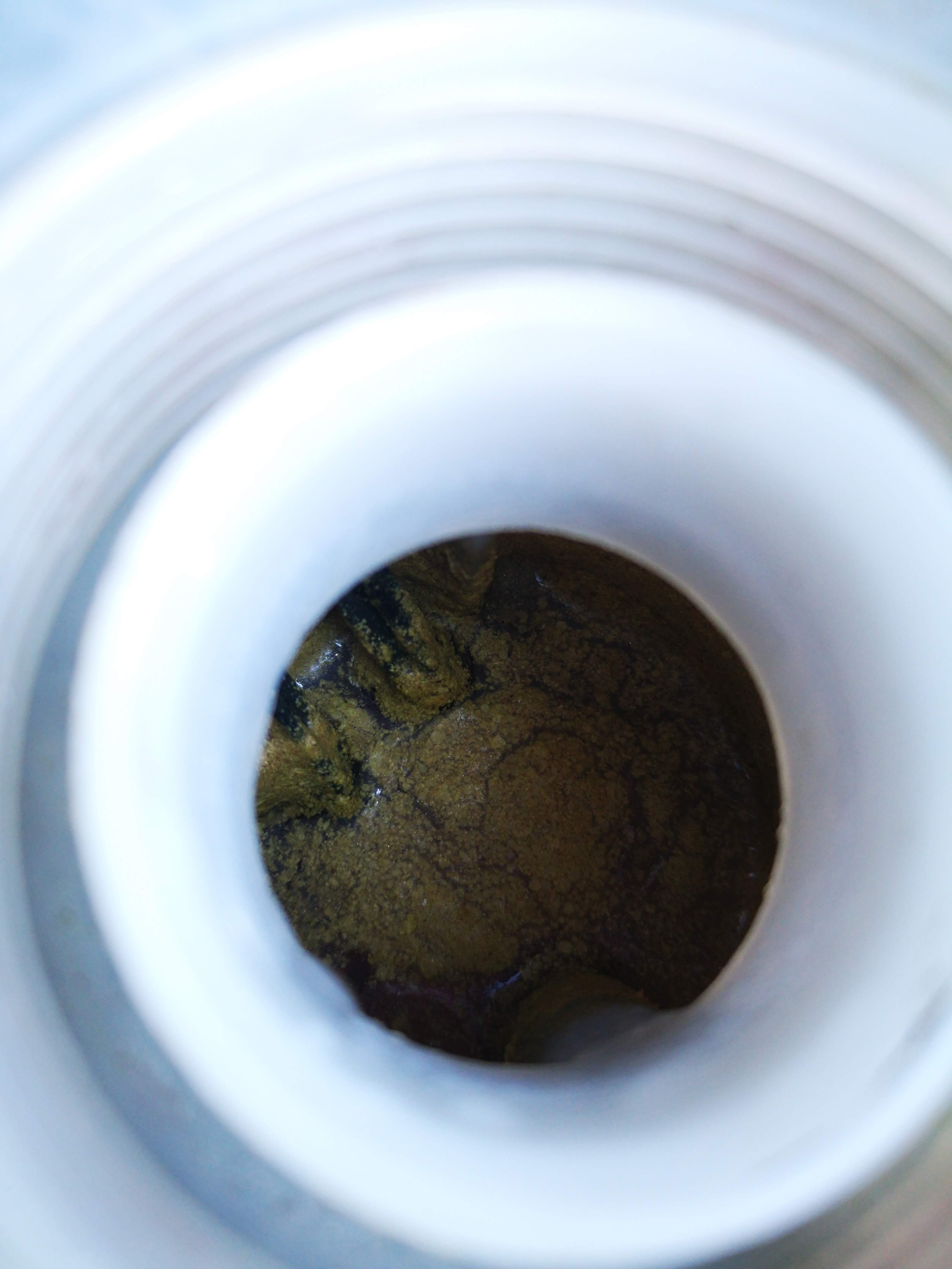

The car had multiple flushes and the radiator was removed to perform a flush away from the main system, a new expansion tank and a new heater matrix fitted. They then gave the vehicle back to me to drive for a couple of weeks before I went back in for a further coolant flush to ensure that the "Silikat" material was out of the system.
Picture 1 - After the initial flush but before revisiting the garage.
Picture 2 - Before going back to the garage for the revisit (see how much worse this is from Picture 1 taken about 6 days apart).
Picture 3 - Between the remedial works and the final flush. If I saw any in here, I tried to remove it as best as possible to stop it going back through the system.

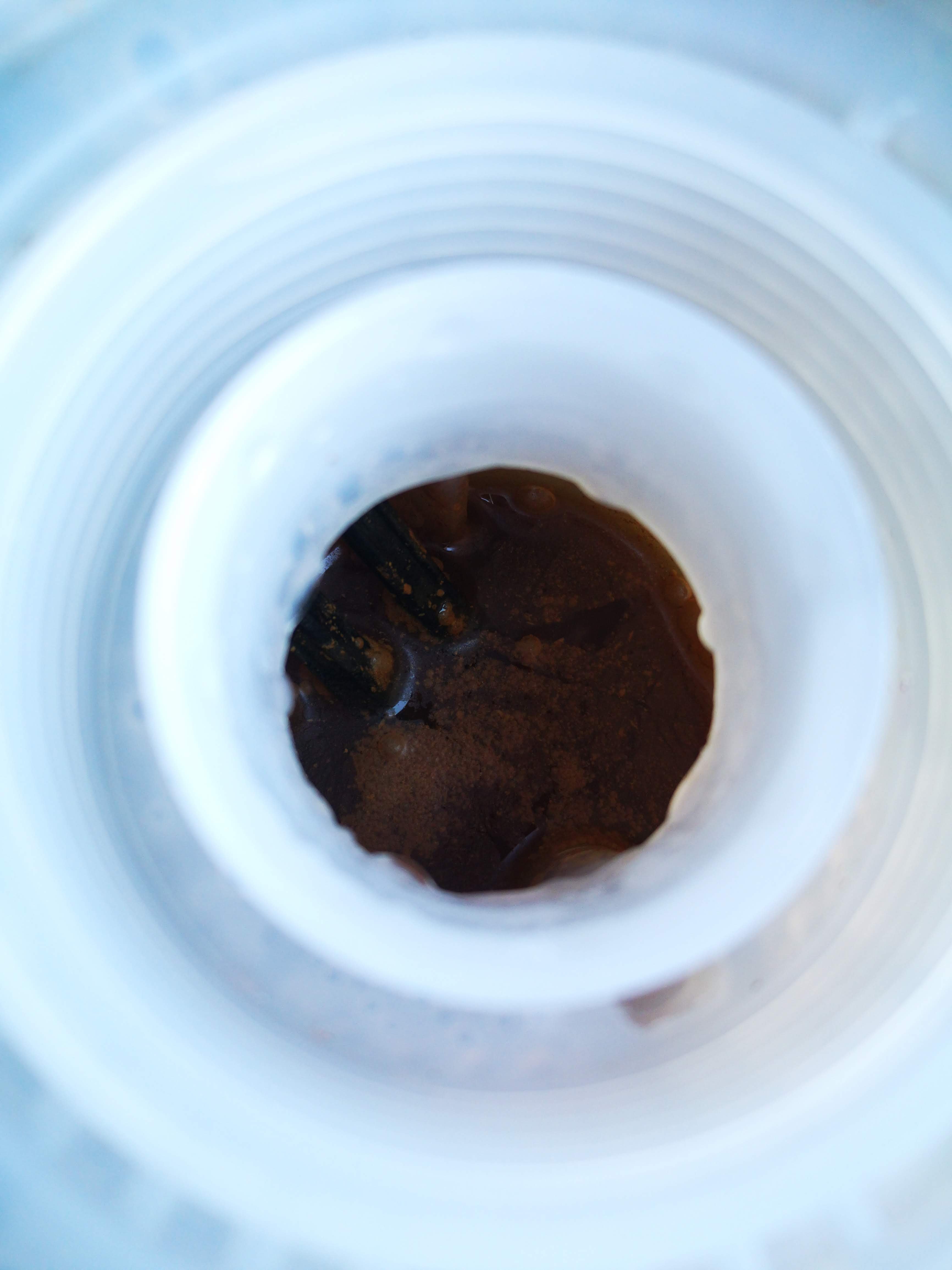

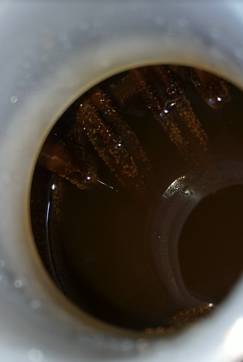

have attached pics of my coolant tank....
looks like some reddy/orange stuff in it, quite similar to J_D's 😭
will bring it into mechanics to flush it out 😫
