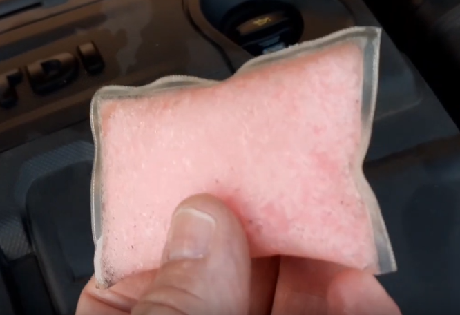

This was my bag, freshly removed and not cleaned or rinsed.  It is still full and shows no signs that any of the contents have leached or dissolved in the 5 years it has been immersed in the coolant. So I'm still sceptical. That said, I'm not a chemist and I don't know what variant of silicate they use. Maybe it acts as a catalyst for some other reaction that occurs. Interesting nonetheless.
It is probably aluminium silicate which consists of aluminium, oxygen and silicon. It has corrosion preventative properties and when mixed with water it can remove impurities (filtering agent). I worked in a pharmaceutical warehouse for 6 years.;)
Good call.
But would it breakdown to a brown sandy mush/gell? I don't think it would and as you can see from my bag, there is no evidence of it doing so and my expansion bottle was nice and clean. So I'm not sure the silicate bag can be blamed for the sludge people are seeing. Sure it can be blamed for bursting and blocking the heater matrix, but not sludge in the expansion tank.
