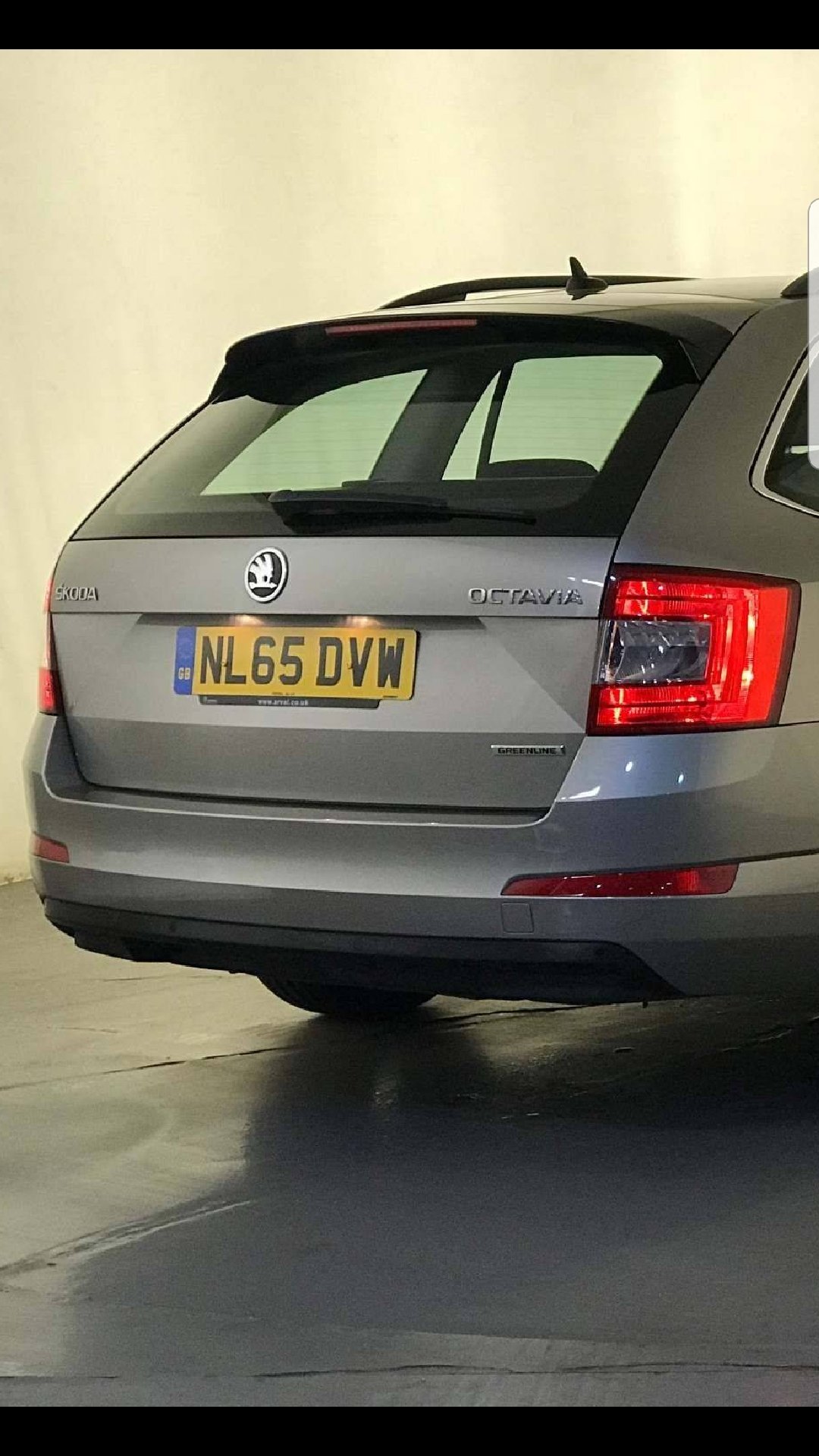

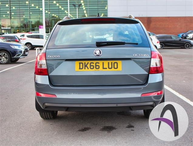

Is the spoiler the same as this one?
I wouldn't have thought this one covers the glass at all?
Edit: I can see this one does:
1249466101_Screenshot_20191031-145447_AutoTrader.thumb.jpg.448eefc868815bb47adb280e250d4ada.jpg
If it is indeed bonded, it will require a bodyshop to remove & replace unfortunately.
Have you looked yourself to see if any fixings are visible at the edge of the screen? Did the Autoglass tech remove the upper plastic trim on the inside of the tailgate to look for fixings, or were they working on assumption...?
