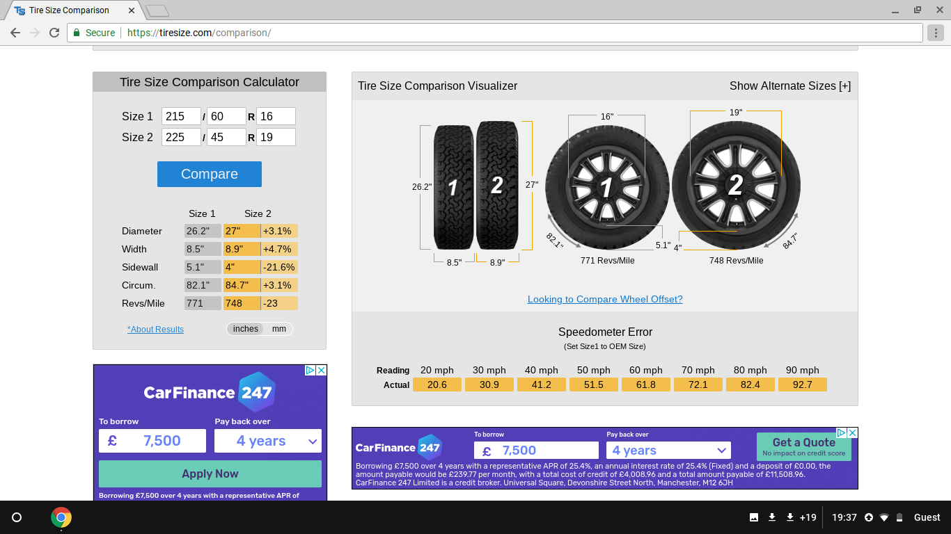

My 2019  Edition 4x4 is fitted as new with these.
Bridgestone dueller hp sport
225x45xR19  92W
