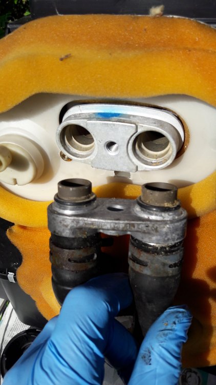

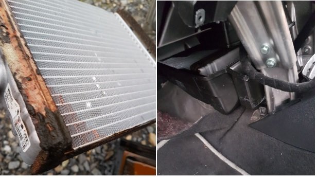

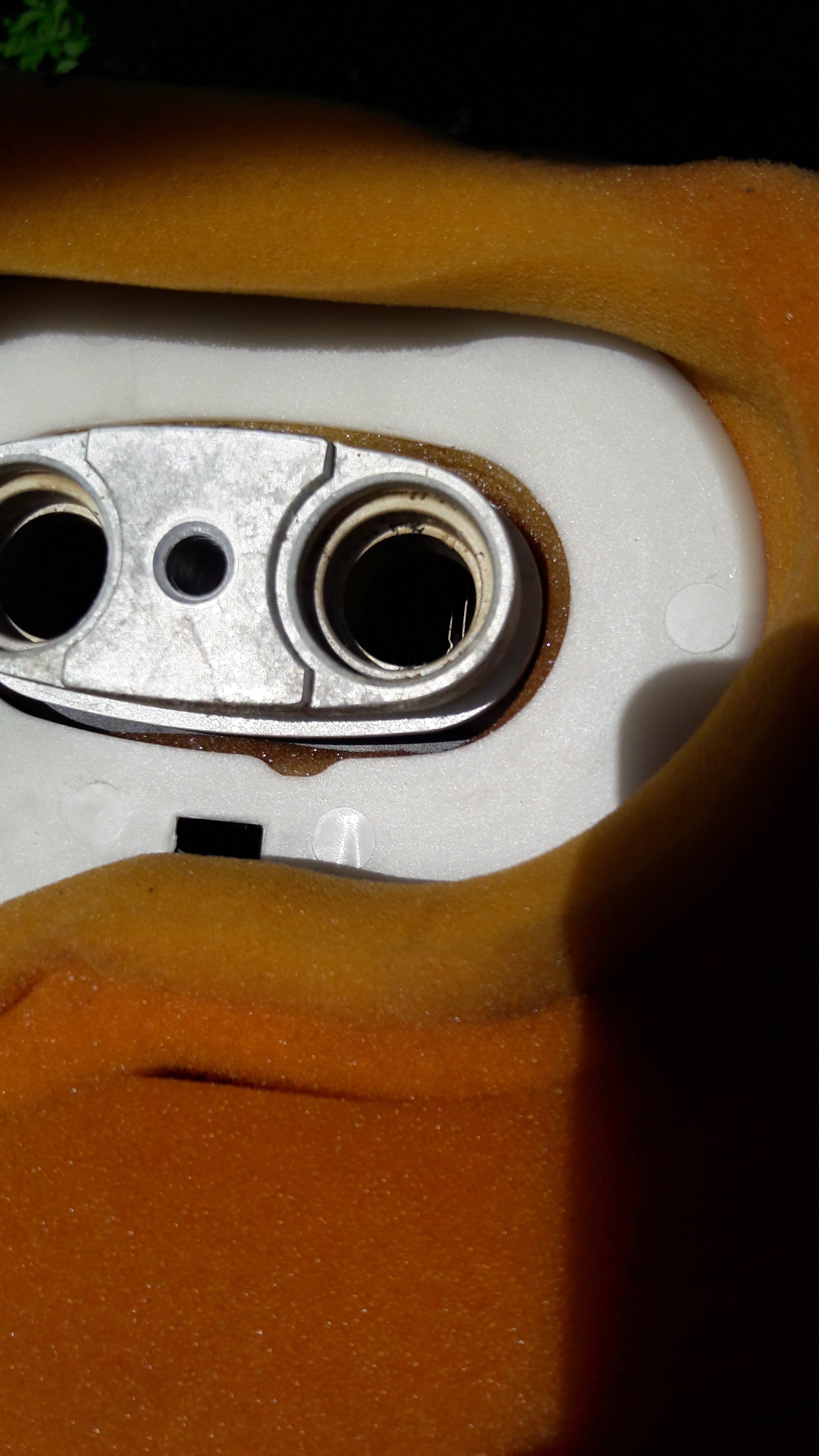

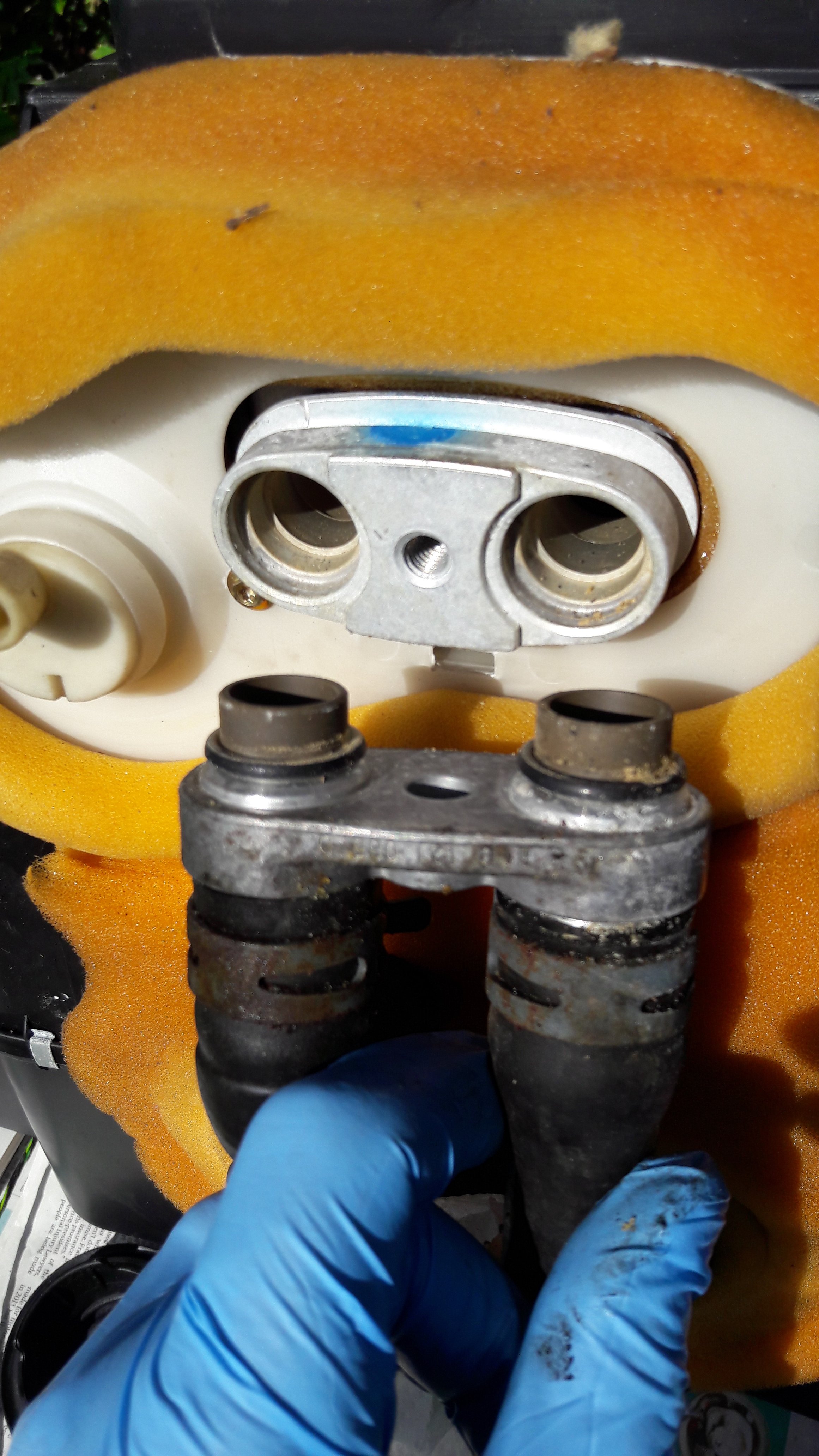

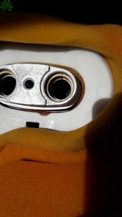

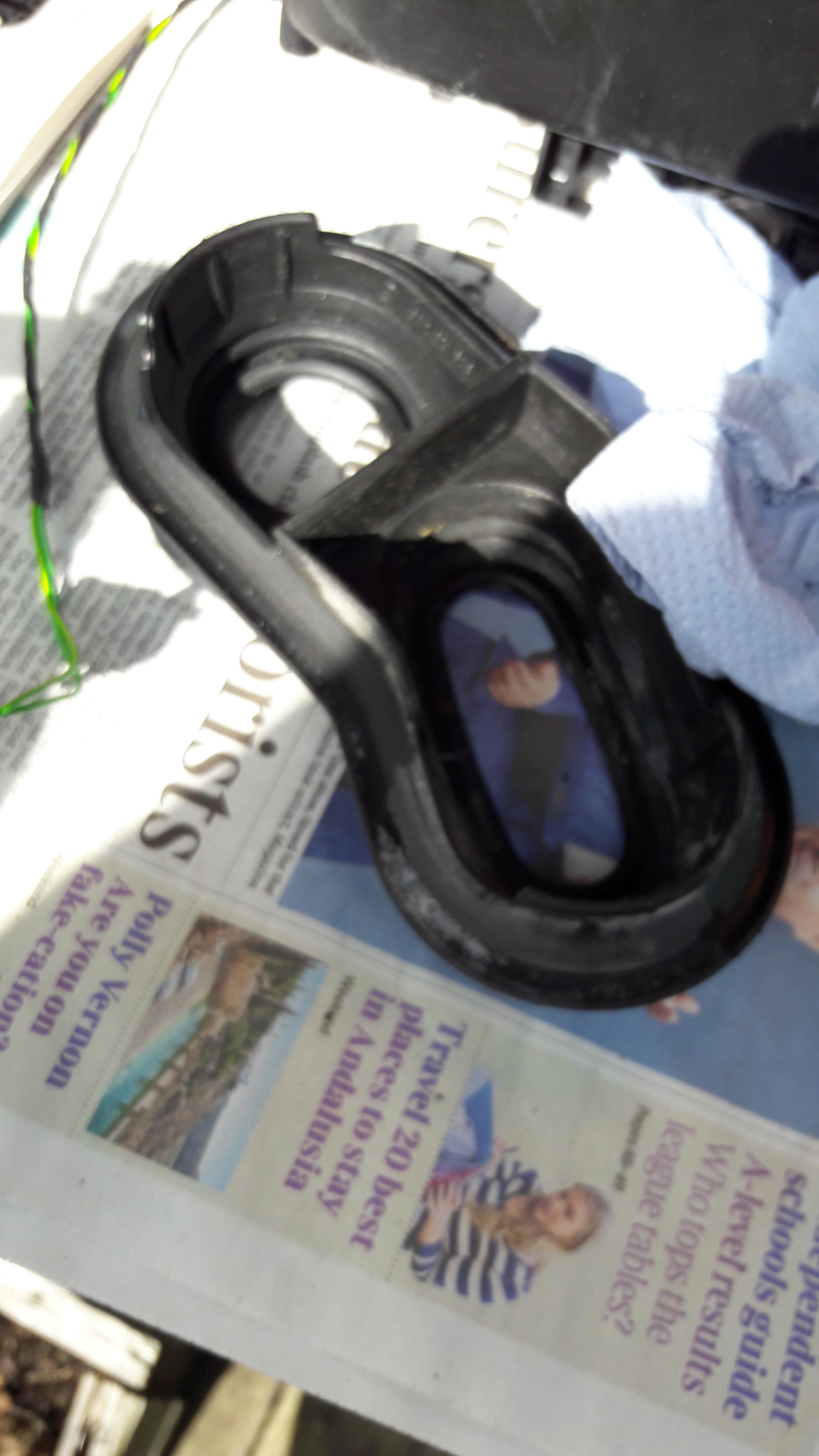

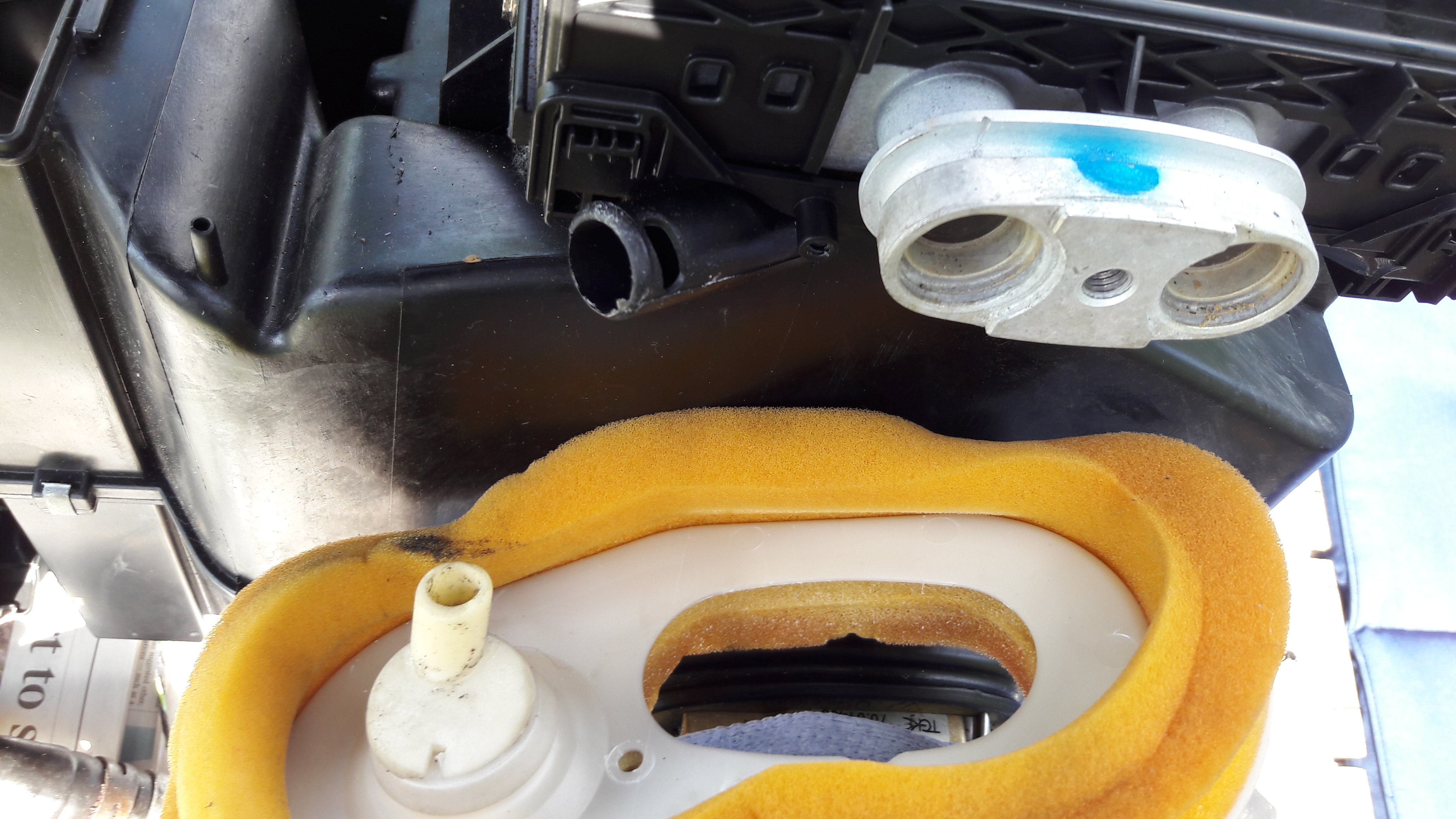

Some photos here of the arrangement of rubber and foam gaskets between the various bits. Looks very much like it would be leaking outside the cabin to me, unless the whole heater/A/C box has been out and misfitted on the way back in, in the past. Sorry they're all upside down..
  • Sponsor
You'll probably find you have to unbolt the airbag controller beneath the heater box to get the bottom cover off, no big deal though. Either disco the battery and leave off until all is reassembled and plugged back in, or leave the wiring connector on it, just moving the controller sideways out of the way.

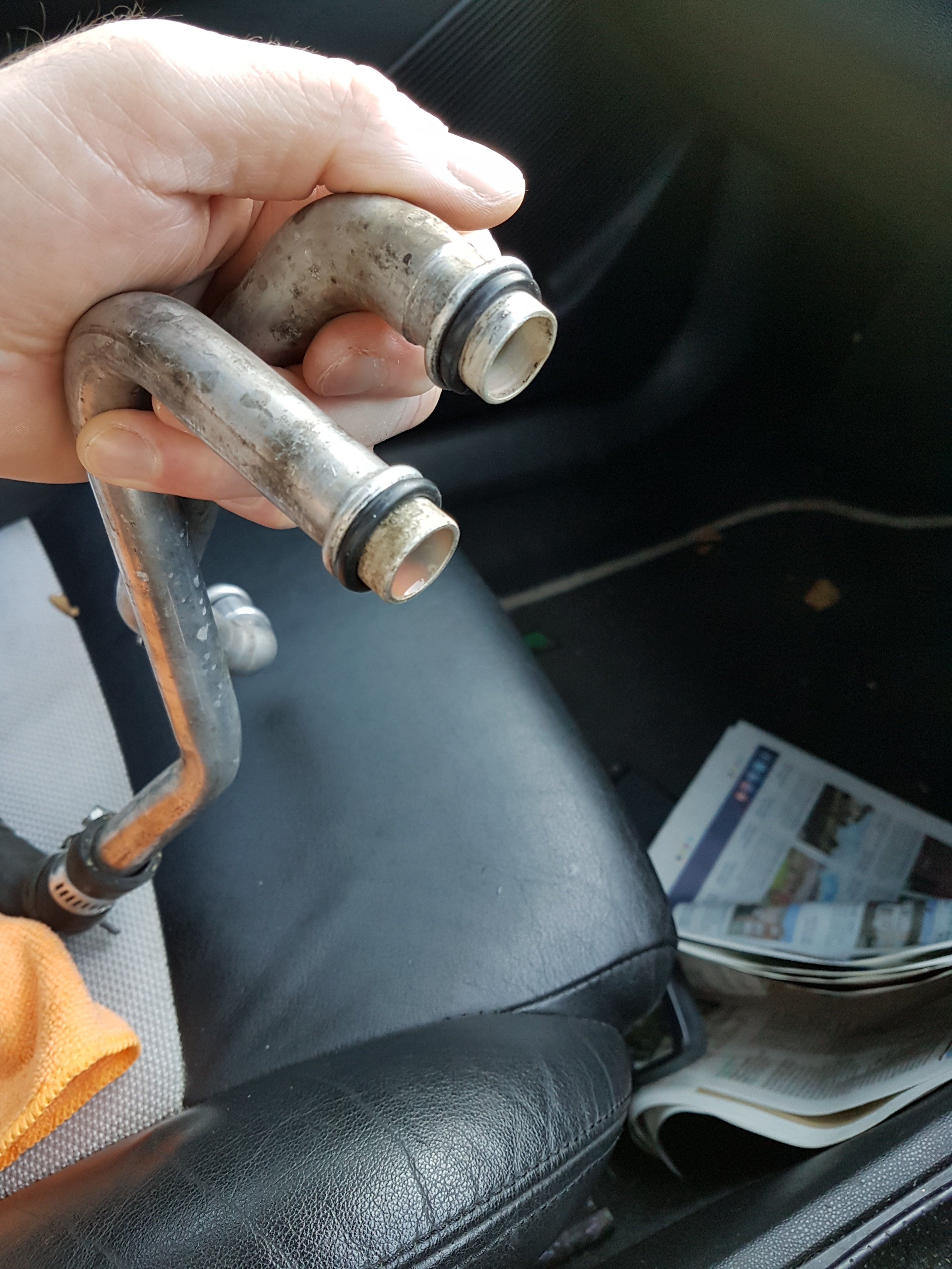

Im getting a few bits organised today and will go for Saturday if im not working. I see that a Polo has a connection to the matrix that allows you to fit rubber hoses and dispenses with the alumium ones as in picure 2 ! I might have to visit our local breakers (Where they put a starter motor around the gaurd dogs neck during the day) and see if I can locate a Polo.
What might be a right course of action is to put new O-rings on and connect all up again and try it out before going in changing the matrix ..?

Lots of Fabias have the rubber hoses straight on there too, think it's only the turbo engines that have the metal ones, not sure.

          Well I took off the 2 alloy pipes and they were perfect along with the o rings which were soft and compliant - no sign of any leak or corrosion  to be found !

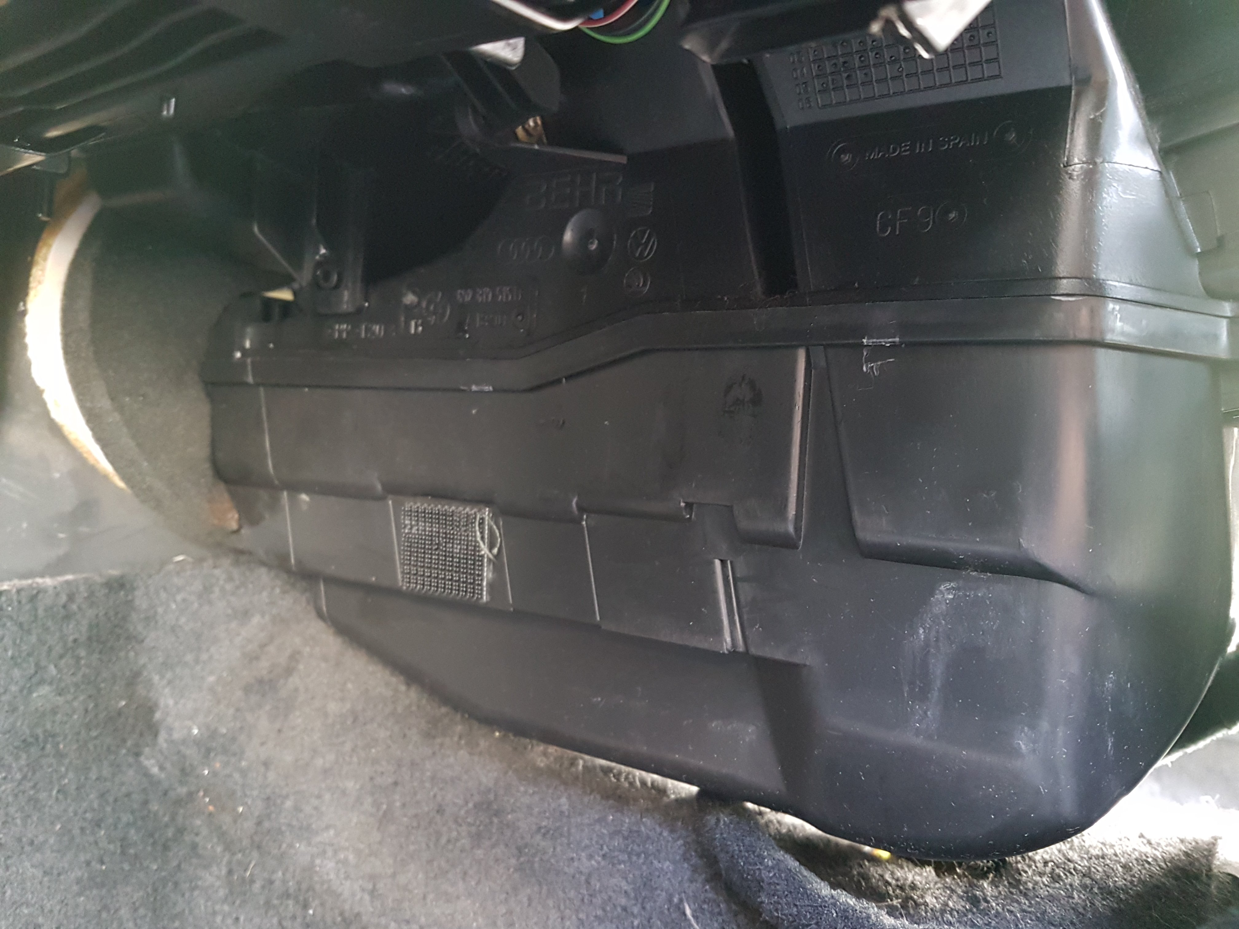

Well now - things going not too bad at the minute - have all stripped ! Worked out not too bad ! Stopped for lunch !
I have access to the matrix enclosure and I can see the airbag control unit - battery is disconnected ! Do I take out the airbag control unit and take off the bottom section of the enclosure ?

Yep
Cheers Wino !! I've had to call it a day here !
Fading light and domestic duty !! Bottom of the enclosure seems to not want to separate ! I've taken the clips out and pulled the carpets back - disconnected and removed the airbag unit !
I'd imagine that I would be able to see some form of movement ! This job will be running into Tommorrow!
Am I being too careful ? Does this need more oomph to separate or have I missed sommit ?
  • Sponsor
I don't remember having too much trouble with getting it to separate. Maybe try getting a flat screwdriver in the junction between the two parts and twisting?

         Well I started again yesterday afternoon for a few hours - Got the enclosure separated with a little persuasion and took out the left side support and out she came !!
Was full of coolant - Matrix wasnt too bad - Corner was stained so presumably that was our leak. Daylight and domestic duty scuppered any further work !

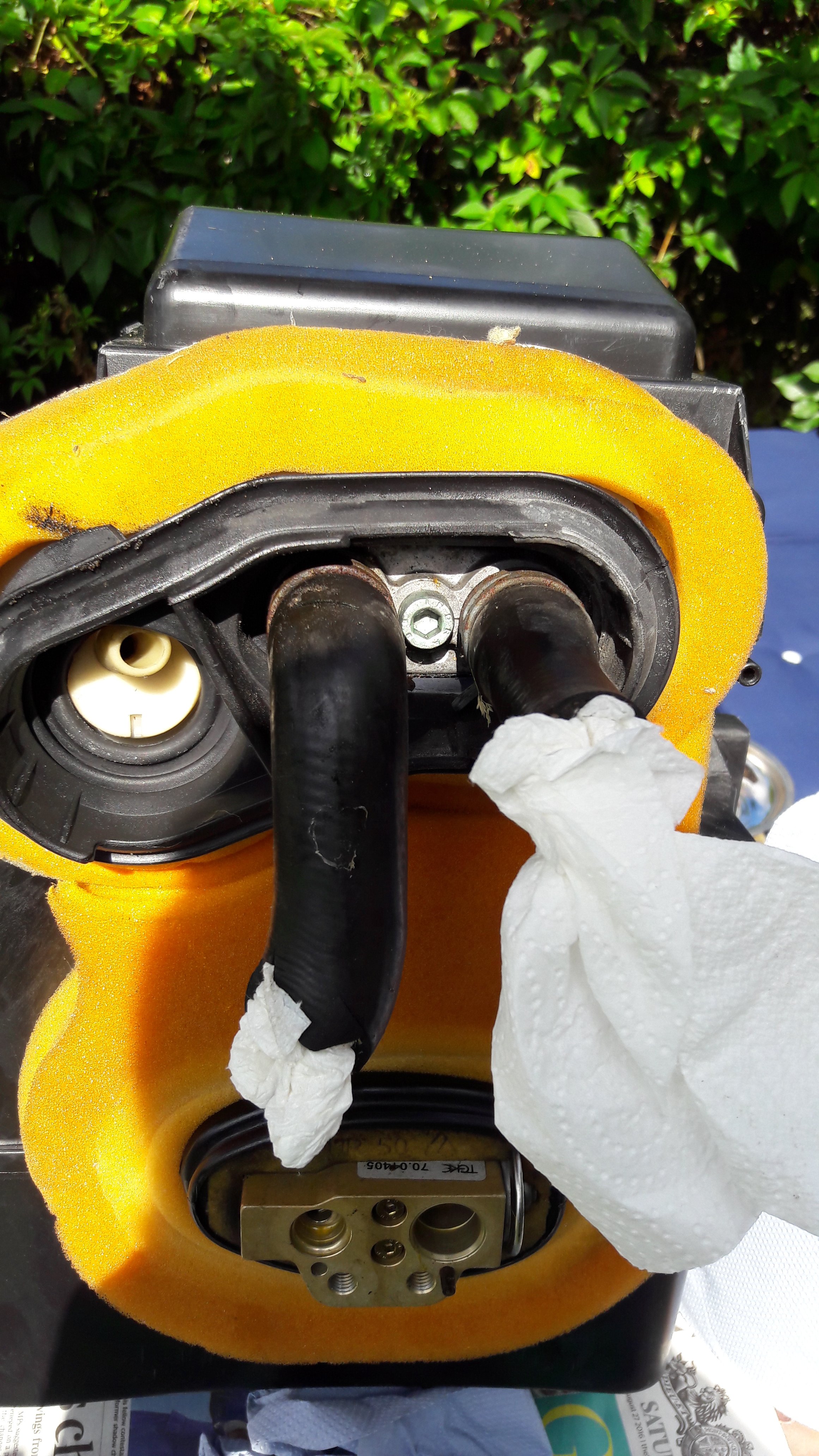

I got the rubber pipes from a 1.4 Fabia which was in the scrappie - Wino you were correct all the petrol ones I saw had rubber hoses - Im going piping up the matrix and will connect up the heater controls and see how it all goes !

         Well I got it all in with a good dose of Frankenstein ! I used a 120 reg bend off a Polo and a 90 reg bend from a petrol Fabia! I cut up the ally pipes to joint the sections ! It all worked well and despite a small leak on start-up which I sorted all is well
