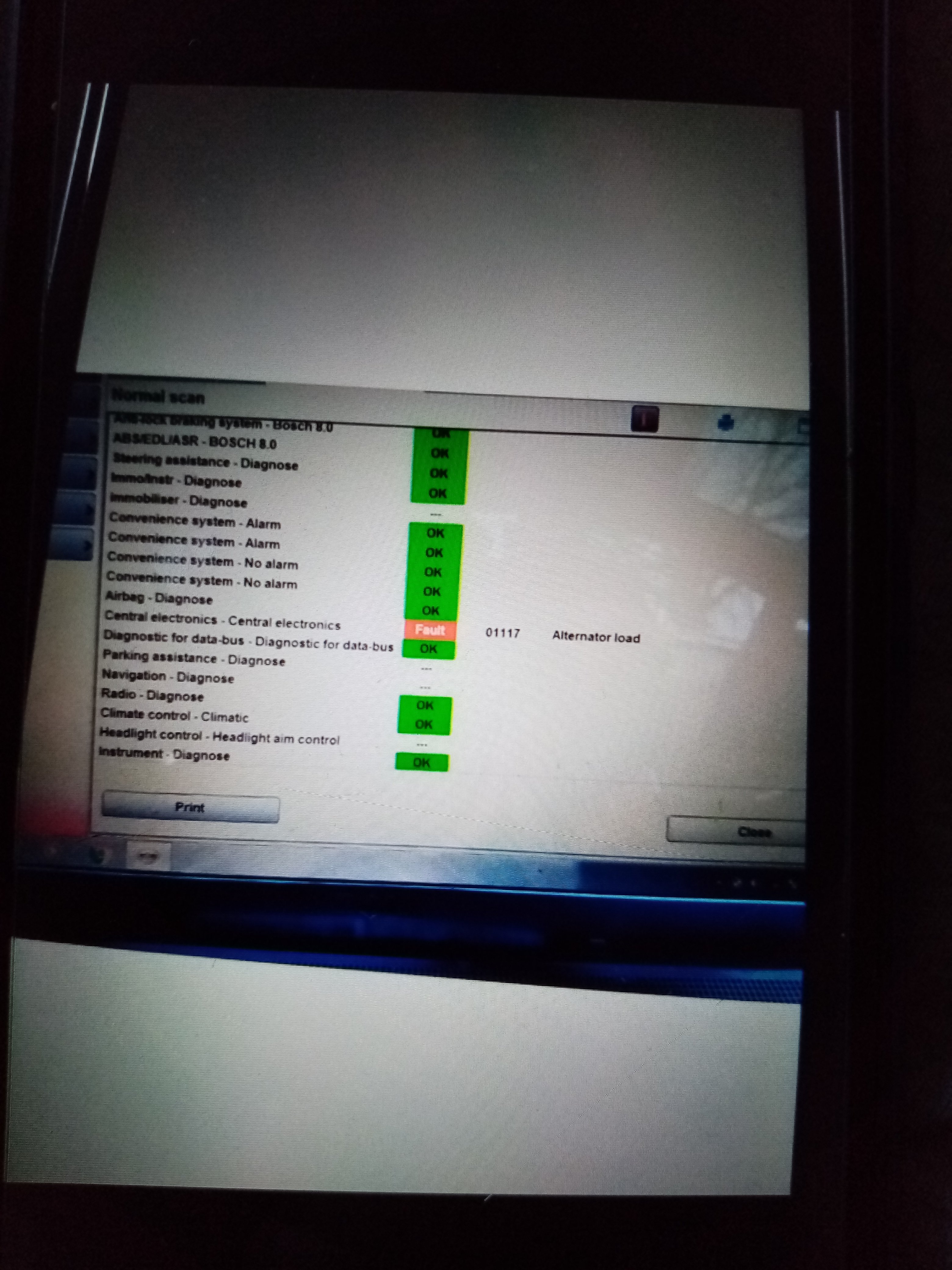

Hi
Fault code
01117 alternator load
What is means?

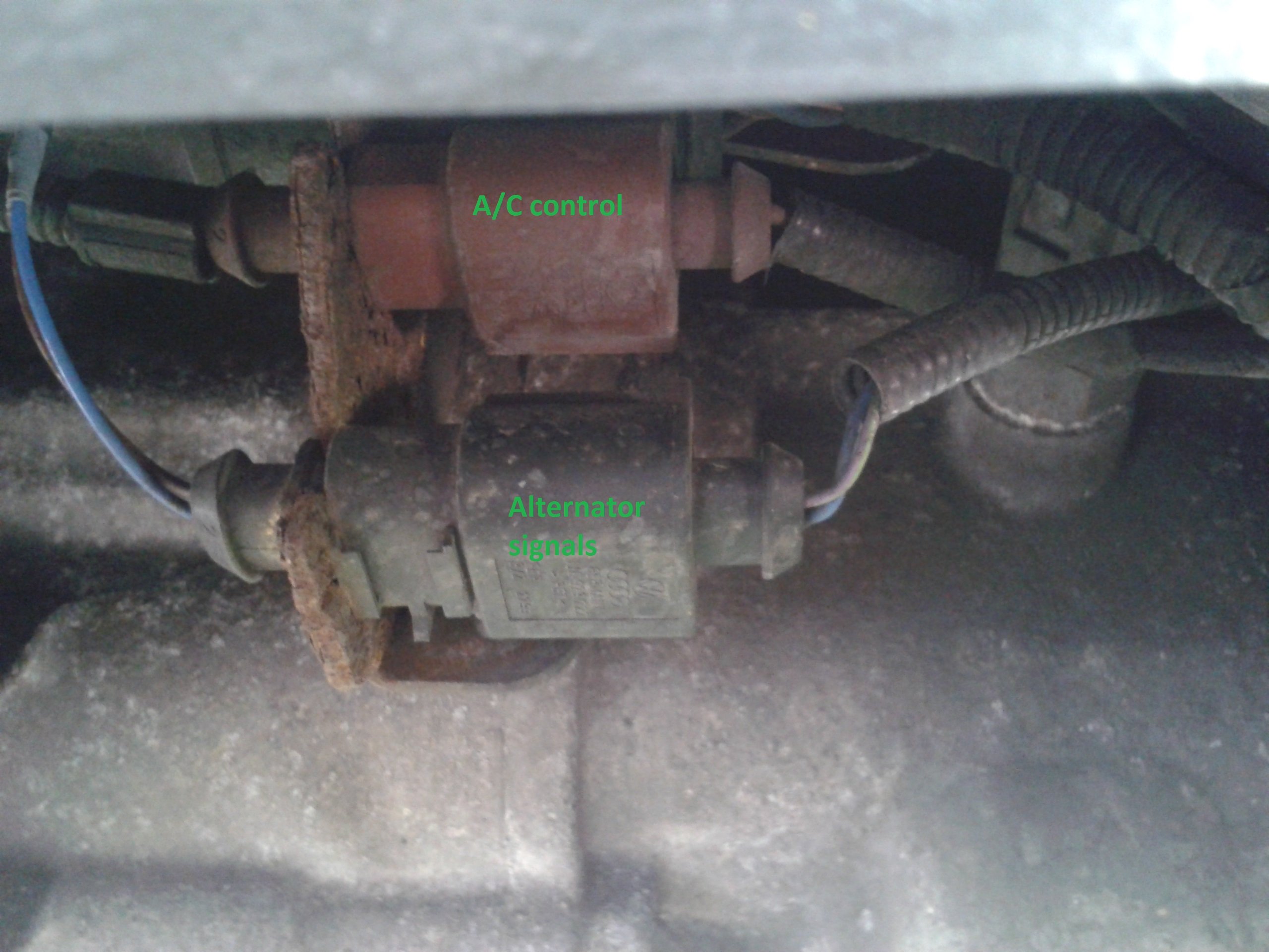

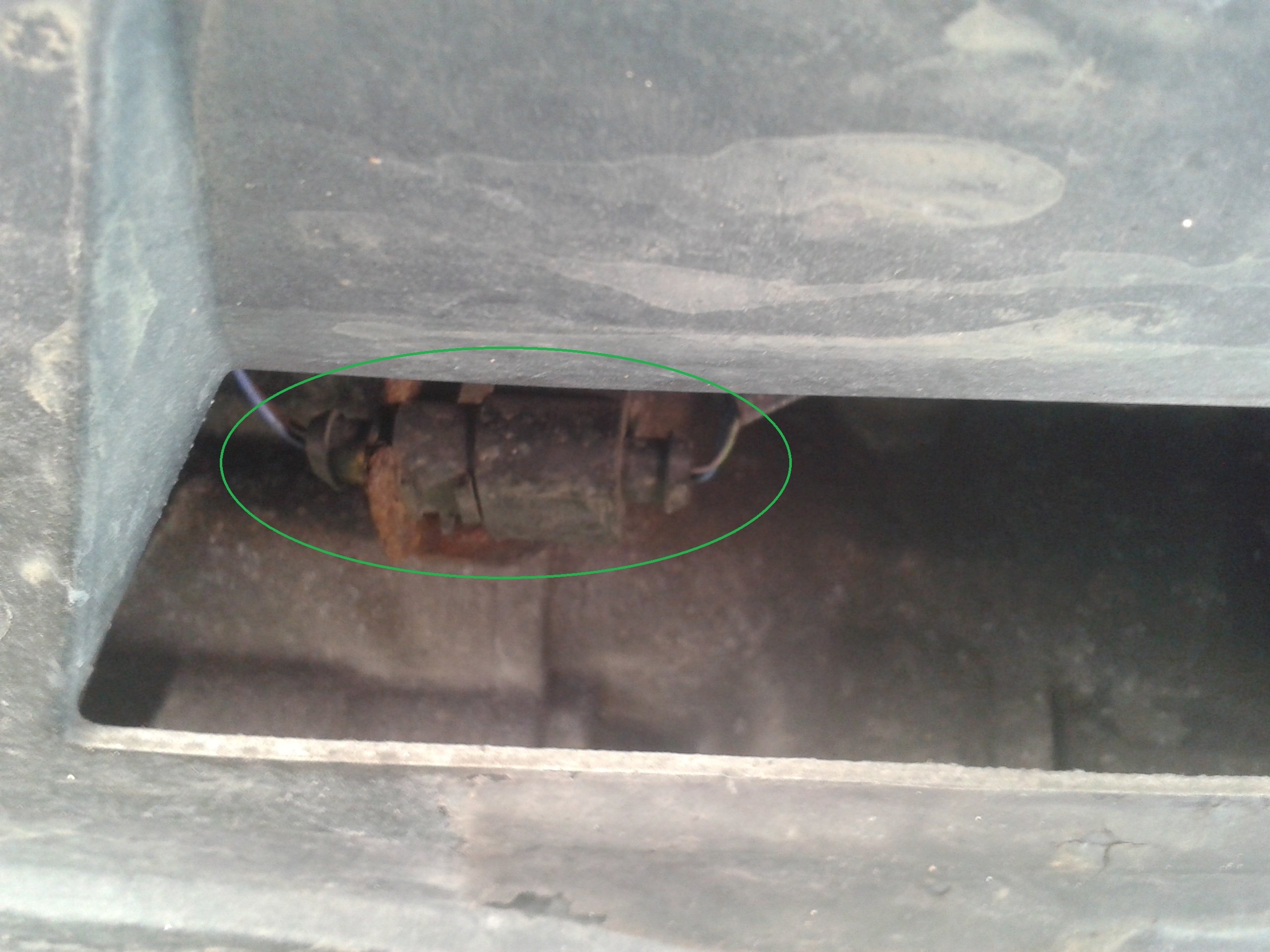

A wire (or two) has broken usually.  One of two thin ones that come from the alternator. They have a plug and socket junction at a bracket on the front of the gearbox. This is almost always where the wires break. Repair the breakages and the fault will be fixed.
On the alternator side of the connector pair they are brown and blue, on the other side the brown one becomes green/violet, the blue one continues as a blue.
Apart from the 01117 fault code coming up on that scan, is the car having any problems?

Check those wires again.

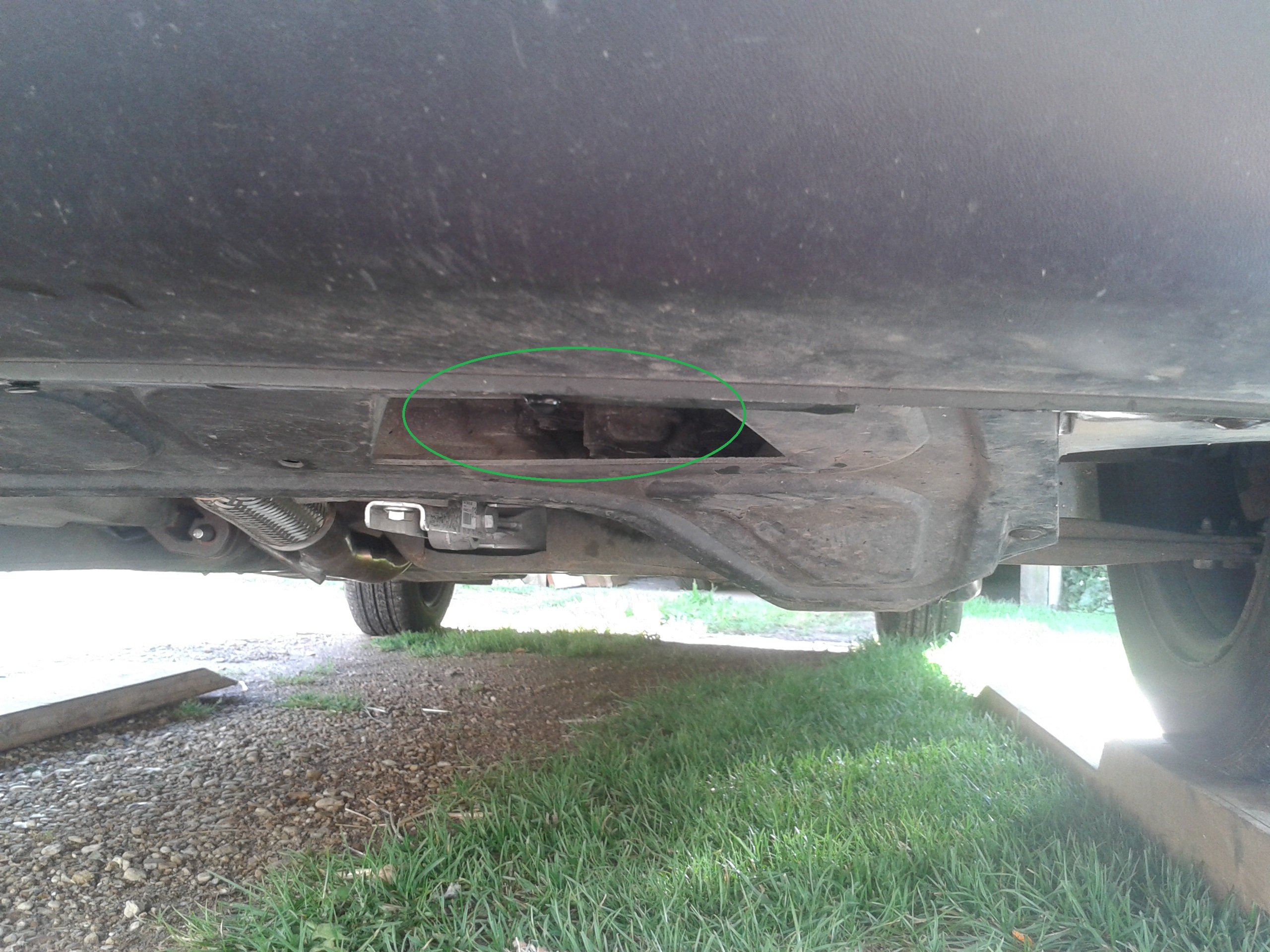

Some pictures here of where to look, in case I didn't make it clear before:

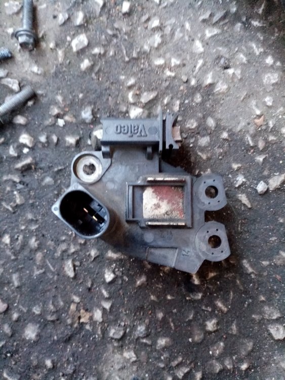

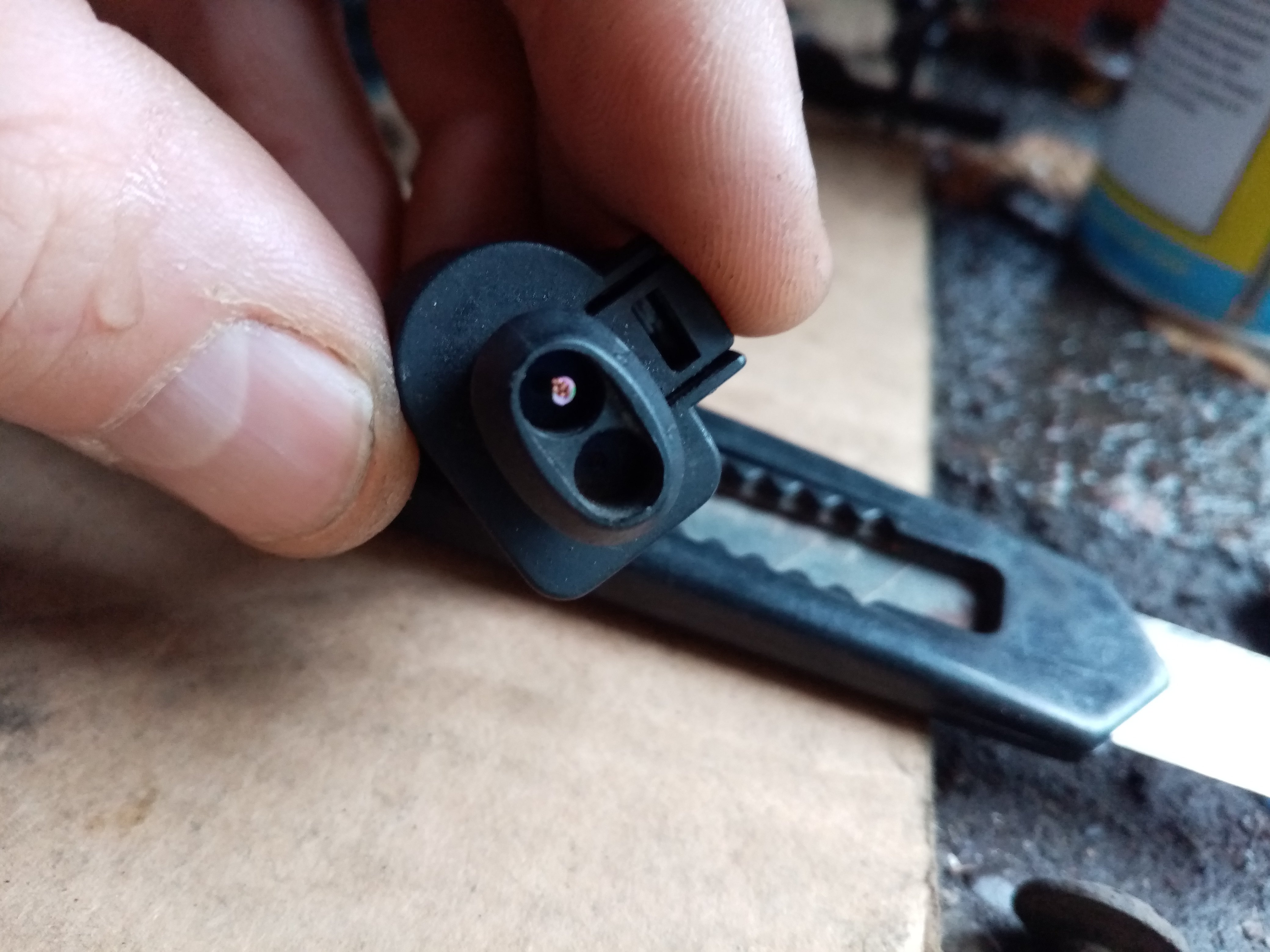

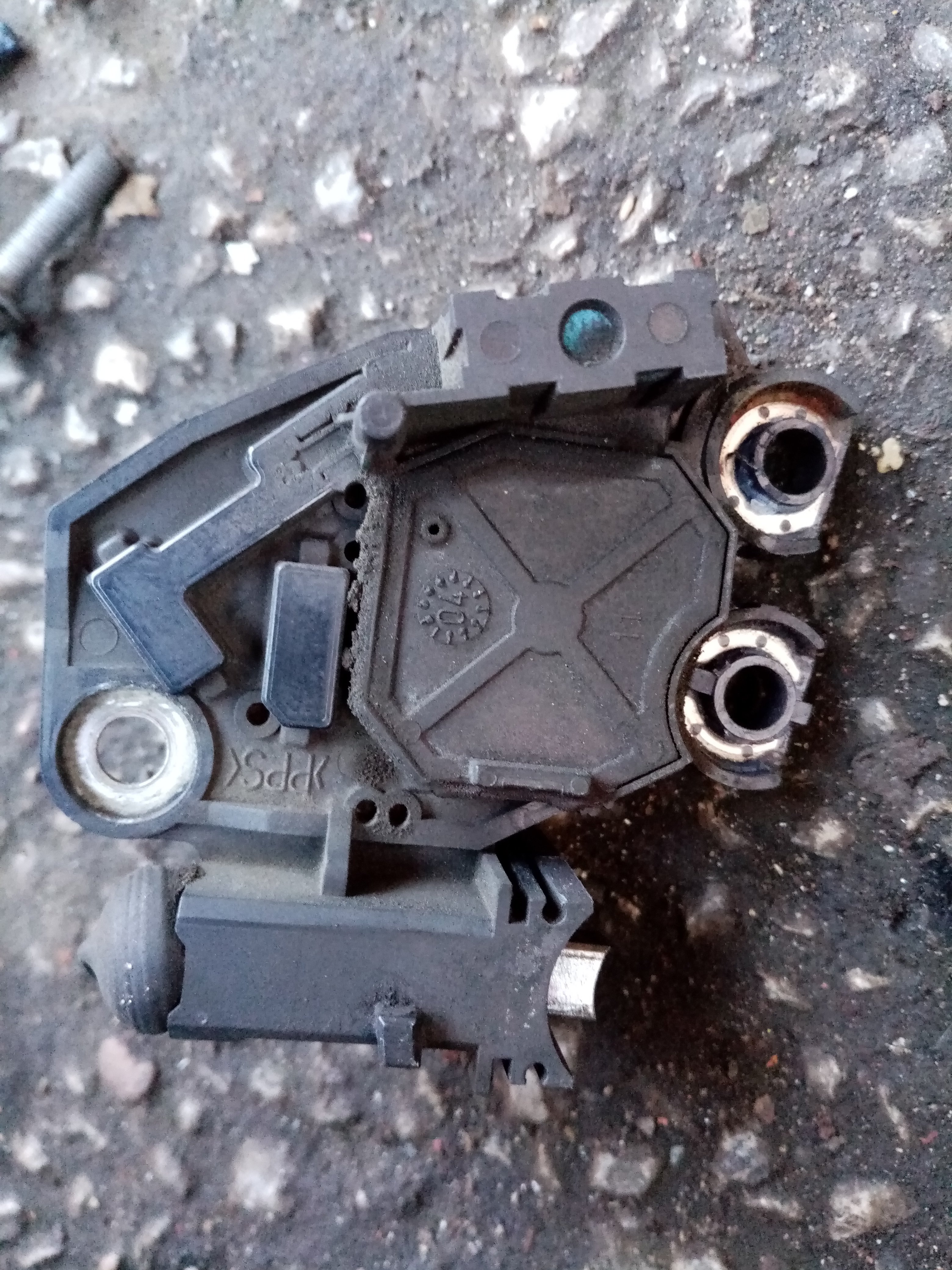

Oh, those brushes do look well worn. What do they measure in mm? How many miles has the car covered?
Yes brushes not very good, one long second short.
Mileage is 130000 miles done 1.2 petrol
I'm order new alternator yesterday, let you know when arriving and fixed.

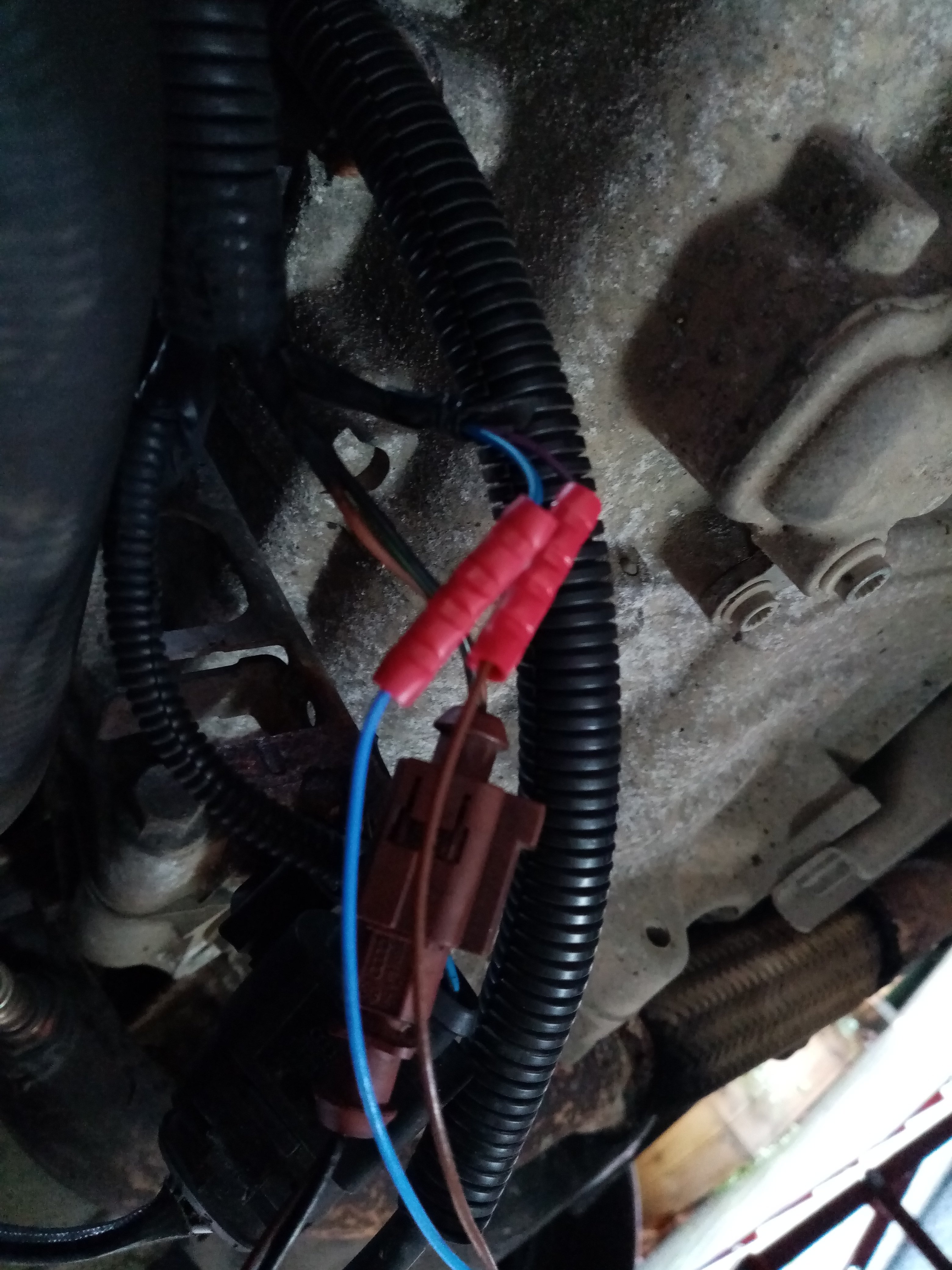

On 18/11/2019 at 16:12, Wino said:
Everything fixed, wire was broken, now is charging very good.
Only one problem left,front both windows stopped working.
^ Might want to waterproof those connections with self-amalgamating tape or something.
I behind isolated electrical tape
