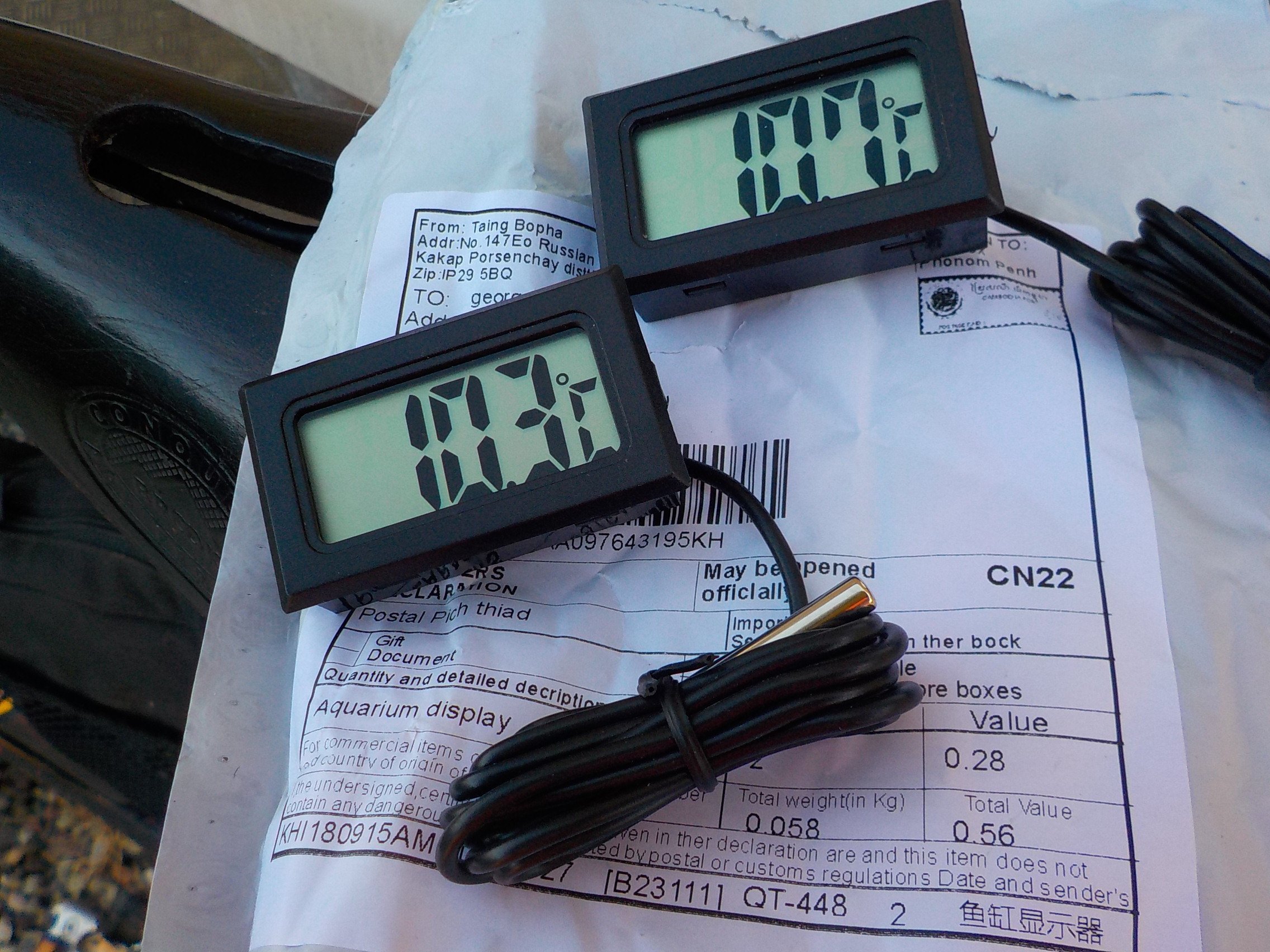

It is handy when you have a digital thermometer to just check tyre heat as some at tracks might do as well as the tyre pressures.

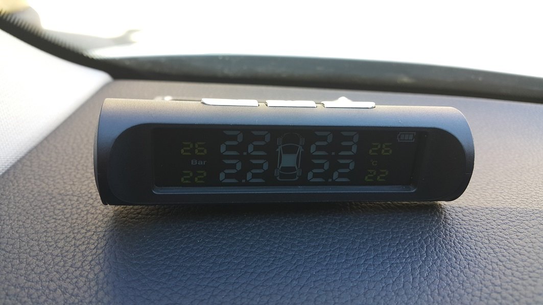

my disappointment,
why are you deny the device which can give such information with 1 minute refresh rate
white numbers are pressure in Bar, can be switched to Psi
yellow numbers are temperature in Celsius, can be switched to Fahrenheit
