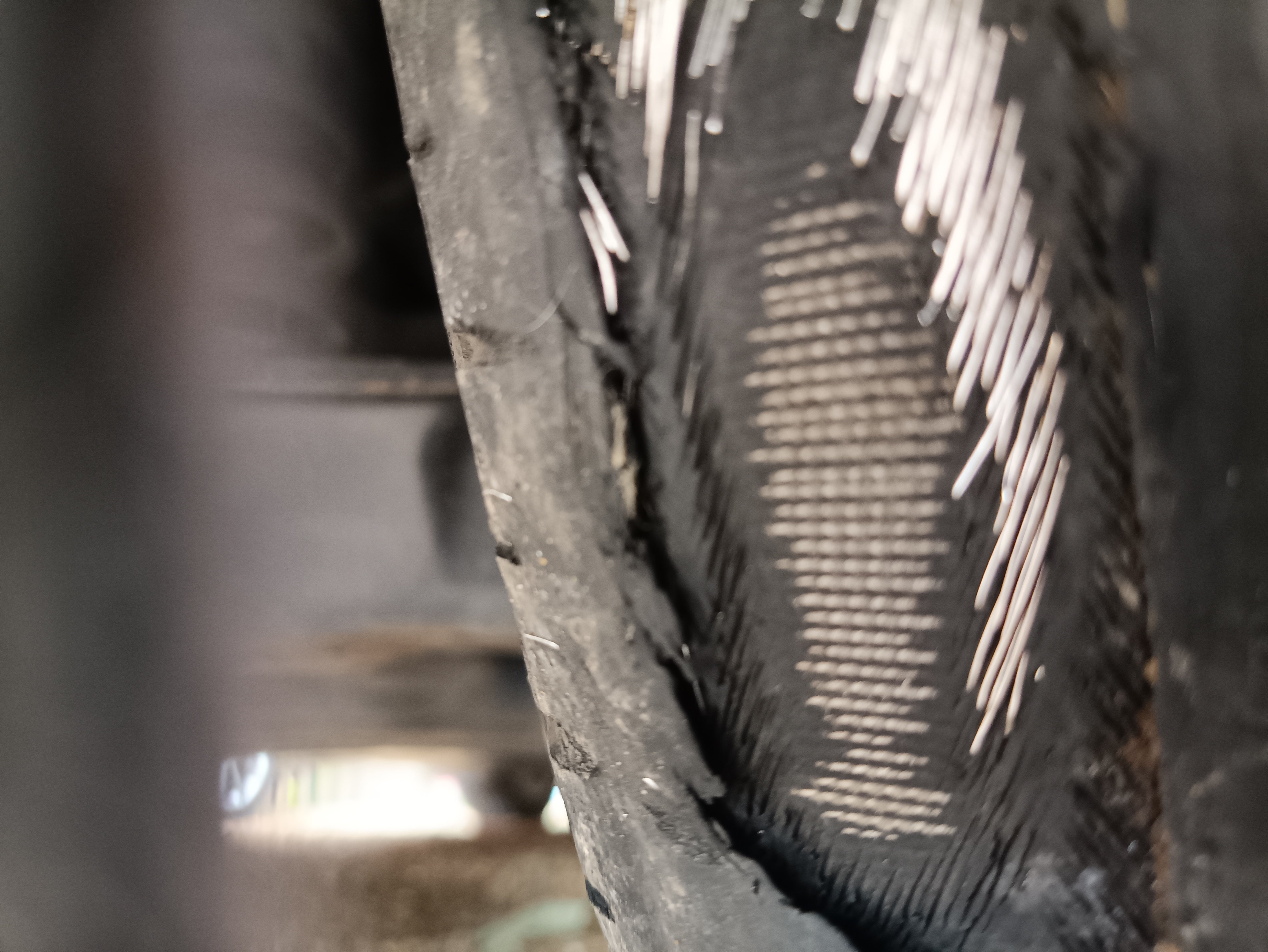

  3. I had a rhythmic noise on the motorway last week, sounded like a rear wheel so I had a poke and a prod and found nothing, then 3 days later (next use) after a short drive the tyre pressure indicator advised I had a problem, and boy did I... That's an original Pirelli (wk 2217) seems it's a common problem with 'older' tyres, tread base cracking allowing water ingress, water causes delamintation and a blister that fails pretty soon after, and then the carcass is exposed and you get this.... Tyre dealer had dozens of tyres with tread failure - some 2yrs old with 8mm tread, Pirelli and Avon well over-represented in his pile of similar failures! Moral is that when you check your tyres (and I do) make sure you do it with a raised wheel, or roll car forward half a rev to ensure you can feel all the tyre. MOT/service in July, no advisories (but tread at 4-5mm so think of changing was all), I check inside and outside edges front and rear frequently, tyres were checked before we set off on this journey from chester to norfolk. Towing the caravan on the original journey might have got really interesting if we'd gone much further.
