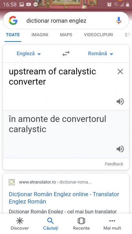

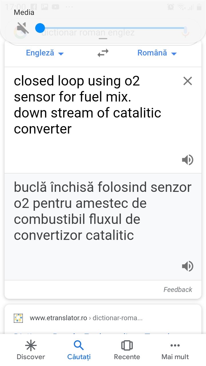

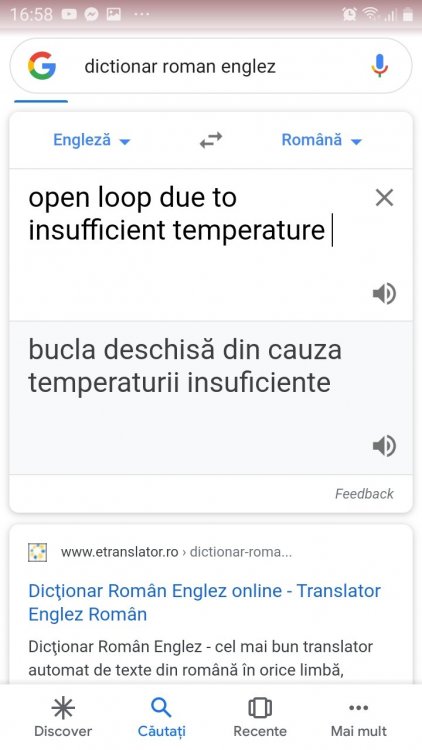

Screenshot_20191119-170041_Google.thumb.jpg.fbc10b1c5ee819a97ed056ec1d7ea4ae.jpgCan anyone to explayn me what these means?
Looks like your pre cat lambda sensor is kaput.
