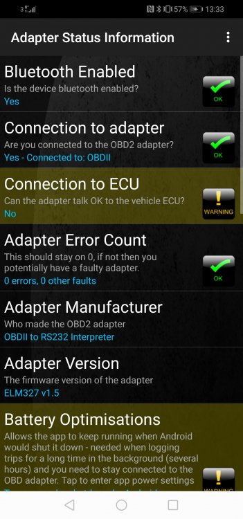

I bought a Bluetooth OBD 2 thingy, it connects to my phone using an app called Torque pro.
I can't can't get the thingy to talk to the car's computer.
The thingy plugs in the OBD2 socket and uses a language/protocol called elm327.
Is it possible that the car isn't OBD2 compatible despite having the same socket?

Which dongle thing did you buy?
According to the spec its compatible with all post 1996 petrol vehicles, so should work with your 2000.

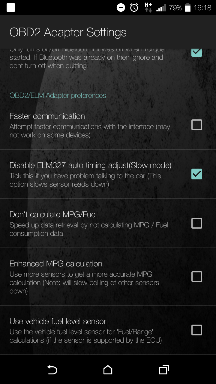

Its getting power etc if its connecting to Torque Pro, so it may be a setting on there?
Try ticking this box in the settings on Torque App
Thank you. I will go and have a closer look at the Torque settings and see if that sorts it out.
