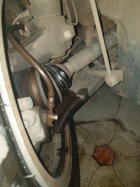

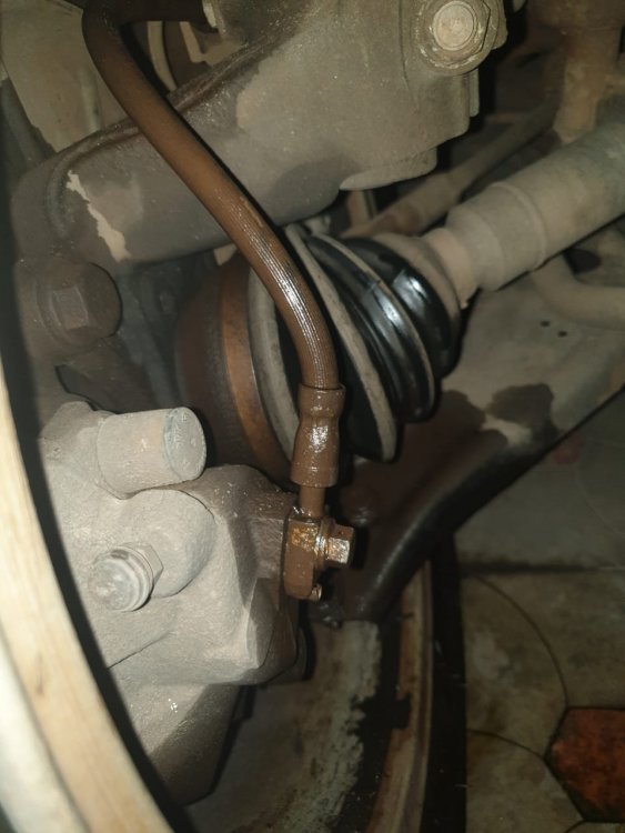

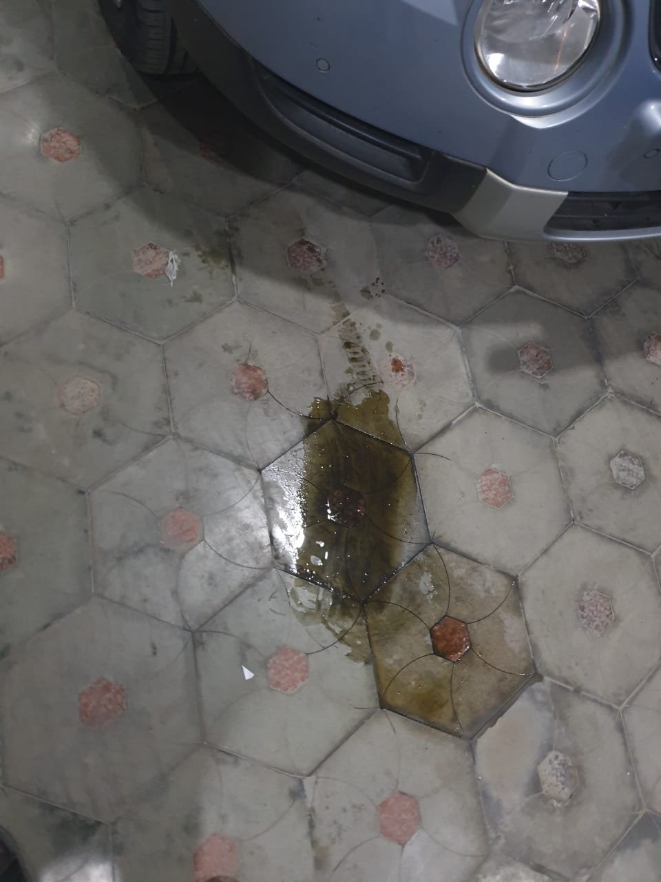

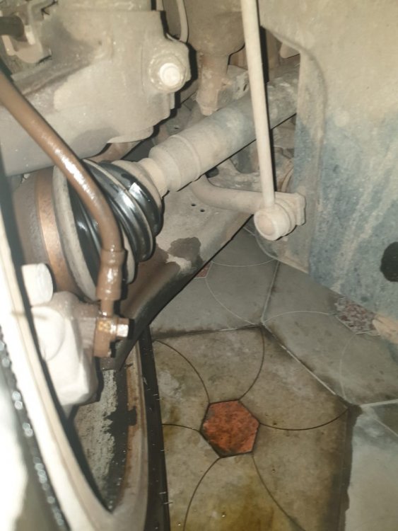

2012 Yeti pre FL 140 bhp 4x4. 60k kms in the odo. sunday exercise gone wrong. I was testing out hill hold control on yeti which i never used before. On an incline held brake  pedal hard a little more than usual. But only one drill.  HHC worked brilliant. After a few mins, vague brake pedal feel.  have brake fluid leak. error on dash - brake fluid check manual.
Whos the culprit? Is it master slave cylinder
Nothing to do with the master cylinder, but from those photos looks like a fault either with the pipe at that wheel or the union into the brake cylinder.
