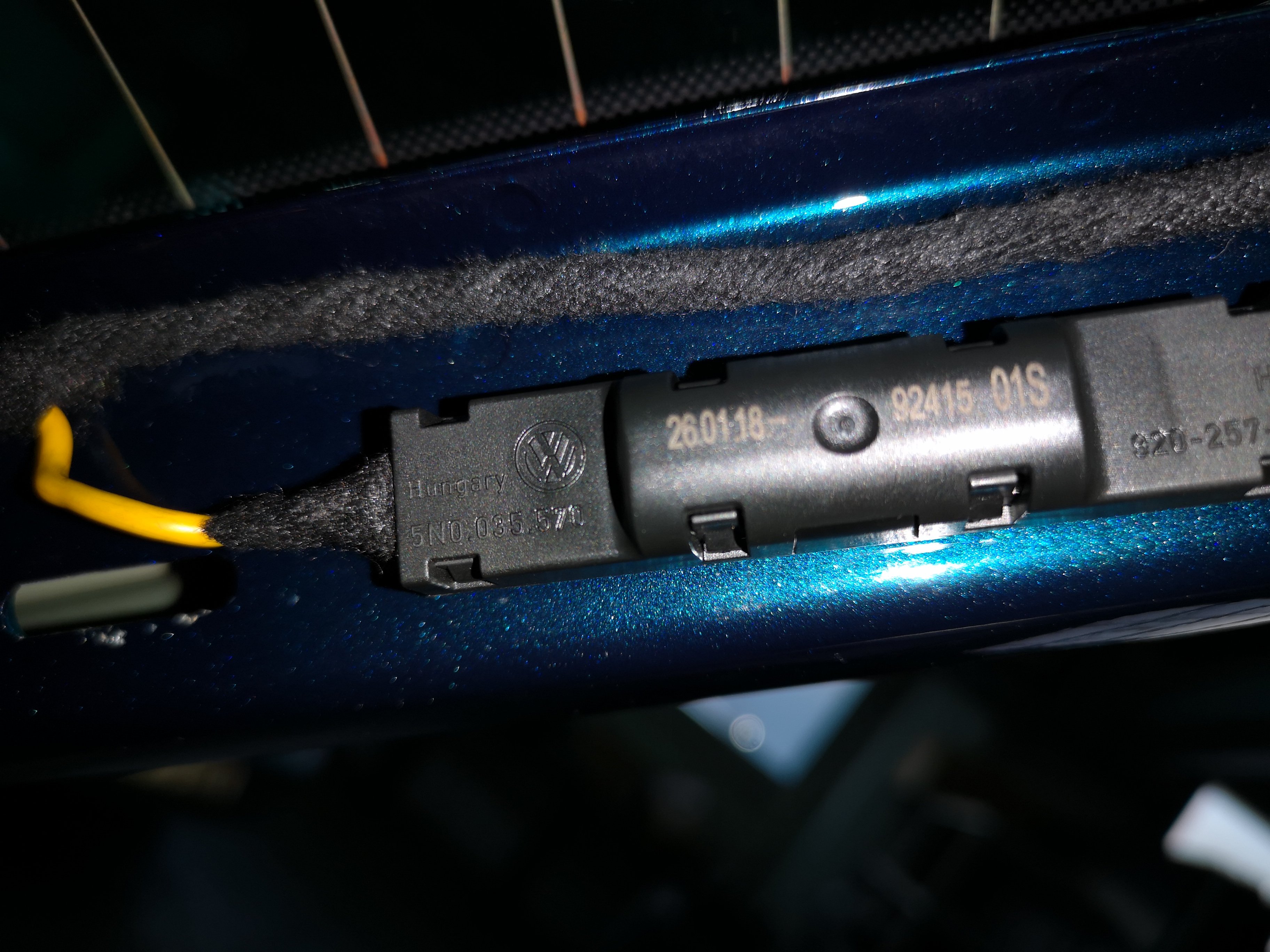

i have the same problem and to the workshop finnd the brown wire melt on the filter frequence radio 5N0035570, i fixed but the brown wire is very hot when the heat are working, that i think it is a problem, i'm soure you have the same problem

i fixed, i make another wire minus from anotherth place problem is with the wire of minus hwo are in the frequency modul, there the wire is mealt
Hi @catalingrigorescu, could you please tell where is that frequency modul that you are saying that melted minus wire?
is in the back of the platics it cover the rear window in the left side, you will find there  a mealt wire i put a photo
sorry in the right side there is the minus in the left side is plus
