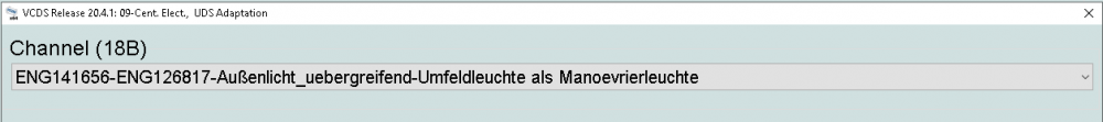

I fixed this problem after few months, it was due wrong activation of maneuvering lights
