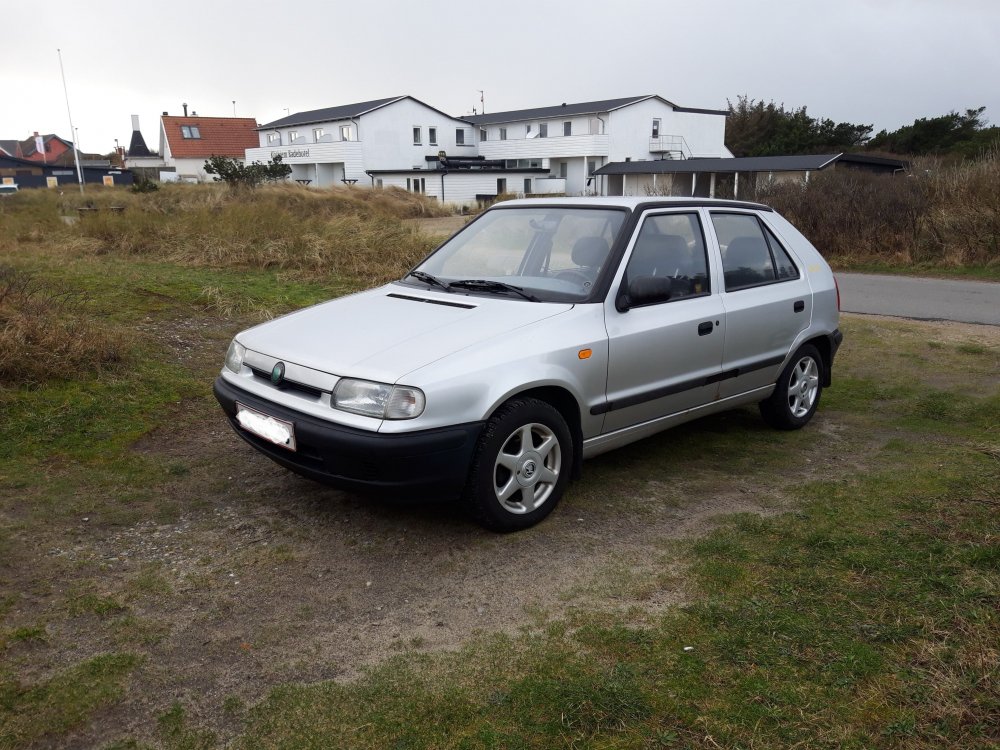

Thanks in advance, I've attached a photo of my old trust car for good luck.
