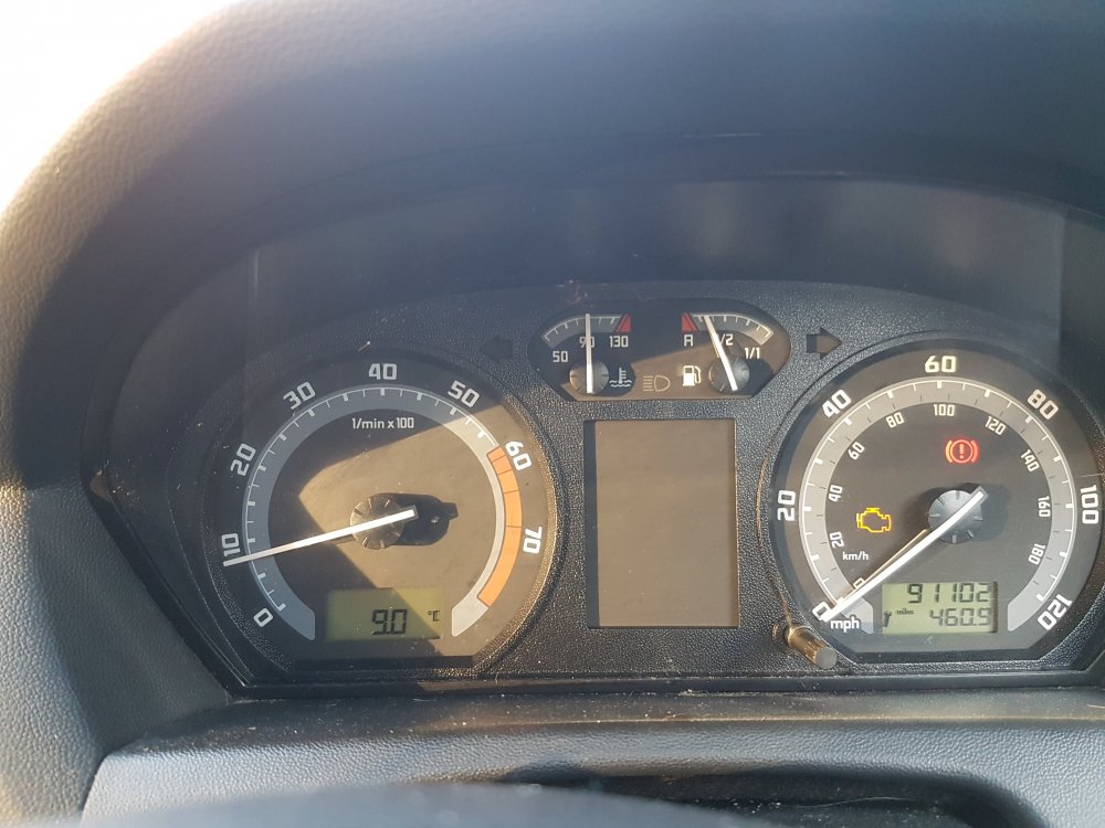

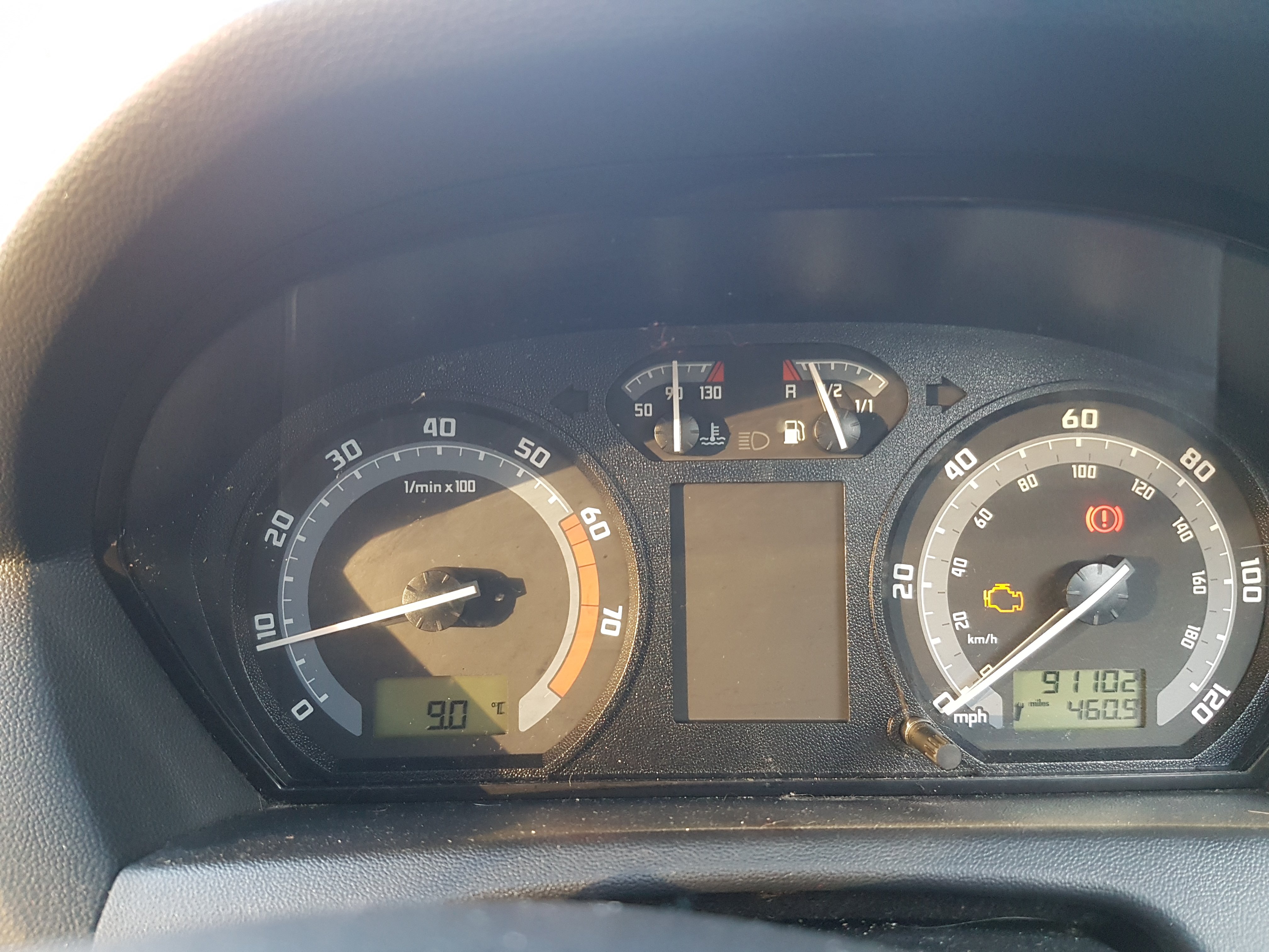

Further investigations show car runs lumpy.almost as if off on a cylinder only when it warms up.
Temp gauge stays in middle.
Doesnt appear to overheat

Probably a failing pencil coil pack. Common fault and cheaply fixed if you can identify which coil is at fault.  Have a look at the top of all three to see if there's any visual sign of failure, like bulging, burnt looking lumps. Could do with getting it plugged in for a fault code read really.
