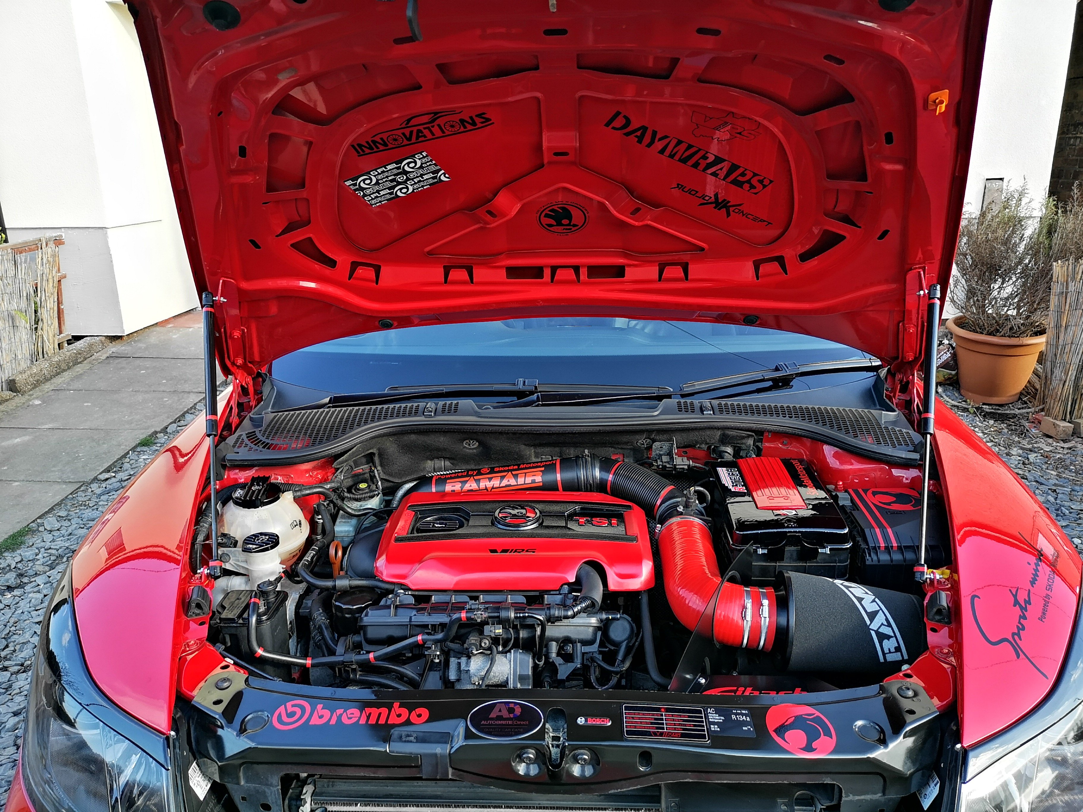

Easy to fit, myself and many others have opted for the Ramair jetstream induction kit :)
My BHP with it and a milltek sports exhaust was 205bhp. Up 8bhp from the stock 197bhp. But I can't say how much was induction kit and how much was exhaust.
