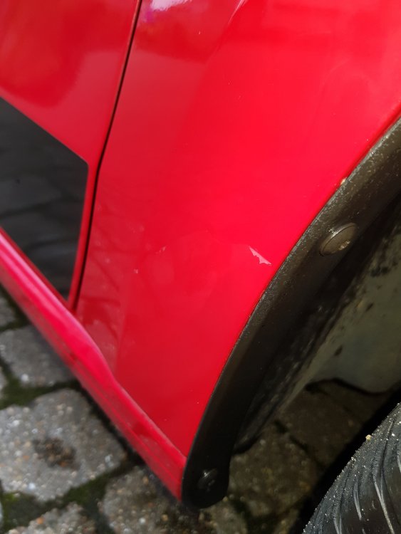

Hello all, I took my car to the local hand car wash and when I got it home noticed around the drivers side front wheel arch the lacquer /clear coat had peeled off. On this discovery I took my car back to the car wash but they told me its caused by stone chips and happens on red cars. After threating to not come back they agreed to fix it for me so I've giving them a week to get something sorted before I go get a quote myself. Has anyone had a problem like this before?

By the lacquer in the pic it looks like it might not be the original paint.

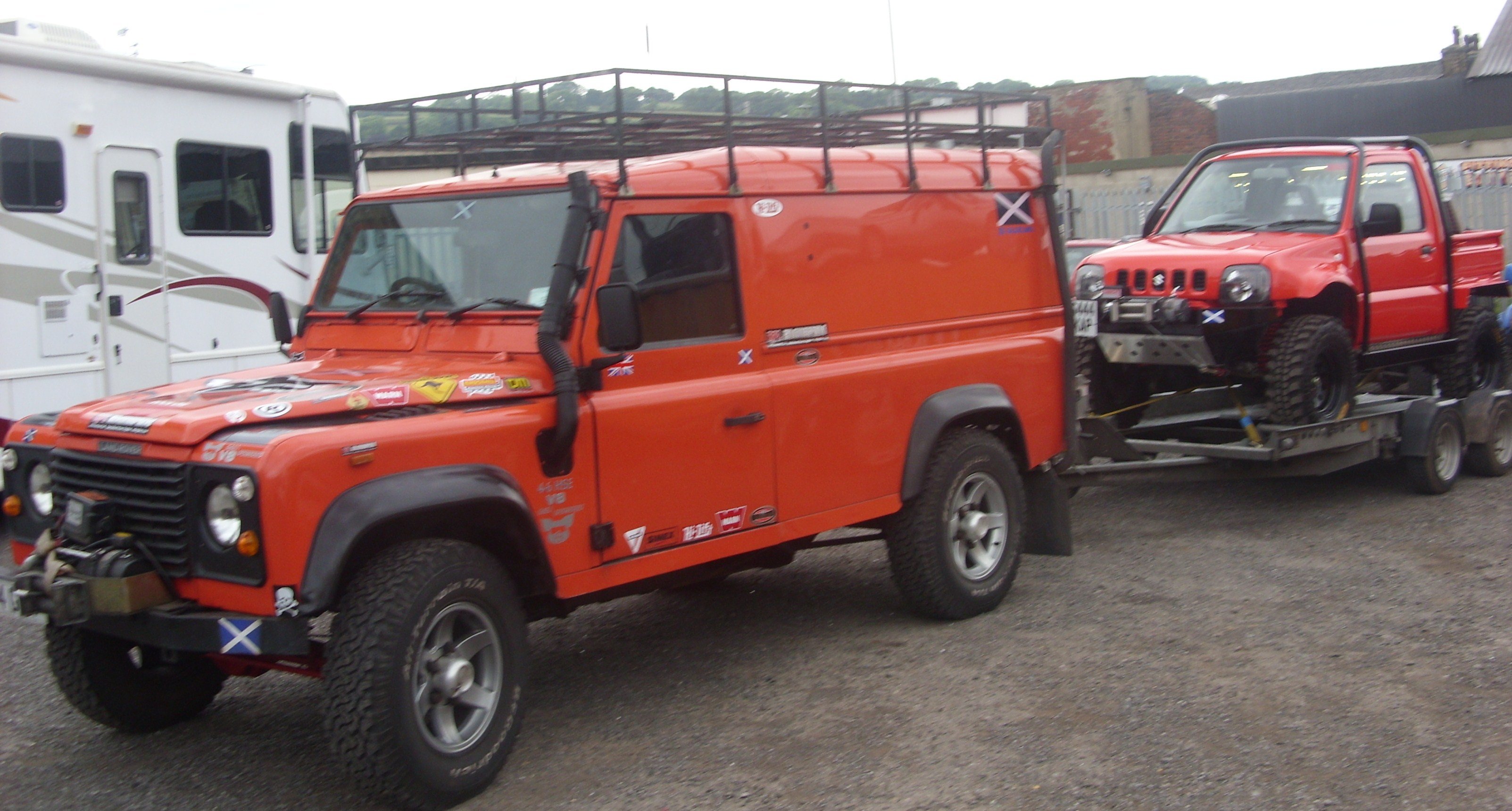

(My 110 Landy never faded and my Jimny faded badly. just the difference in the pigment of the paint used.)

To me, from the photo provided, it doesn't look like peeling lacquer. It looks as though a pressure washer has lifted the clear plastic film that is used to prevent stone chips around the wheels. It's an adhesive cutout made from this sort of thing:
https://www.3m.co.uk/3M/en_GB/car-wrapping-uk/paint-protection/
Run a finger nail gently along where it is lifting, and if it continues to lift in a straight line, then I'm certain it's not the lacquer.
Dealer should be able to source a replacement for you to stick on.
