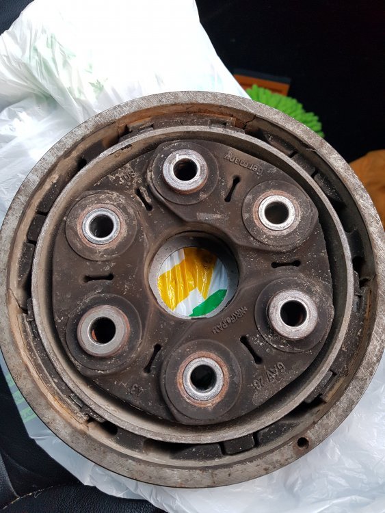

Hi - I need your help. The rear bush on my tail shaft is cracking up. Skoda Australia want $1,000 for the part. Does anyone know where I can source one of these internationally and/or the part number for it. I drive a 2014 2.0 diesel 4x4 auto.

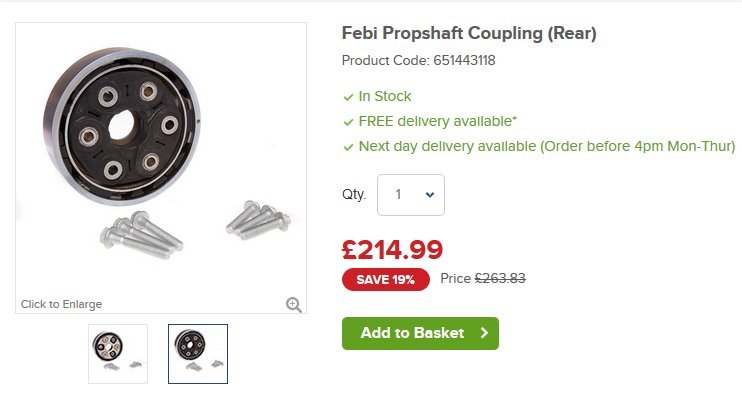

Is this the one?
I haven’t looked at it myself. My mechanic told me about it. I will try to get a photo of it. He said it had a metal outer and six hole. Three in the rubber and three in metal. So maybe not the same as that. Is that the one closest to the diff?
Hi Urrell the mechanic confirmed that is what my one looks like. He gave me a part number but nothing comes up when I search for it. 1K0512307. (Which seems short for a Skoda number)
