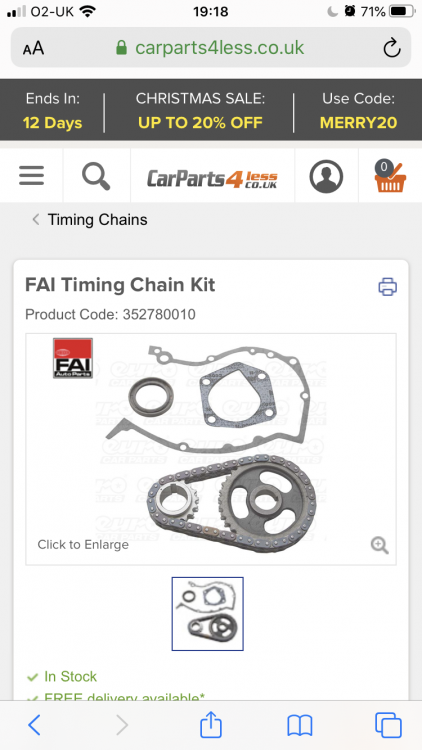

Whilst I will get a quote from the skoda dealer in the mean time is this one ok, or don’t touch with a barge pole!
When it comes to the timing chain, a genuine one is the best bet.
