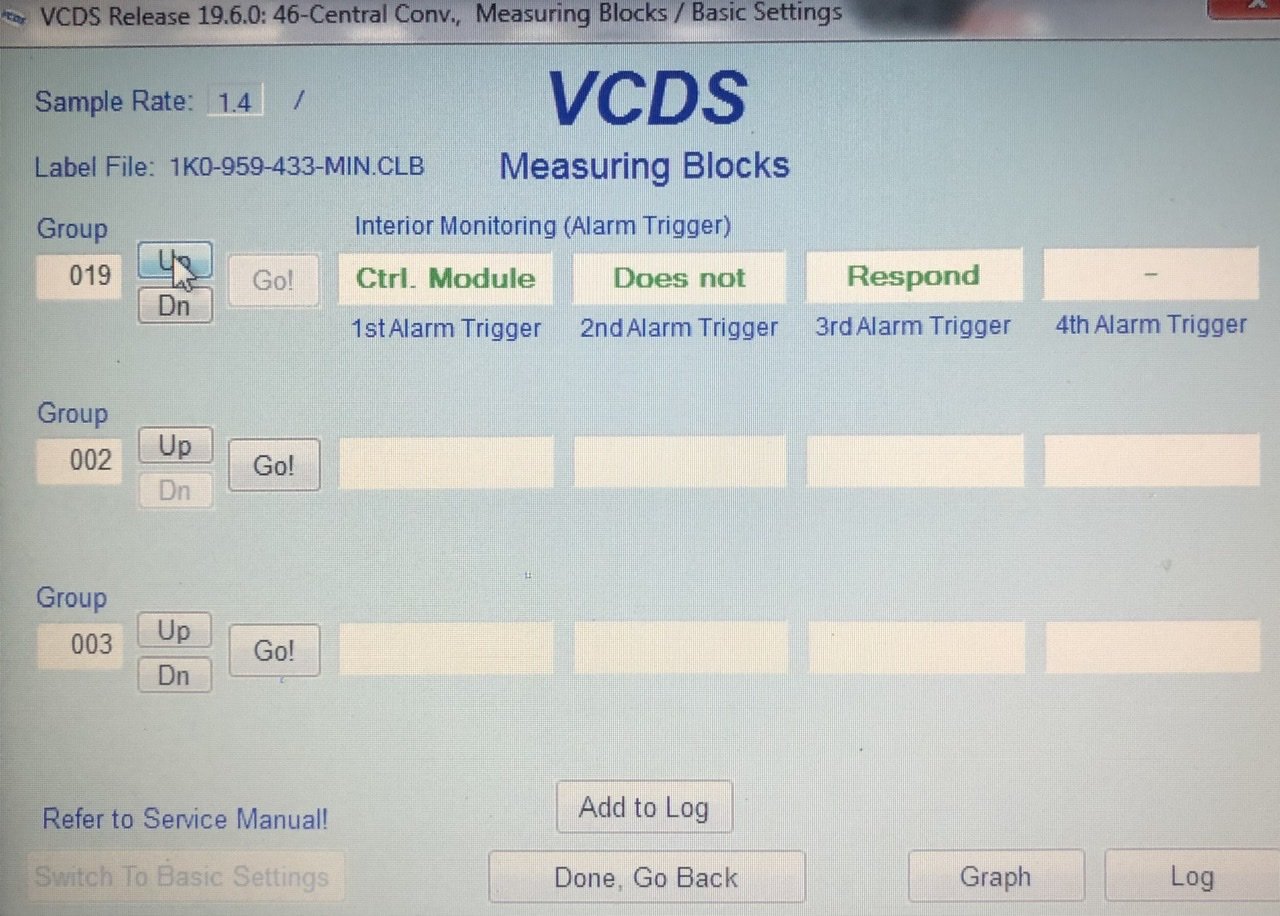

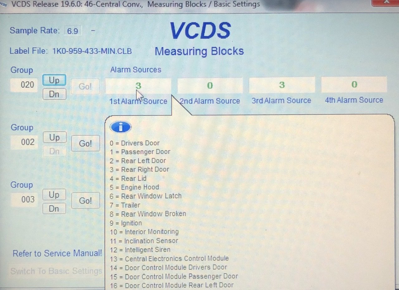

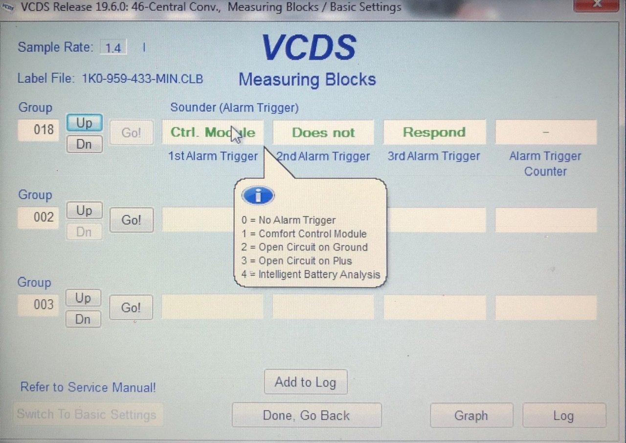

as I mentioned above, control module 46, then onto meas values.
type 018 into group and press enter, this will give you sounder triggers, I currently have a sounder fault so maybe why I’m getting the does not respond message.
Press up or type 019 and enter, I’ve also got an interior monitoring fault too but I’ve got to check if I even have them first 🤣
Press up again or 020 and enter, then we get onto alarm sources, these are the last 4 alarm sources, so for me it’s been “rear right door” and “drivers door” one after another.

Finally got to look at my alarm problem with vcds.
              Address 46: Central Conv.  (1K0 959 433 BT)
15:20:34 Group 019: Interior Monitoring (Alarm Trigger)
  129  1st Alarm Trigger
  129  2nd Alarm Trigger
  129  3rd Alarm Trigger
  129  4th Alarm Trigger
15:20:34 Group 018: Sounder (Alarm Trigger)
  1.0  1st Alarm Trigger
  1.0  2nd Alarm Trigger
  1.0  3rd Alarm Trigger
  6.0  Alarm Trigger Counter
15:20:54 Group 020: Alarm Sources
  13  1st Alarm Source
  13  2nd Alarm Source
  13  3rd Alarm Source
  13  4th Alarm Source
So as you can see a bit confusing. Group 19 Interior alarm gives 129 when it should be 0,1,2,3 so no idea what 129 means.
Group 18 Sound alarm trigger gives 1.0 which is the comfort control module.
Group 20 alarm sources gives 13 which is central electronics control module.
I have looked at the repair manuals and can only find one module which is the "convenience electric central control unit" J393 behind the dash. I believe the error codes must all refer to this just giving it different names. If anyone can confirm this I would be grateful.

I’d be inclined to go onto the rosstech forum and ask what is classified as a C.E.M trigger, it’s not clear what it means, is it being woken up? Is it a tamper signal? someone on the forum will be able to hopefully answer the question taking the guesswork away 👍
