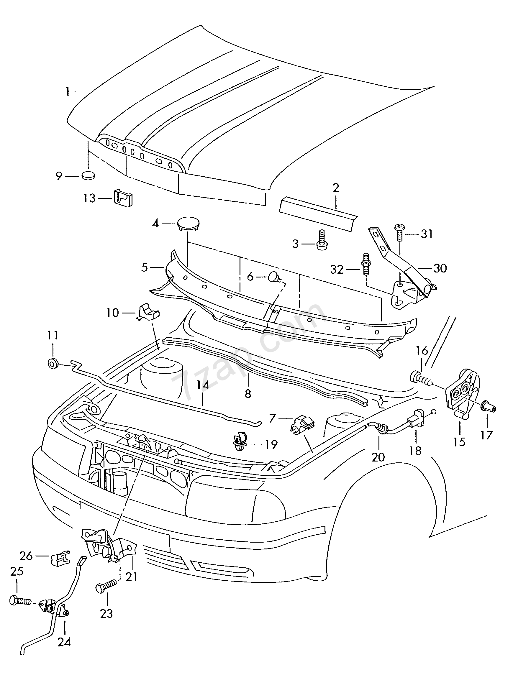

Can't help you with piccies, sorry. but the parts explosion below may help you make some sense of things.  Clicky for the full catalogue picture here.
Well, I find the lever (part 24)  less than positive in operation.

Hello, success at last!  I shone a small torch through the grille and managed to find and release the hook which was stopping the bonnet opening fully.  It was quite tricky as the with the bonnet raised enough to get my arm through the gap below the grille the hook was fully through the U-bolt under the bonnet and didn't want to move, however with some judicious twisting of the bonnet (and a slightly sore arm!) I managed to persuade the hook out of the U-bolt.
I then discovered that the top end of the release lever (24 in StickMicky's diagram) had managed to get itself on the wrong side of the protrusion at the front of the hook, so it was just flopping about in mid-air when I moved the lower end.  I moved it back to the correct side and bent the front of the cross-member (where the lever pivots) upwards slightly to prevent the same thing happening again.  It works now so fingers crossed.  Now to fix the starter motor ... Thanks again for the assistance.
