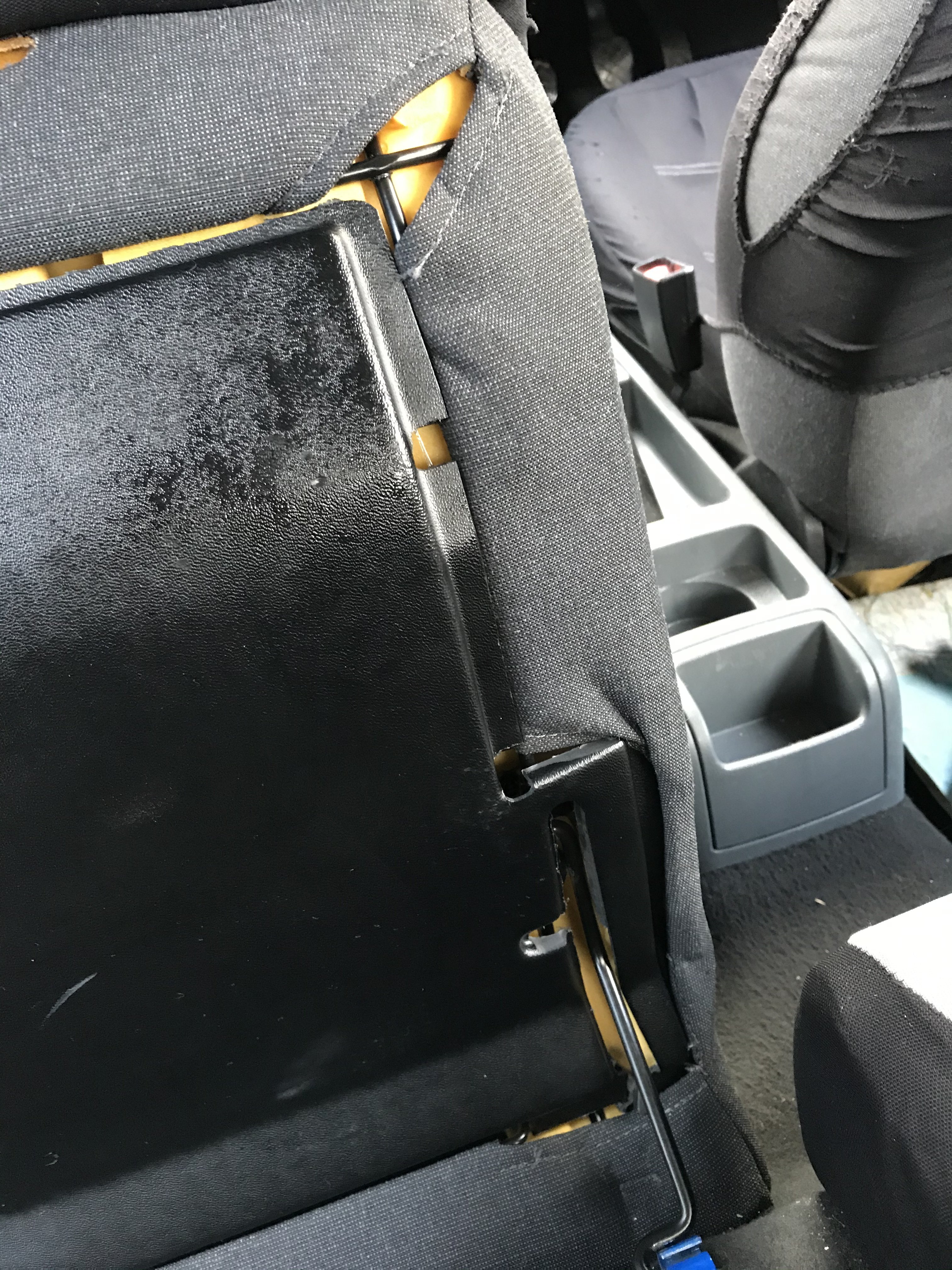

Bit of a strange request, but can someone take a photo of the plastic trim underneath the rear passenger side seat... photo of mine below.
my car has been making a loud/annoying rattle from the rear passenger side for ages. I thought it was the parcel shelf bracket. Replaced that today, which appears to have made some difference, but still some noise there.
ive taken the back seat up, and noticed the plastic trim underneath the seat isn’t attached to the foam/tucked under the seat on one half. Just wondered if anyone can send a photo of theirs to see if mine is normal or broken!

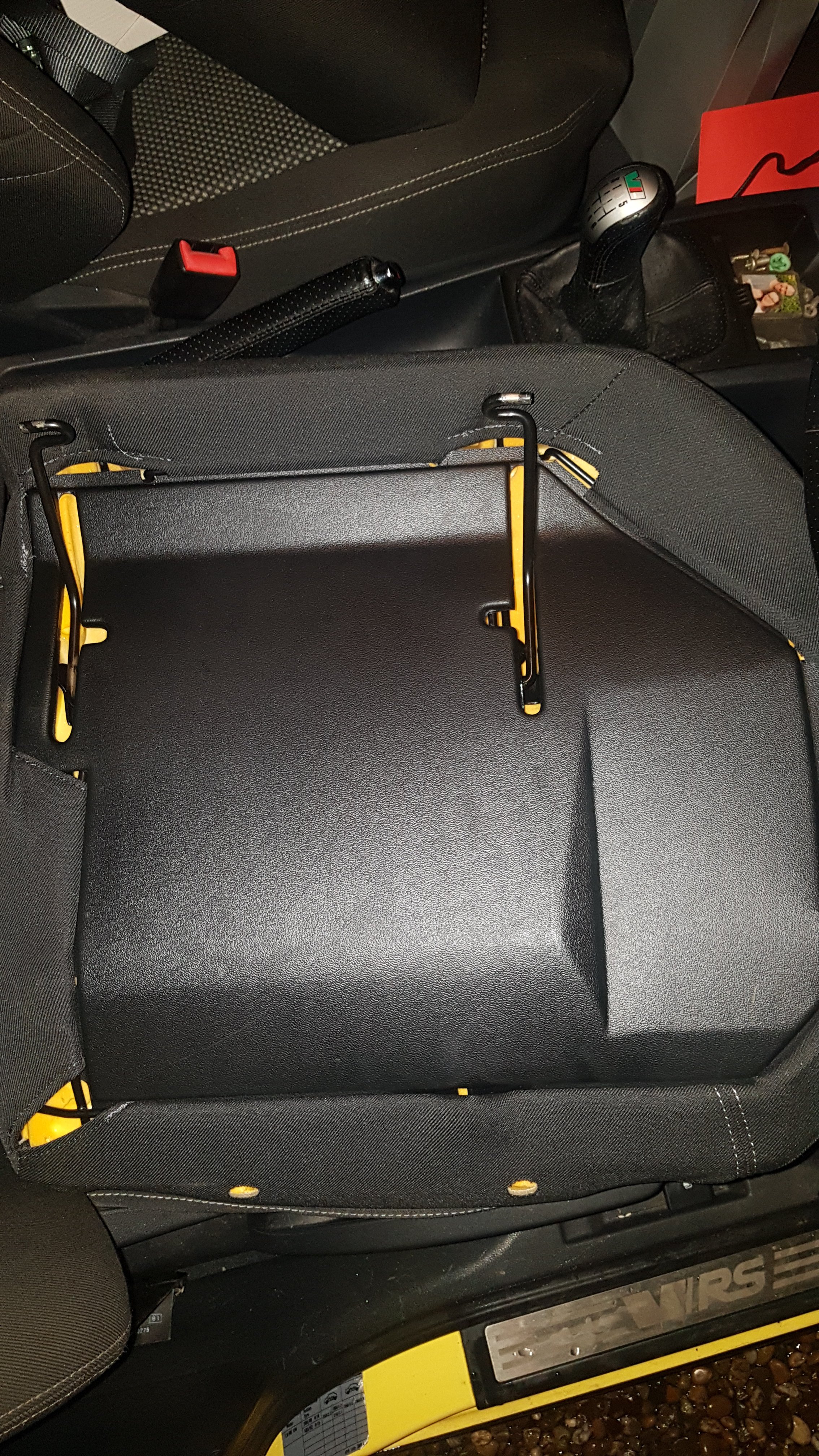

Here you go
Thanks... looks considerably smarter than mine!
i tried gluing it on to the foam... the rattling appears to have stopped!

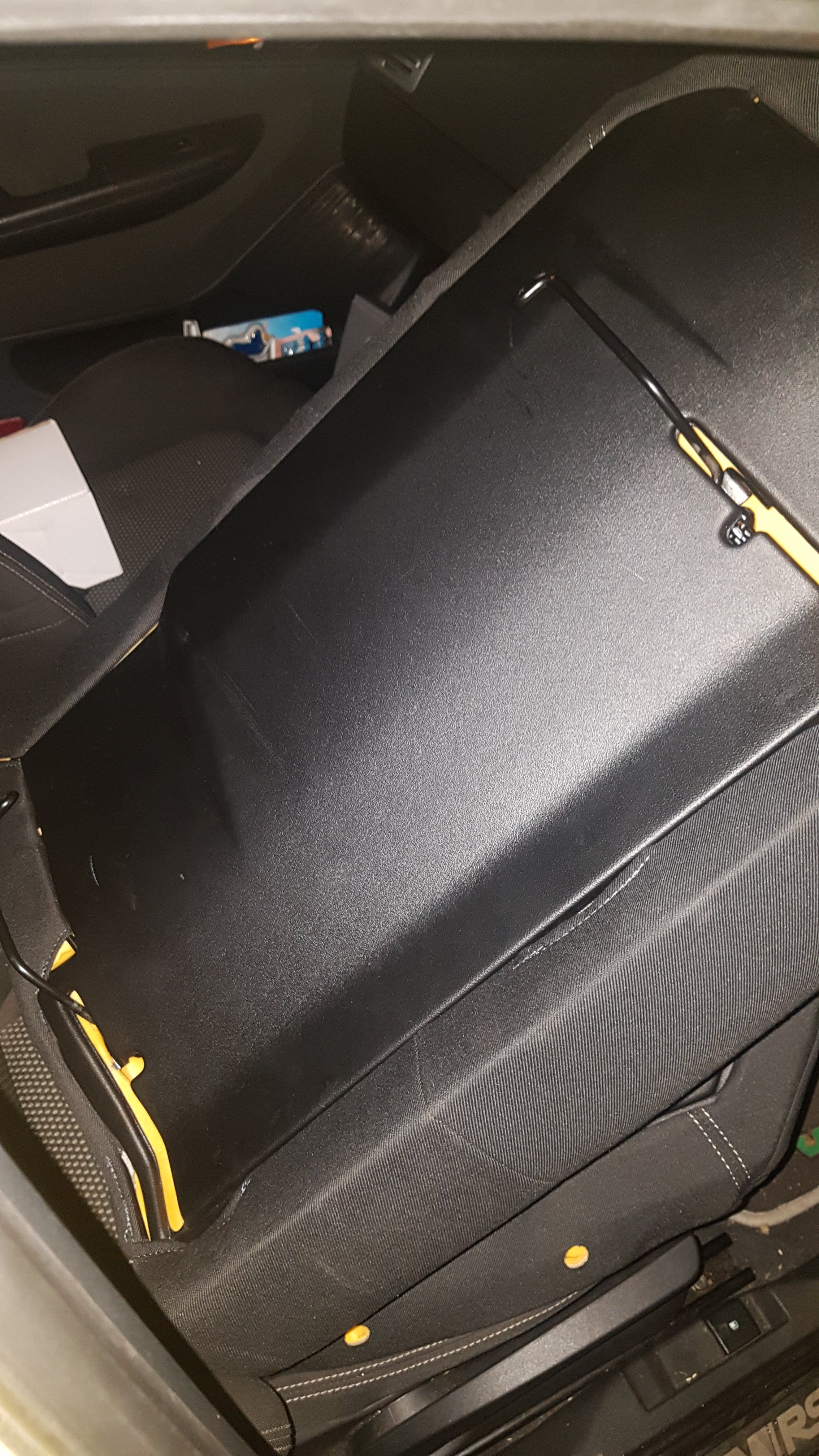

I bought mine new from the dealer in 2005. Those plastic covers were loose under the rear seats. Not unusual to find them like that apparently.....
They have snapped in various places as well... The one above is currently bodged up with a bit cut out of an old rubber car mat
Advice given to me was clip them in yourself or throw them in the bin. All they do is keep the seat squabs looking nice if you've flipped the rear seats down.
