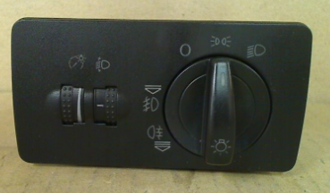

Skoda, and most other VAG brands used to illustrate on the switch itself the need to pull the knob out from the dash to activate the foglights, alas it was lost long ago, much like the green dipped headlight icon in the dash binnacle to tell you your headlights were on.
Progress apparently!
If our Scala had fog light symbols like that, I’d have been able to work out how to turn on the fog lights without resorting to the manual!

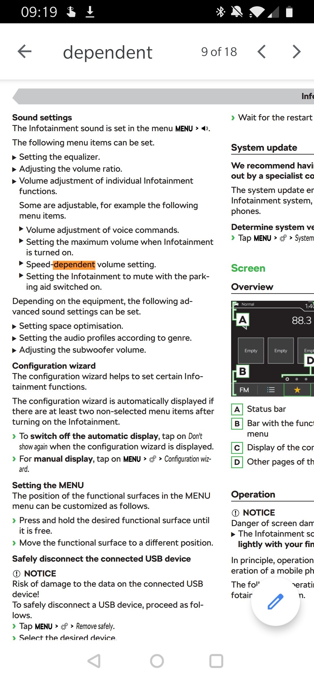

I took the short extract from the Bolero section of the Scala Owners Manual. I've pasted a screenshot which may help. Looks like page 75.
This is getting weird.  I’d been trying to match your suggestion with the A05_Scala_OwnersManual.pdf, and after stating “The Infotainment sound is set in the menu Menu - 🔈.” it jumps straight to “Configuration wizard”
But I see now our printed manual has the same content on pages 59-60 as you have uploaded.  However, the entries I see on the Bolero's screen are restricted to:
Announcements
Maximum switch-on volume
Volume adjustment
Bluetooth audio
Entertainment fading while parking
Entertainment fading (navigation)
I moved “Volume adjustment” up to its maximum setting of 7, but I don’t think it makes the radio relatively louder at speed.  I assume it’s what the manual refers to as “Volume adjustment of voice commands”.
