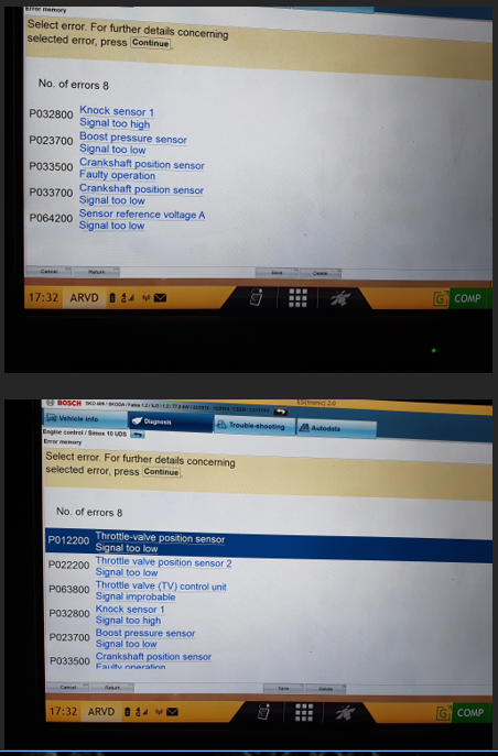

my first problem was i could smell oil witch was  the breather valve so i had it replaced. then two days later i went to the shop in my car and it cut out and wouldn't start with the epc light beaning on. so the car went to the garage and i was told it was a fault crankshaft sensor. it was replaced and i was back on the road but only for a few weeks as broke down again and had to get recovered. the aa scanned my car

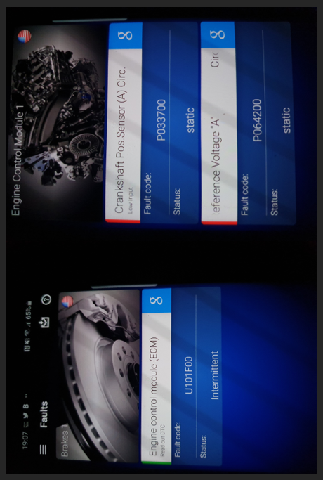

i went back to the garage and was told it was the throttle body so had it replaced then a week later the same again. i have used my friends obdeleven and now it says (sorry for the sideways pictures)
If anyone has any help on the subject it would be much appreciated

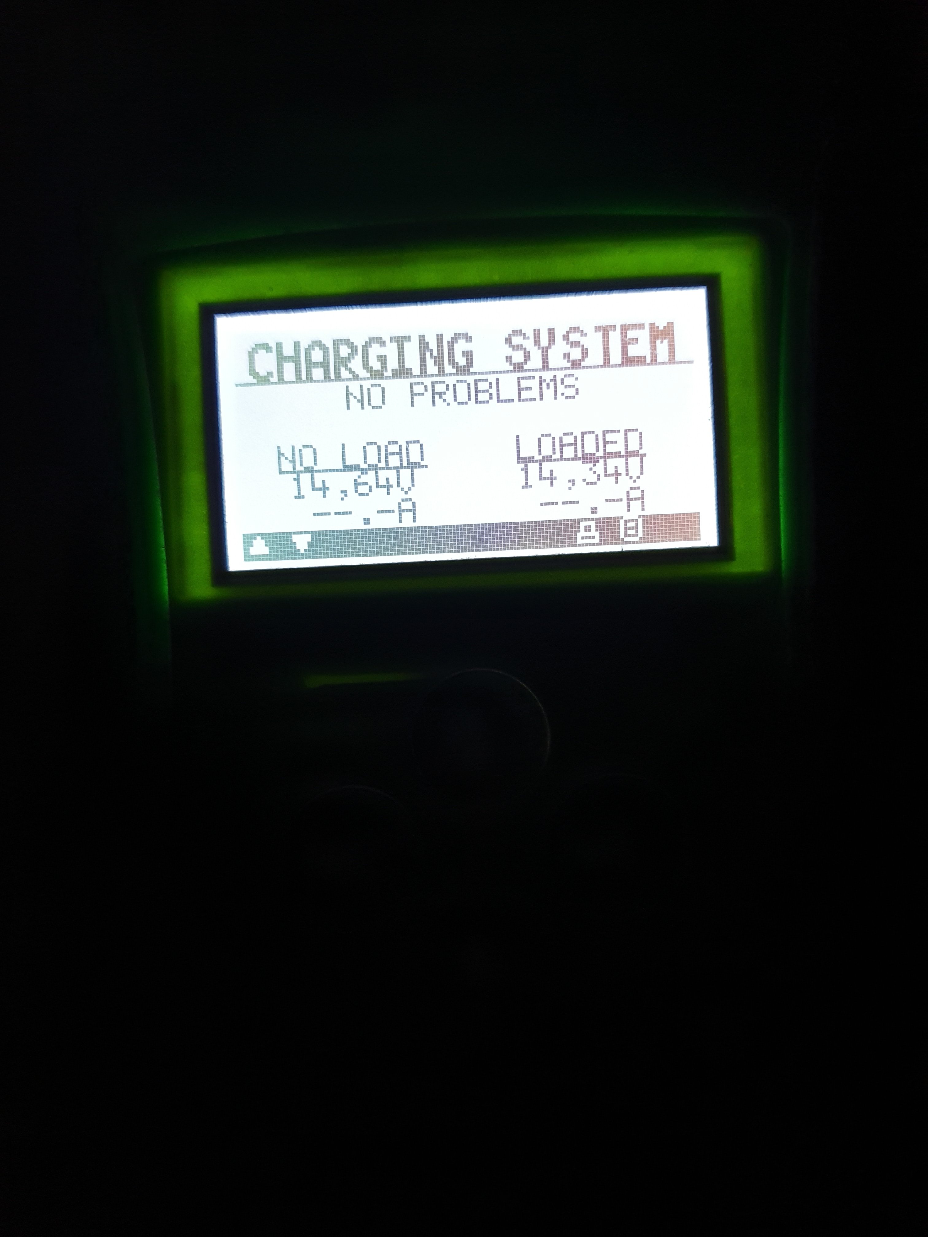

Check the battery and charging system is good.

@UrbanPanzer Thanks for the reply i will test the battery on Monday
@UrbanPanzer went to test my battery and alt and the car startd :) everything seems fine. forgot to take a picture of the battery test but it says it's fine. I'm happy the car started but would have liked to know it was fixed
