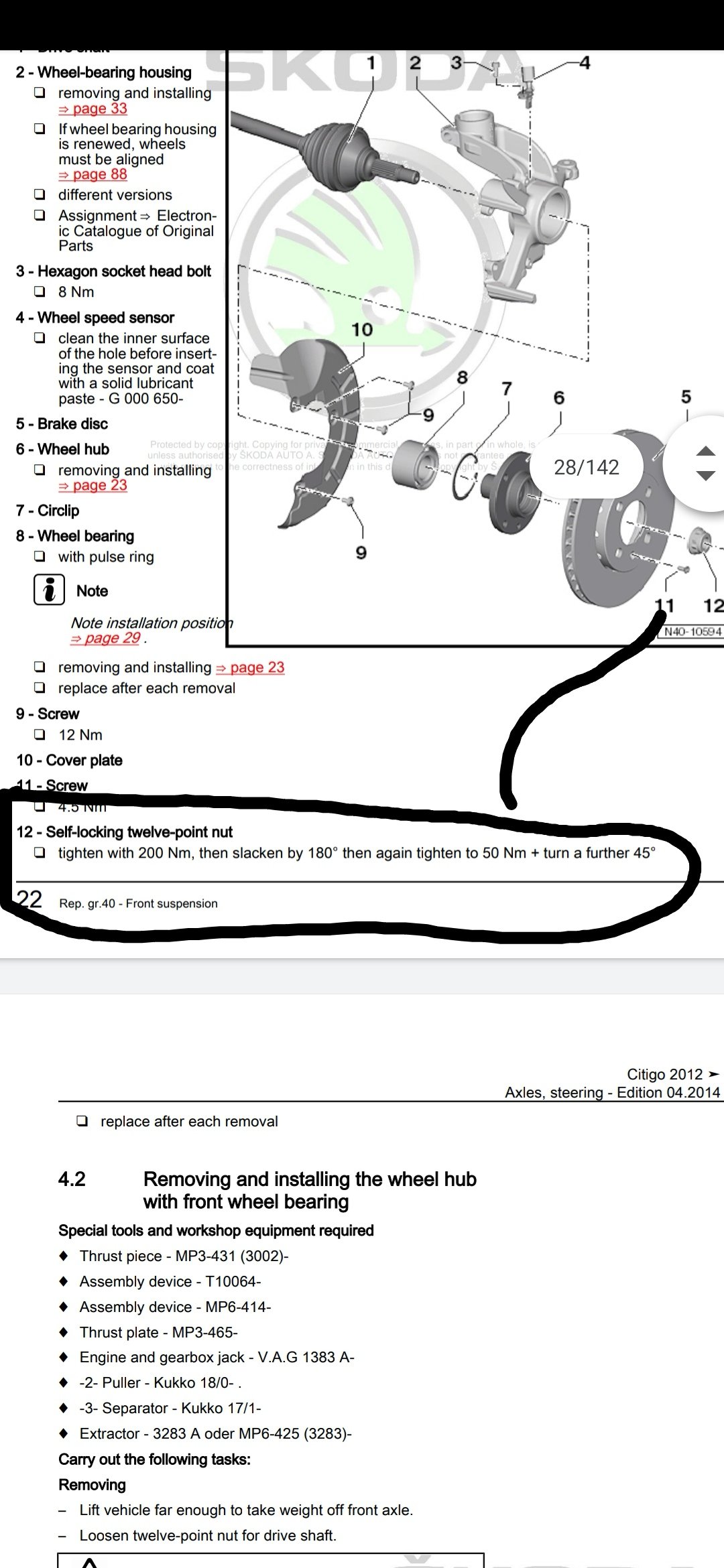

Front Axle wheel nut torque
Hi, does anyone know the torque for citigo front wheel axle nut?  Need to check if loose or wheel bearing needs replacing, was only replaced 4 months ago so hope its loose nut. Thanks in advance.
