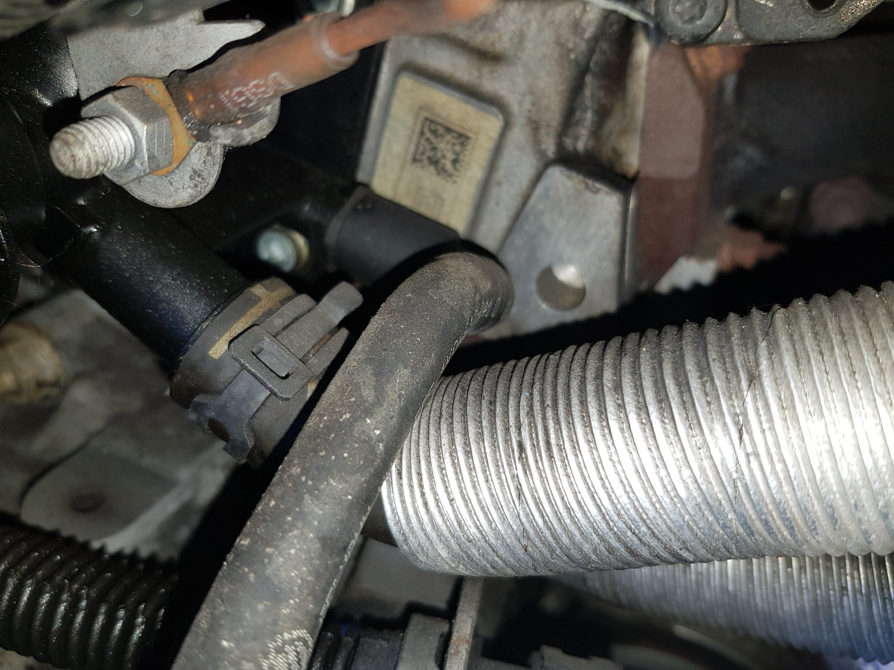

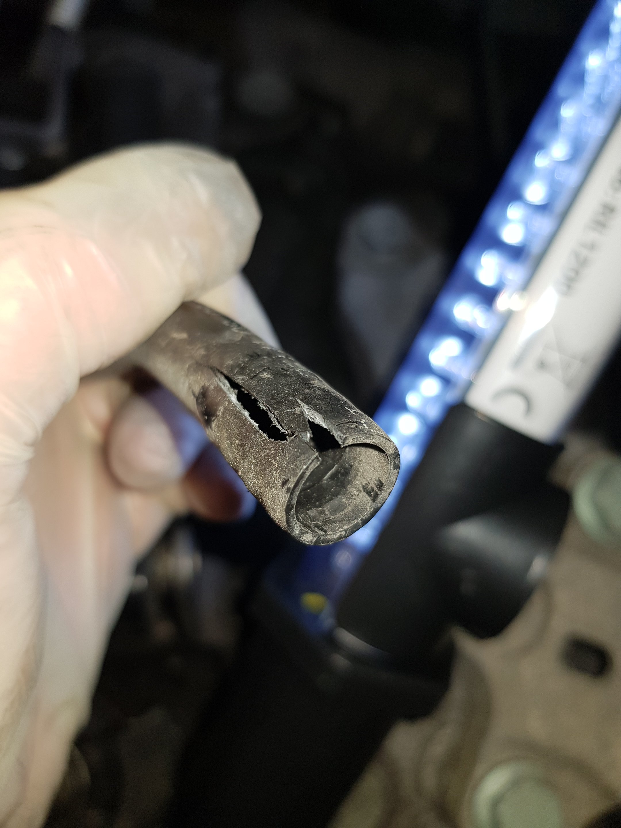

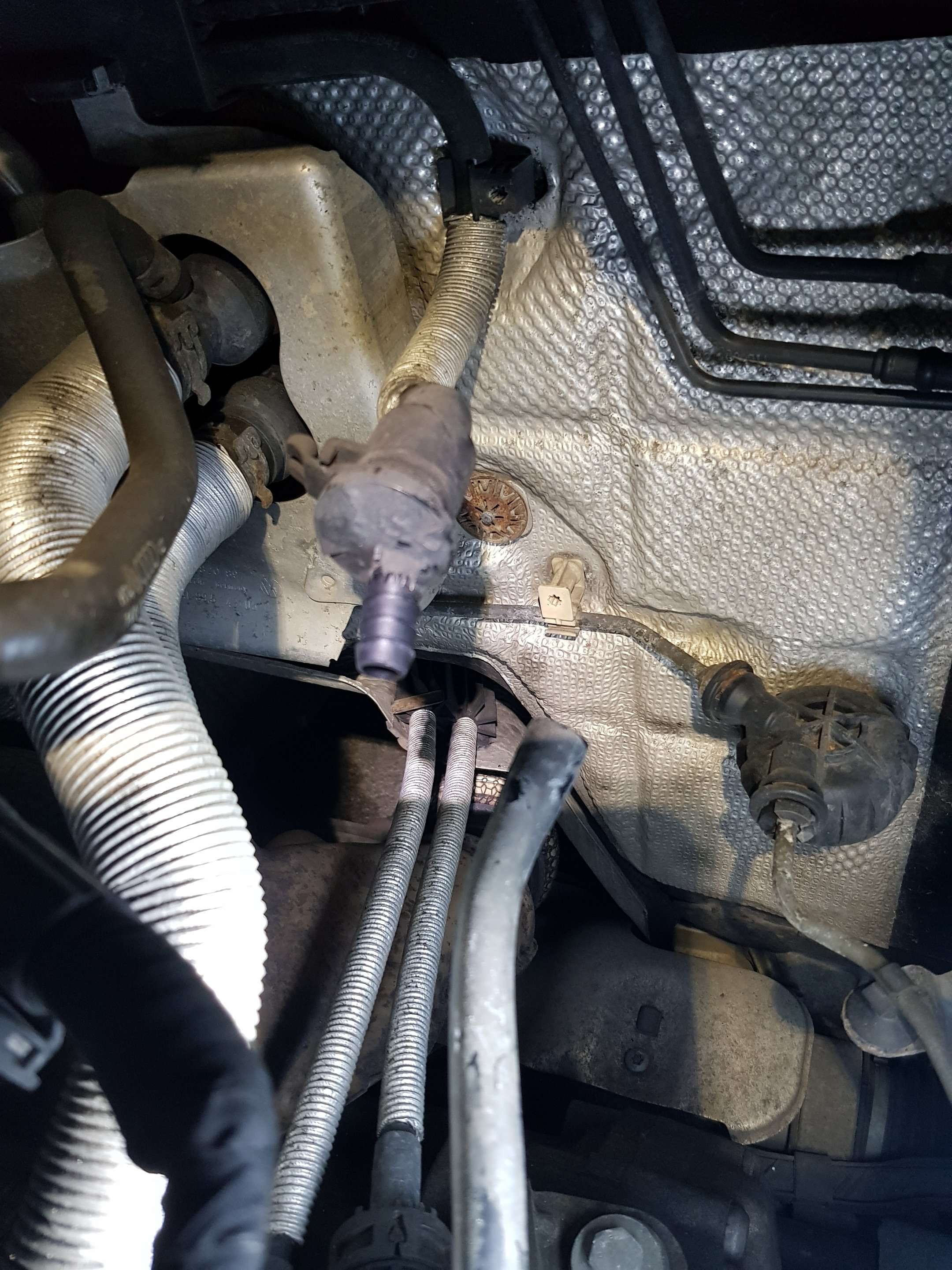

Well well WELL!!
I got itchy feet so went outside with my head torch and work light to start taking the Ramair off to inspect!
And I FOUND it!!! 👏👏👏 bloody pipe come undone under the new intake piping/heatshield so couldn't see it! 🙂
Going to have to get a new one from the dealer it's a funny one. Does this lead to the servo? Then onto what?
Bodged it for now so I can get the intake fitted again and get back on the road 🙏
Result!
