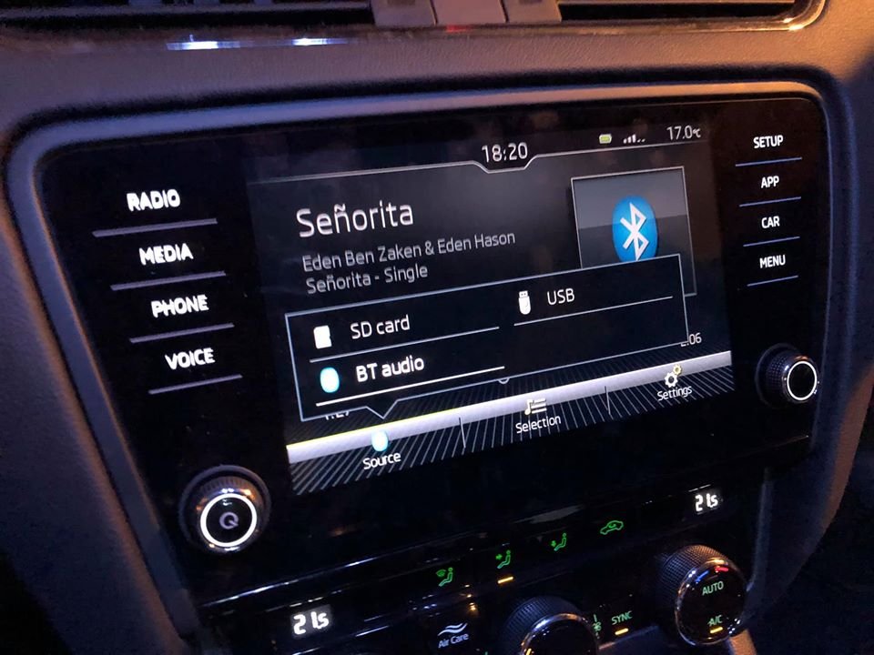

How do i turn on / enable AUX  function via OBDELeven ?

I just installed android box and the audio is going by aux, so i needed this option :)
Thanks Sasha !!!
Worked :)
