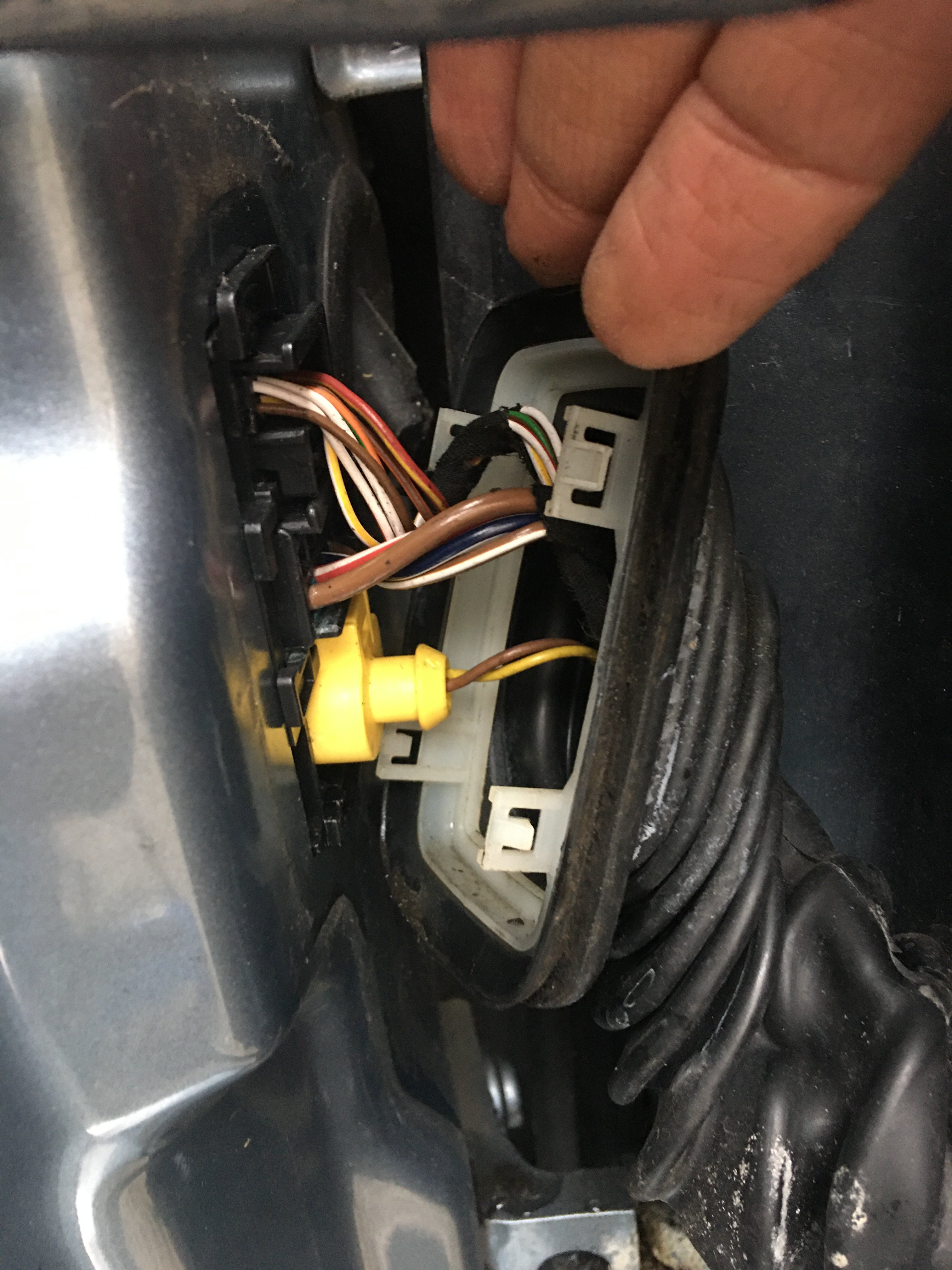

S57-0165
I had a quick look yesterday morning to see how difficult it was to get the door rubber from it off. It was straight forward.
however do any of you have a service manual of some type that helps identify what each of the wires/plugs are?
Those wires look intact to me?
It is usually pretty obvious when the wires are the issue.
