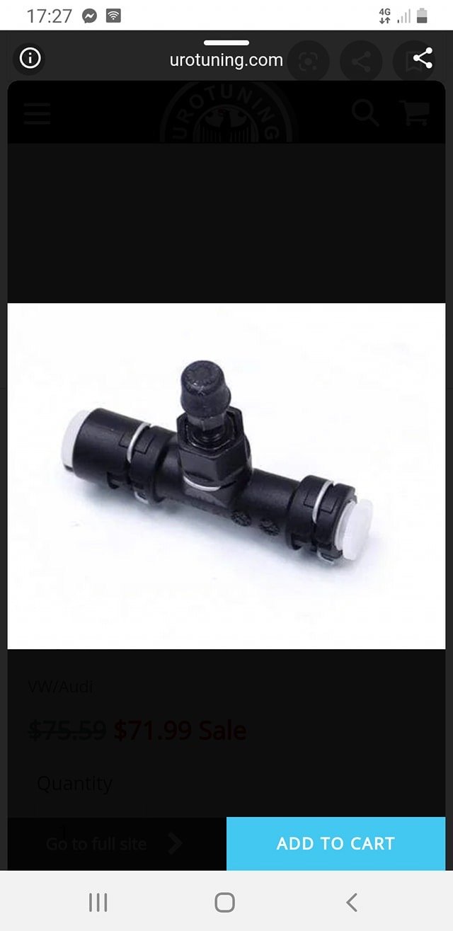

U think I’m better off replacing the bleed valve shouldn’t pop off like that if nothin wrong with it. The valve in the pic
I wonder why it popped off. Maybe the plastic is broken? If it was me I'd be buying that new part above.
I’m thinking the same because if the slave cylinder actually popped it would be coming out of the bottom of the Gearbox but is coming out off that joint and the piped when it popped
Took the bleed valve off this morning and as I expected the silver clip for the pipe has broke so will phone TPS or Skoda tomorrow see how much the damage is
