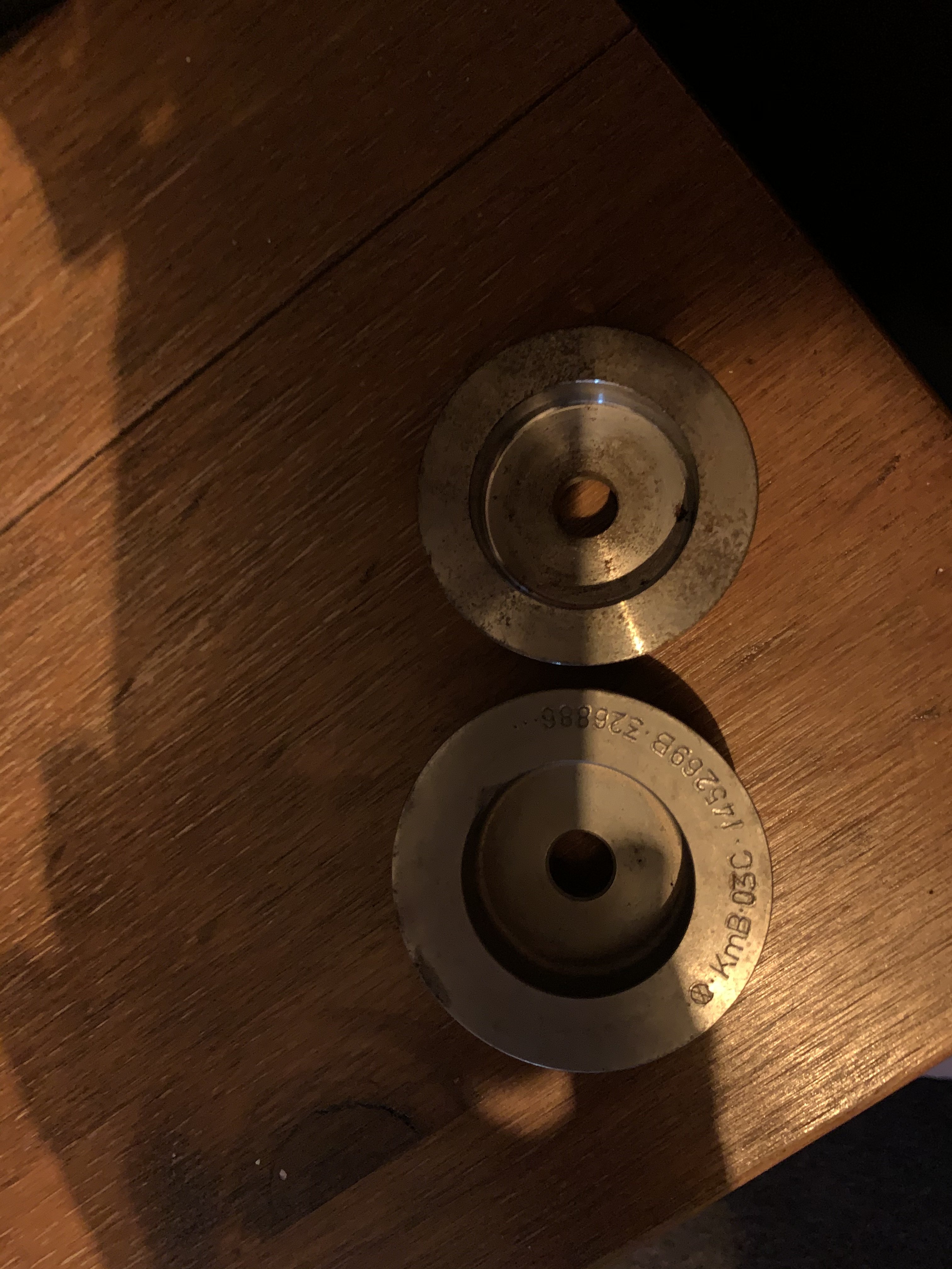

Surely a 10% reduction in supercharger pulley would give you a gain of some sort ?
I seen you mentioned it in your build But I've never seen the option of a reduced supercharger pulley? I didn't think it was possible as it was a unique Eaton M24 charger VW produced, Rather than the usual M45 and from my thinking a smaller pulley would require a smaller belt?
I’ve still got the smaller pulley mate it’s just a massive job to do so haven’t got round to it , the belt is on a tensioner so the original belt will still work , as you can see there’s a comparison side by side original vs 10% reduction 83BA2622-2837-44FC-8136-DB917C907525.thumb.jpeg.1af2862e9f9666b90b5f0ca7bbd0c717.jpeg
Nice one mate, It’s such a small pulley in the first place as you’ll have noticed.Did you have that made?
If you went balls out you could fit a twin screw charger (would be some effort) or just get rid of the charger completely, I’m sure RTMG’s drag cars have deleted the supercharger.
Yea I got a prototype made mate as if the gains are good I’m going to start selling it as a kit with the tensioning tool , so when people’s water pumps fail they can do the change at the same time , I think the way to go balls out on this engine is to be forward thinking and go electronic Assisted supercharger , electronic assisted turbo then it really would be instant power
Sounds good mate, I read the charger can run to 14 psi , 12 psi hits about 250 degrees , Gets hot down there so my only worry would be heat issues.
Or do as Ruff has above and go full out :laugh:
Ive followed his build and his friend Volkan’s for a while now and they guys have blew it out the water with these engines, Some the builds coming of Turkey/Greece are insane to what we have, I don’t think there’s any twincharged 1.4 tsi’s in the U.K. over 400bhp?
