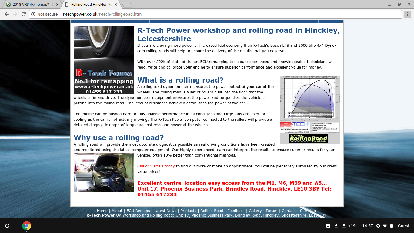

1 hour ago, KenONeill said:
So you already positively know they have 4-wheel rollers or you'd not even think about using them?
To be fair thats a good point, I am not sure if its a 4 wheel roller so I will need to check with them as I won’t get a map (and they won’t do one i dont believe) without the before and after.
You used them before.  Surely you would not trust someone that would just be interested in taking your money.
As it is you void the Manufacturers Warranty, it is your cash money risk, you go with the Reliable Tuner, especially with a Custom Map.
Do they not show in their Webpage or Advert what they have?
EDIT. They do.
http://r-techpower.co.uk
220 output would be about right I think. The 184 puts out similar after a decent map. £350 is a good price provided it's a genuine custom map and I would doubt it includes dsg changes at that price. If they have the 4 wheel rollers and the ability to to tweak the dsg then ask what they would charge to do both. If you look around online the dsg maps are not cheap. Many are the same cost of ECU mapping so make sure you know what you are getting and that you need it first.
