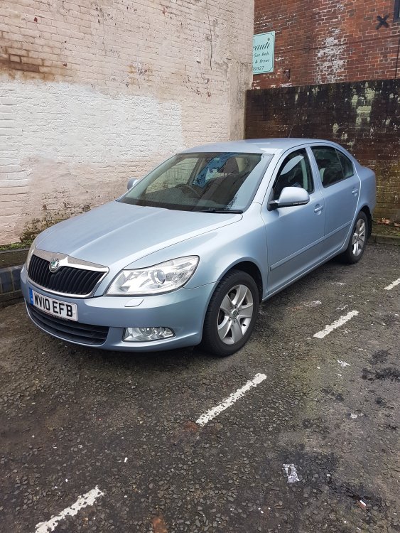

Hello. I'm after some advice on a recently purchased 2010 Octavia 1.8tsi Elegance.
Just before Christmas I was t-boned at on a roundabout and my VW Jetta was written off. I needed a car in a hurry and didn't do my normal research before jumping on the Octavia. It seemed to tick all the boxes...
However, and I'm sure you all know what's coming, it uses a lot of oil and there is white vapour from the exhaust even at normal operating temperature. All bad signs.
As said it's a 2010 with 74,000 miles and is immaculate. It's starts just fine with no rattles and is very quiet and smooth. Over all I really like it.
I have recently moved house and eliminated a longish commute to the stage that my annual mileage is so low so I'm almost decided to keep the car for a few years. It will take me years to get to 100,000 miles.
Also I should mention that it was a private sale.15782207450693964276758700926942.thumb.jpg.e2b7076ff9e85b8d42a54df259758c82.jpg

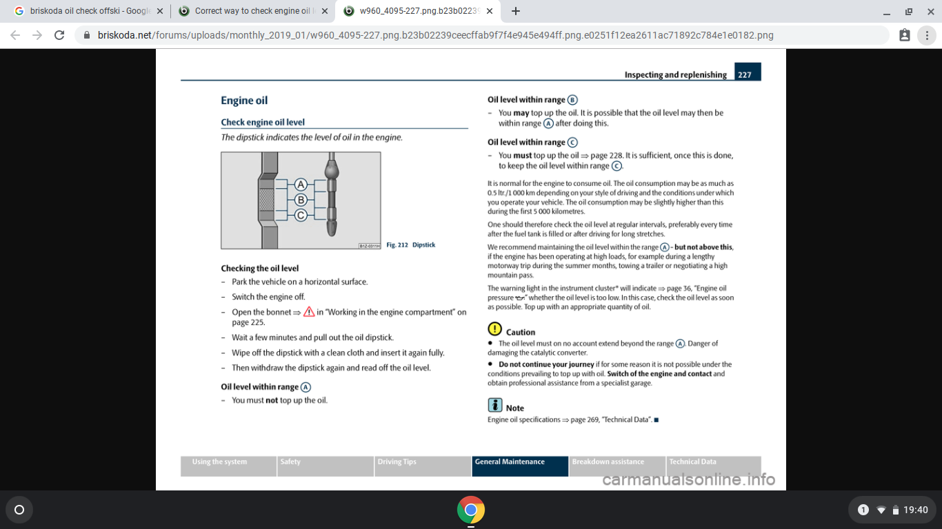

It has never been 1litre in 1,000 km that was an accepted figure, threshold or within tolerances..
Someone would need to find that in any VW Manual or Official documentation.
It was 'Oil consumption may be slightly higher in the first 5,000 km',
and May use as much as 0.5 litres in 1,000 km. (621 miles) under certain conditions, etc etc,  that is not pottering about at UK temperatures on UK roads..
They have had the same for Petrol or Diesel Engines from 44kW up, & 3,4,5,6,8,12 for many many years.
And that 0.5 litres was nonsense as VW well knew was nonsense and when in Warranty after Official Oil Consumption Tests Skoda / VW have replaced oil burners using 0.3 litres in 1,000 km.

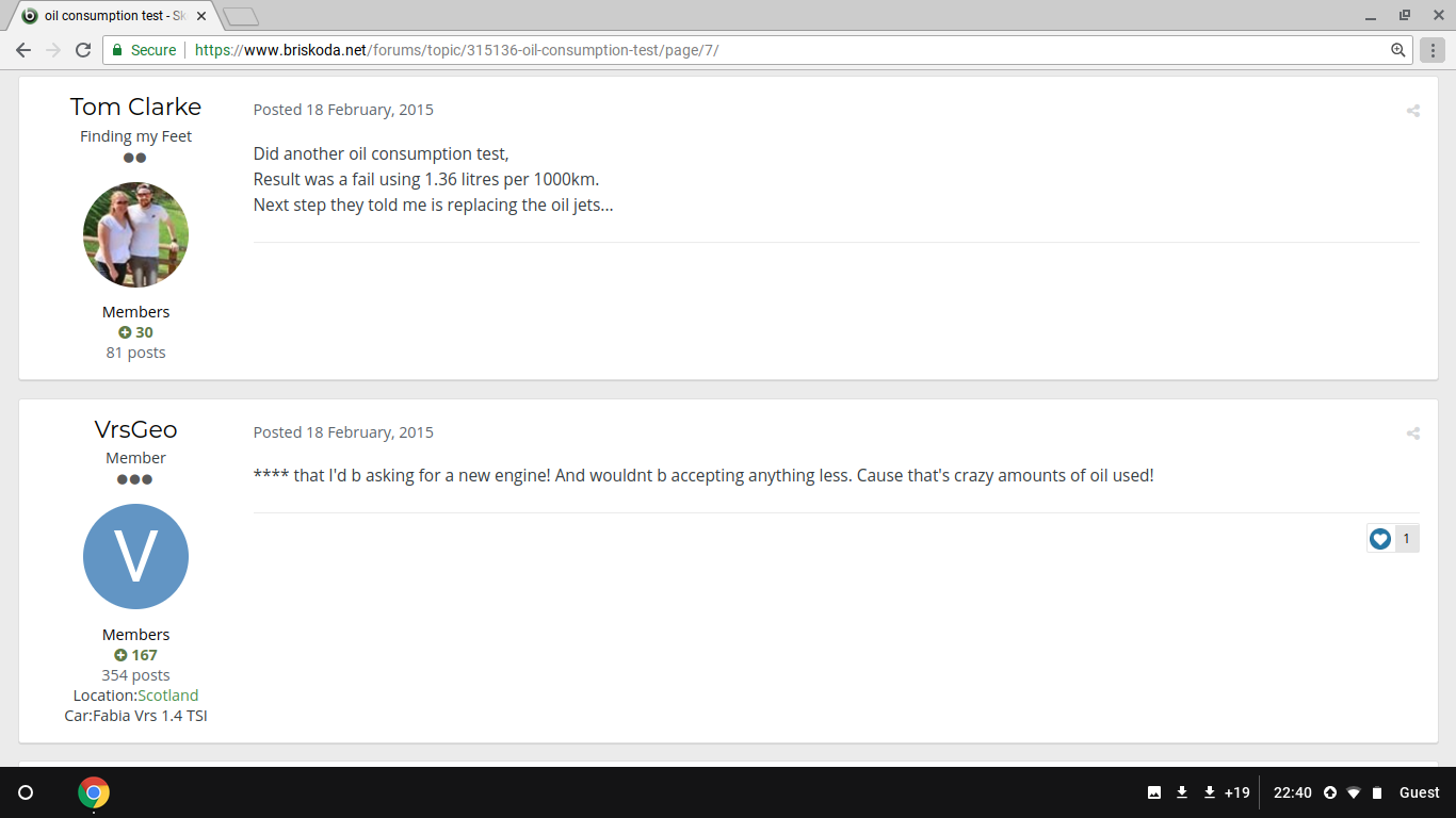

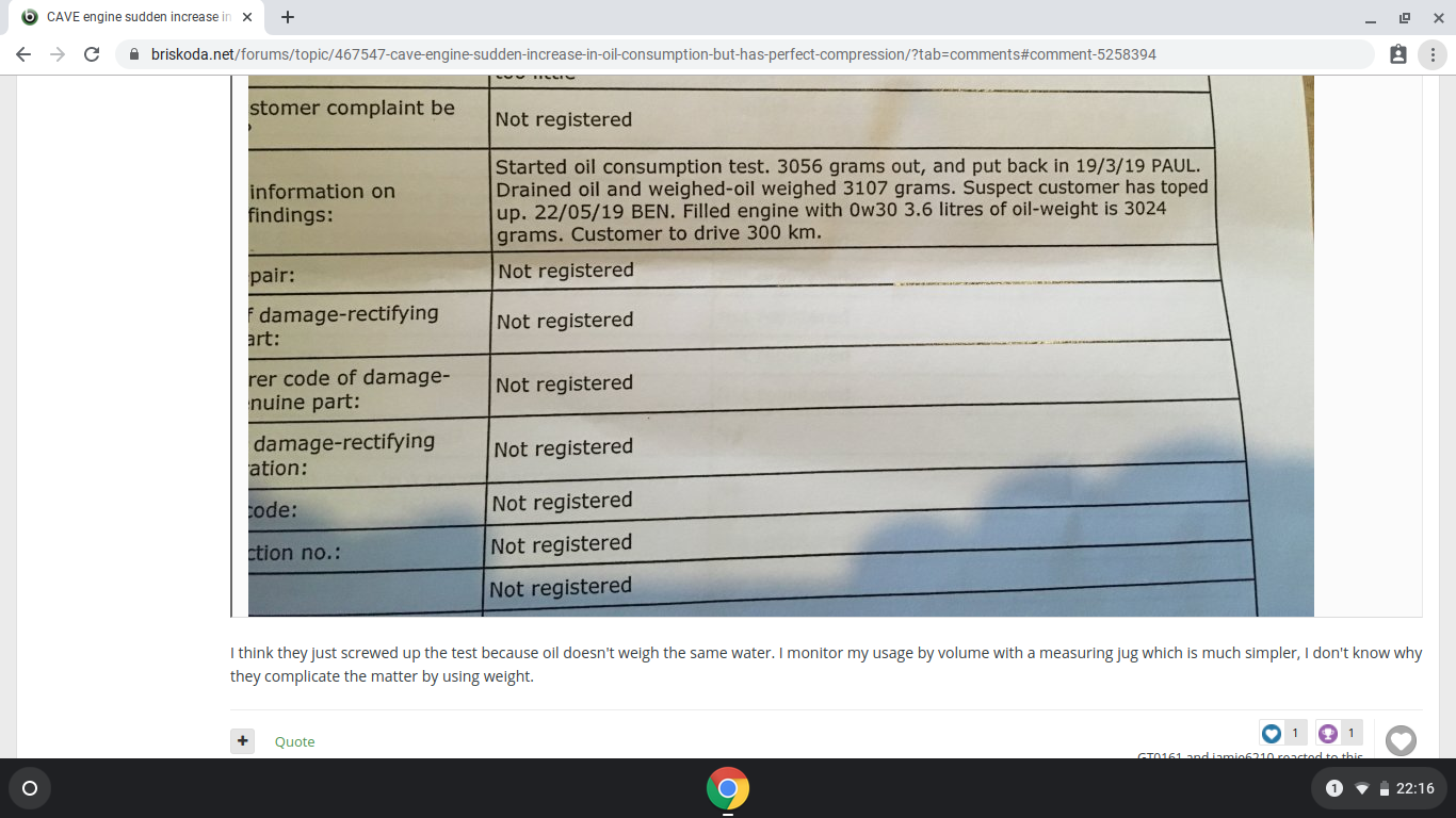

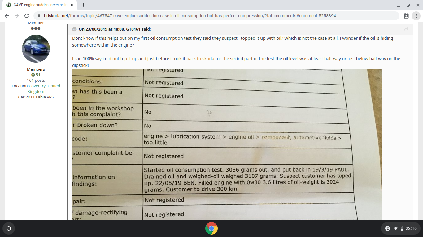

What some idiots like the one that did this test below do is not know the weight of 1 litre of oil.
This first ones car owner got a new engine in the car.  Just as many others have that had a car use less than 0.5 litres in 1,000 km.
2nd & 3rd example a Technician and Dealership taking the pith.
 4th, the weight of oil and the Old Dynamic Oil Consumption test.   Again 0.5 litres in 1,000 km was considered and treated as excessive oil use.

You mention the first document post shows you the idiots do not know the weight of 1 litre of oil.  To me is appears that they do.:
76 grams of oil in 300km.  That is 253.33 grams in 1000km.  Specific gravity of multigrade engine oil about 840gm / litre.  253/840 = 0.30L per 1000km.  Same as their report.
