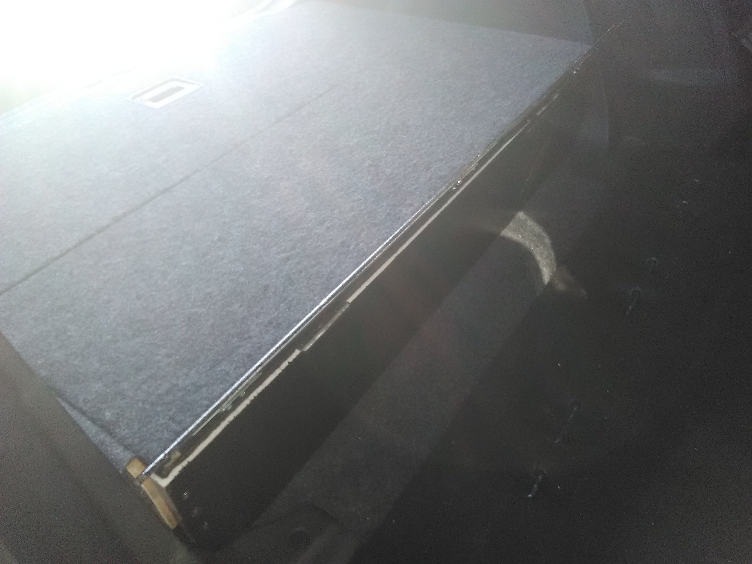

Photos as promised.

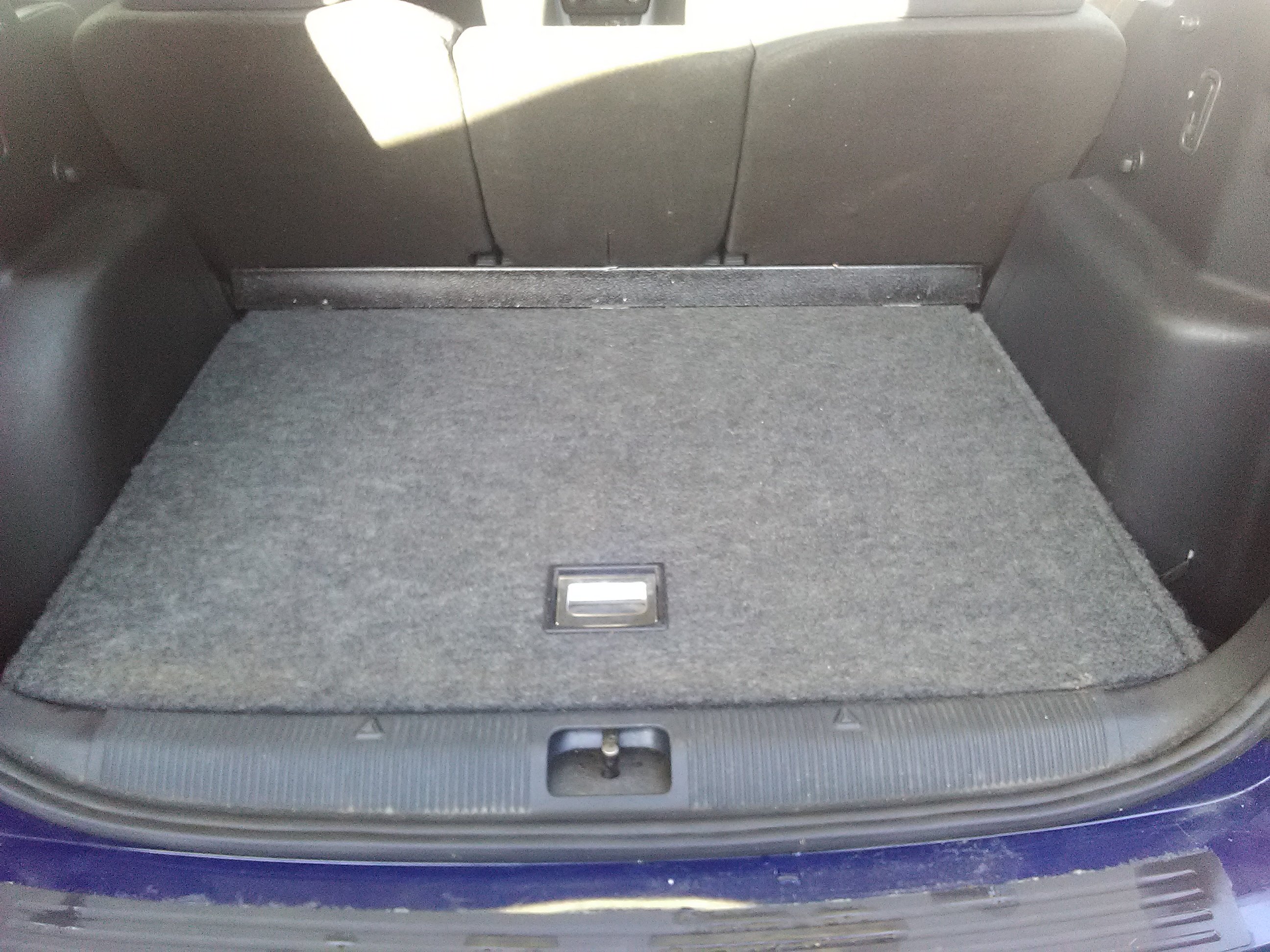

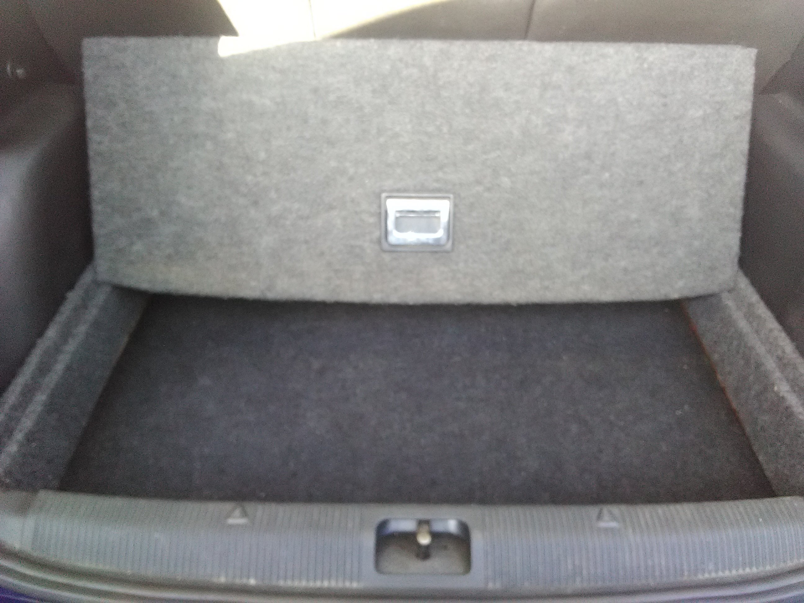

Its an inch or so higher than the stock one from looking at the other photos, hinged at the front and has the fabric hinge on the top not bottom so opens in a different way. The seats have to be tilted forwards for the opened section to go into the slot for the Octavia but as can be seen from the first photo it stands up on its own. The gap closing flap is hinged from the variofloor.
If I did it again I would not hinge the floor, I would cut it back a further 20mm and raise the front bulkhead up flush with the top edge, it would stay in place and could be lifted out for taller luggage but would be a potential hazard in a roll over so I would use the Octavia Dzus fixings.

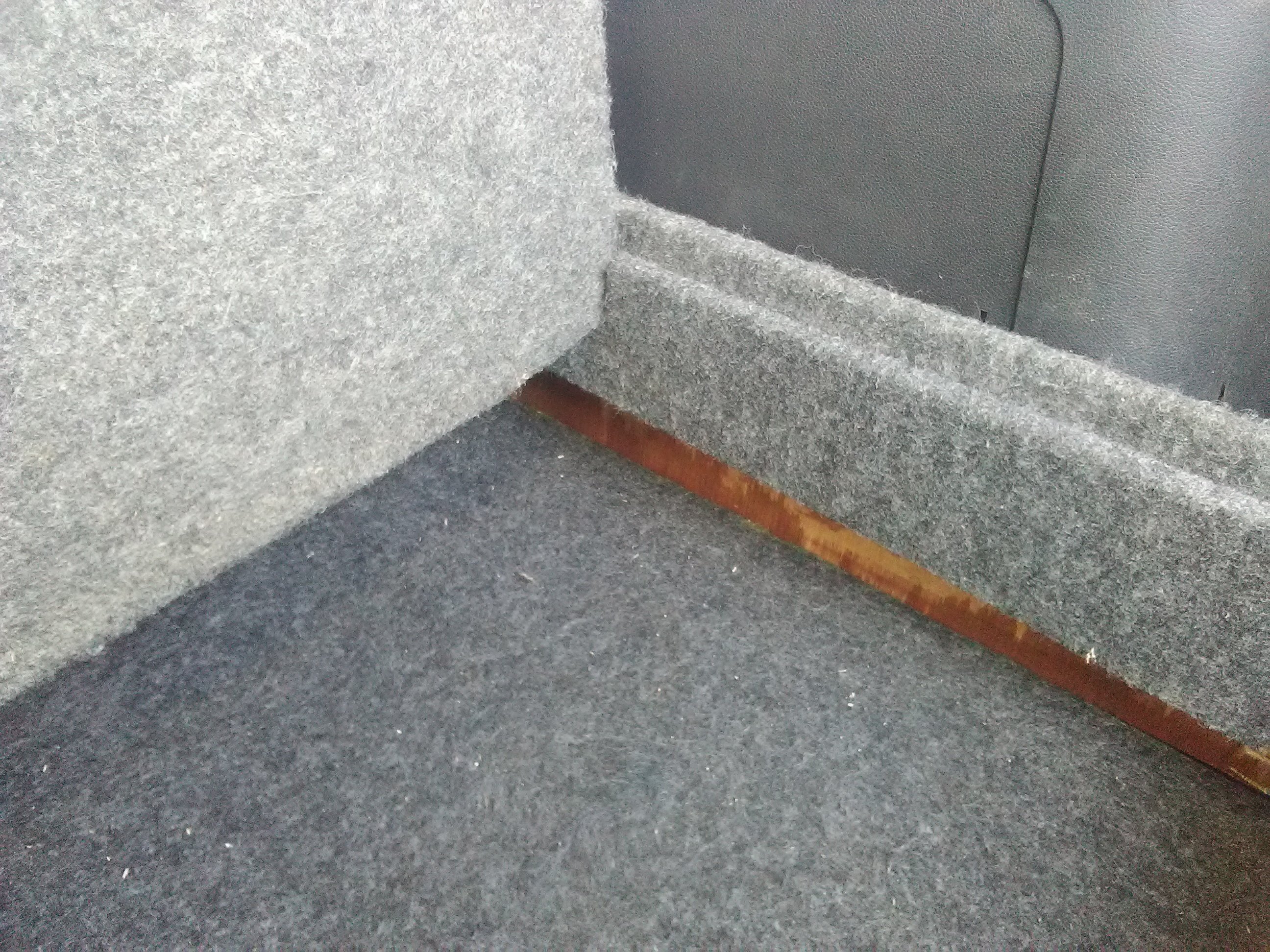

A very satisfying and cheap conversion as there are loads of MK1's in the breakers, mostly estates with variofloors and being so old there are very few takers for them, they are the exact width and correct rear profile for the Yeti, they simply need cutting down together with the side rails and some 6mm ply side extensions made which can just be seen in photo 3

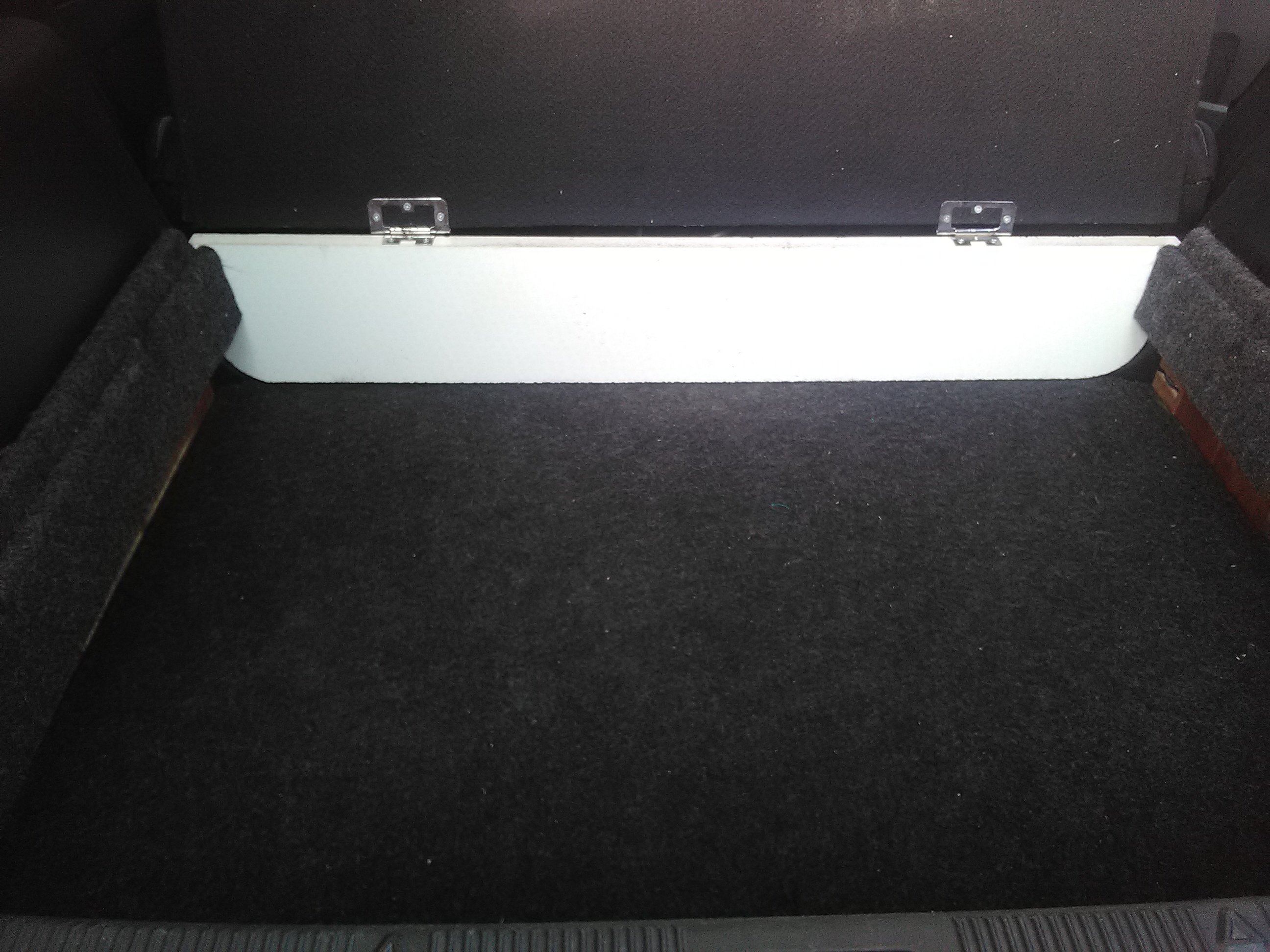

As can be seen from the last photo the visible side of the bulkhead and gap closing flap I finished in a textured black to match the carpet & trim, there is precisely enough space to get your hand down behind the seat to release the tilt mechanism and the parcel shelf still can be slid down behind the seats.
