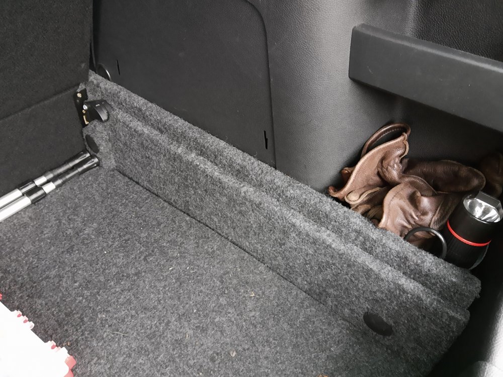

Photos of factory fitted variable boot floor.
The first is the floor in top position.
Second shows the side piece on which floor fits. The variable floor can be completely removed by unclipping the black clip you can see at the end of the floor (one each side).
Third shows floor folded back and you can see the wall at back of floor to prevent things falling into gap. The whole floor can be folded up to gain max space.
If you slide the seats forward there will be a gap between seats and false floor but generally if you are doing that you would have removed the floor anyway.
Hope this helps.

Is that a lift out basket where your gloves and torch are?
Fitting the variofloor gives a nice little compartment each side like the Octavia has, mine is full of ratchet straps and twoing stuff, I think I will fit a cross piece like you have or even make some lift out door panels to make use of all the height like in the Octavia, I will see if those ones could be cannibalised, even butchered OE bits look better than DIY ones most of the time.

No not a lift out basket, there are two shelves each side - one where gloves and torch is plus another above it empty. Useful for bits and pieces. Incidentally the sealant gunge and electric tyre pump fit in a recess under the bottom of the boot floor that you can see in photos 2 & 3. I generally have the boot floor folded  as in photo 3, that gives me max depth to hang shopping bags etc. from the hooks so preventing things moving around and I keep empty bags etc. under the folded floor (green bags in photo) and parcels/papers etc go on the top of the folded floor. Beauty of the variable floor is that with the variable floor folded up three roll-on luggage bags will stand upright one behind the other on the bottom of the boot. Without the variable floor you have to lie the cases down and so dramatically reduce available luggage space. I worked it out that by not having a spare wheel it increases luggage space by 33%. Calculation based on Skoda’s figures for available boot space with/without spare wheel.
